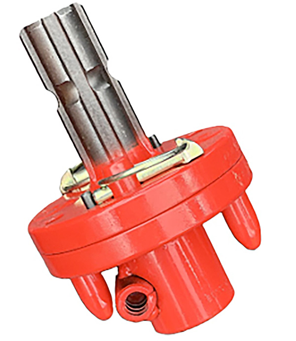

Has anyone used their PTO hook up ? I have a PTO Link but I still have issues with my B2601 since I have had hand surgery. This looks easier but wanted thoughts from a guy who used it. I just can’t turn that PTO link to lock it in.

Have you cleaned the PTO LINK of dirt and debris?

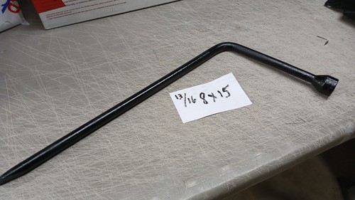

One of the handiest tools to have on a tractor is one of those old jack handles, 15" long with a bend and the straight end is tapered. Pain it red, white or orange so you don't lose it in the grass.

I have one of these in every tractors tool box I have. It helps a bunch to get the PTO shaft hooked up. As we get older it get tougher to get those shafts hooked up.

That same company (PTO LINK) also sells a wrench and a sling to help align and install the driveline shaft. The wrench is offset to reach back behind the tractor half of the coupler.
See these links

If you ever need a new one, Google “L type lug wrench”. They’re still popular somewhere.
