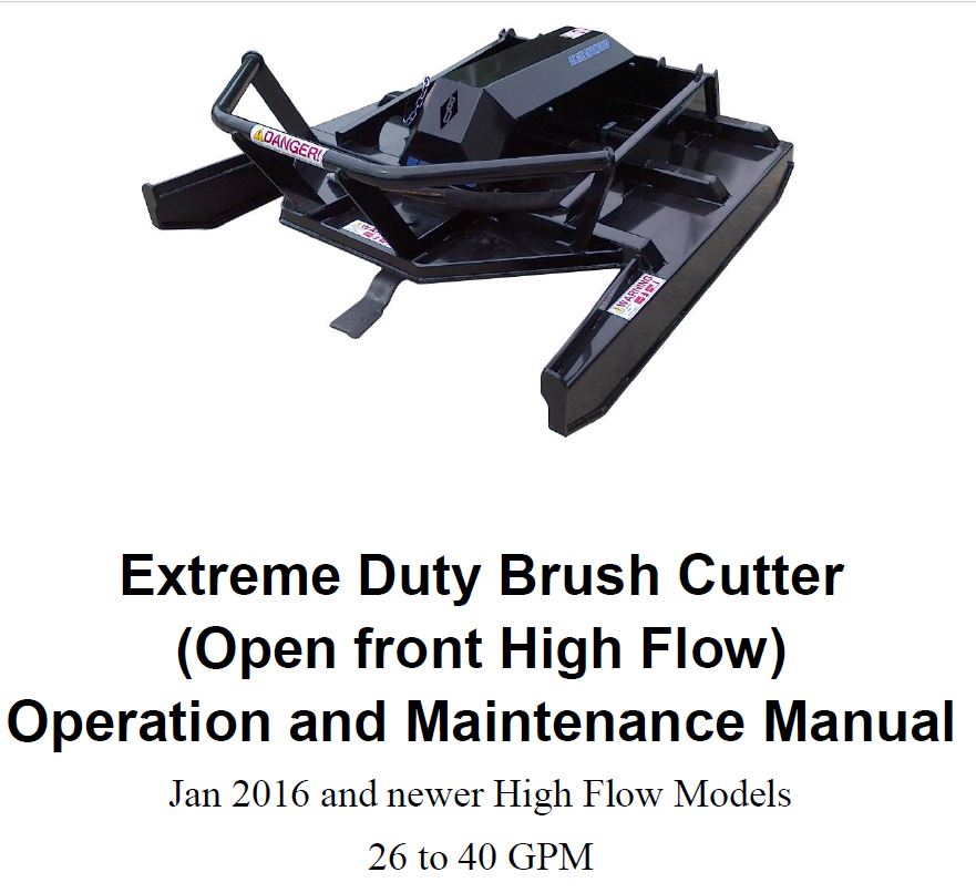

I own and run tractors and a track loader. I have several front cutting attachments for my track loader, my brush cutter is just under 1,600 lbs and runs at 30GPM on the hydraulics. Tractor FEL capability runs off real quick as you move away from the mounting pins or plate. I would not even consider my Kubota MX5800 as suitable to even move this cutter let alone try to run and handle it no matter what modifications you were thinking. Tractors and track loaders are very different machines!

Bingo.
