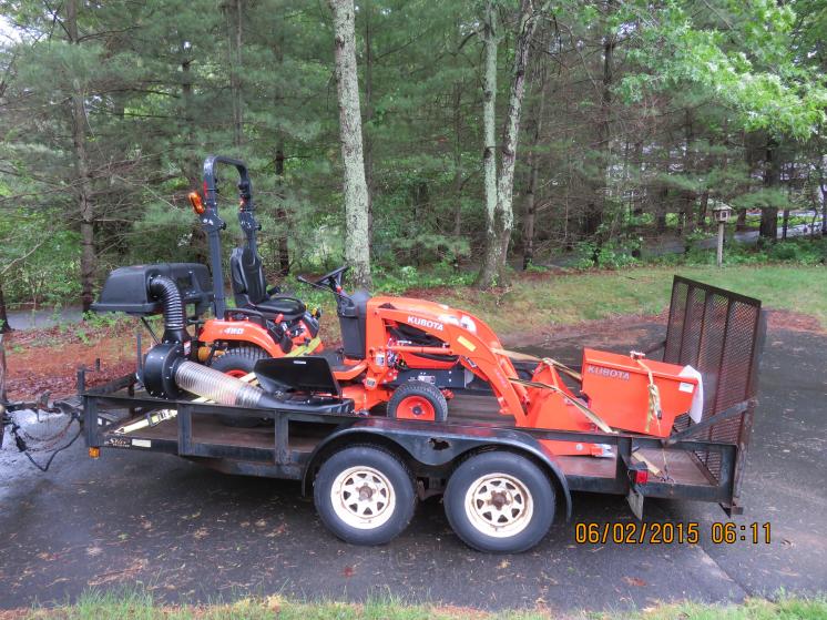

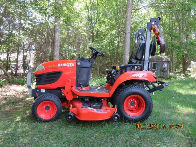

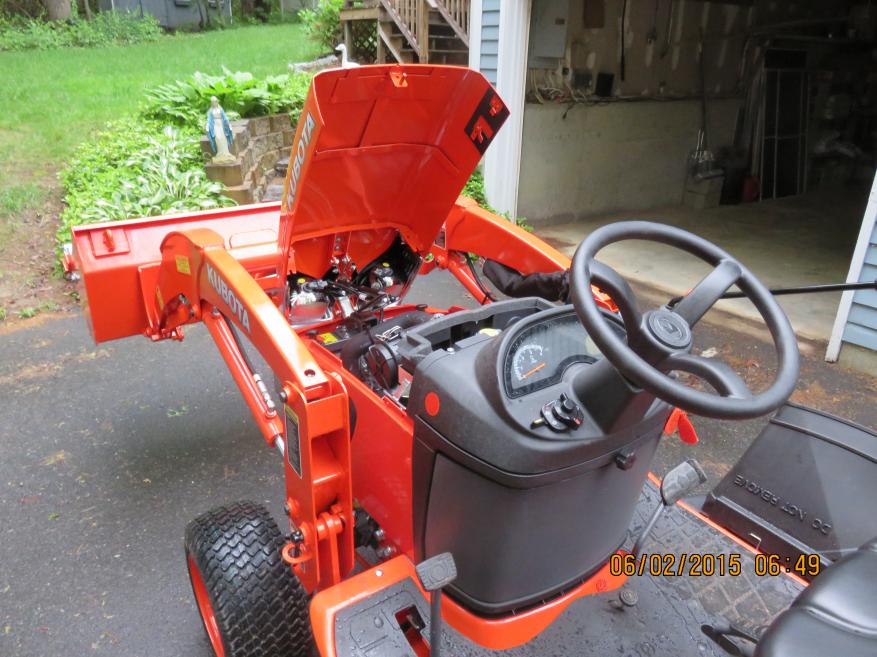

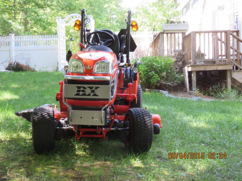

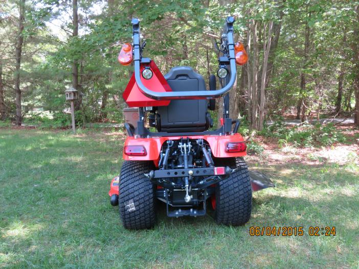

Thanks to everybody for your responses and advice. The tractor was delivered two nights ago and I’ve attached pics to show my new orange baby. This being my first genuine tractor, I’ve got a lot of learning to do. You can hopefully see from the photos that the tractor was delivered along with FEL, bagger, 54” mmm, ROPS and fender lights, and grill guard. I also got a block heater, and a front-mount snow blower has been reserved for pickup in October. Also, there’s a Piranha tooth bar on the FEL which figures to be useful (mandatory?) for some projects in the real near future.
Based on all of the comments, I’m gonna pass on the skid plate for now and limit excursions into the woods to dumping leaves in the fall and maybe trips to turn leaf and compost piles, while also relying on the additional protection offered by the mmm (thanks, I never even considered this). I still want to study the different commercial skid plates out there for the future, especially in light of comments like those from cerlawson and TripleR.
Skeets, I'm envious. Definitely got to acquire some of your DIY skills.
Thanks again to everybody for your very useful thoughts, and hope y’all enjoy the pics!
