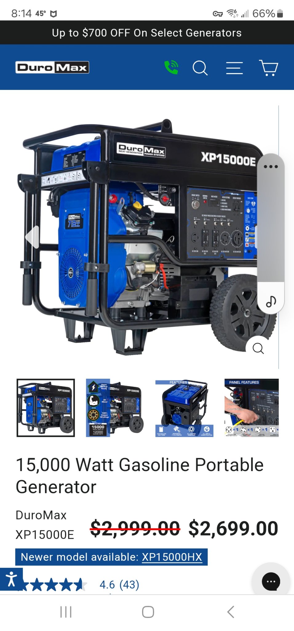

A few yrs back I bought a Duromax 15,000 that runs my house, welding shop, machinery ect. The only time it ever lugs is when a big air compresser starts.
