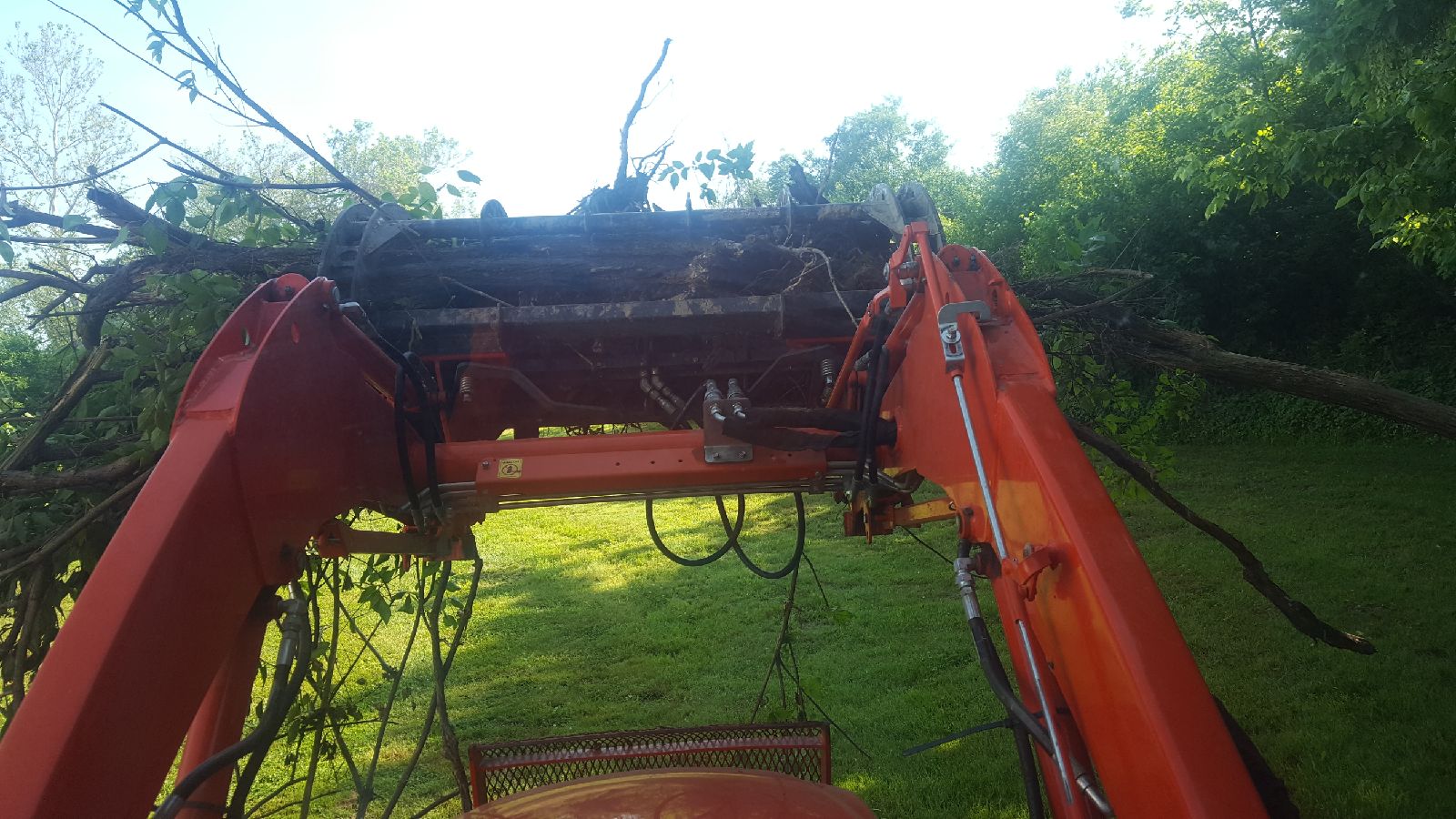

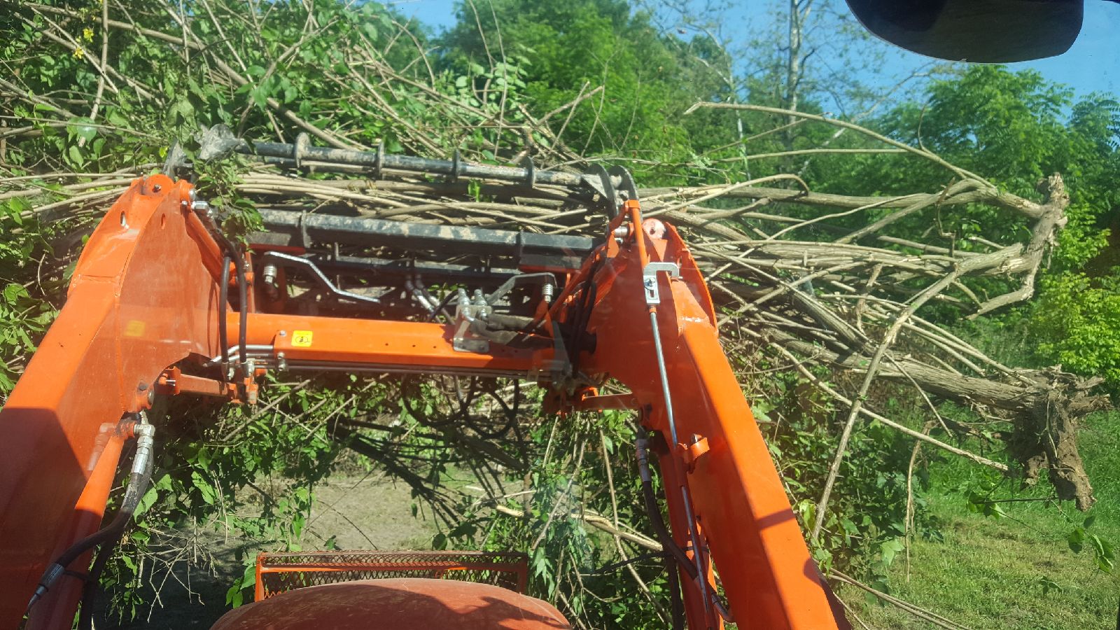

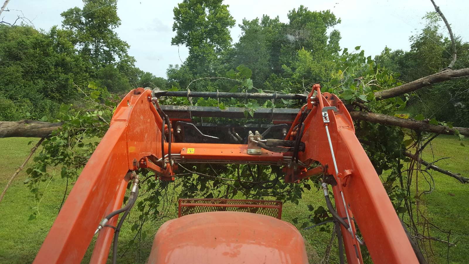

It sounds to me instead of modifying the bucket, you should be looking at a root grapple. Yet, that is a BIG cost.
The toothbar works well, but doesn't leave you with the best finish. As it was pointed out using a landscape rake and combining it with the toothbar would give you better results.
Now if money is no issue, I would say a root grapple that you can get the brush out with, haul it away, and back drag the area with the lid of the grapple.

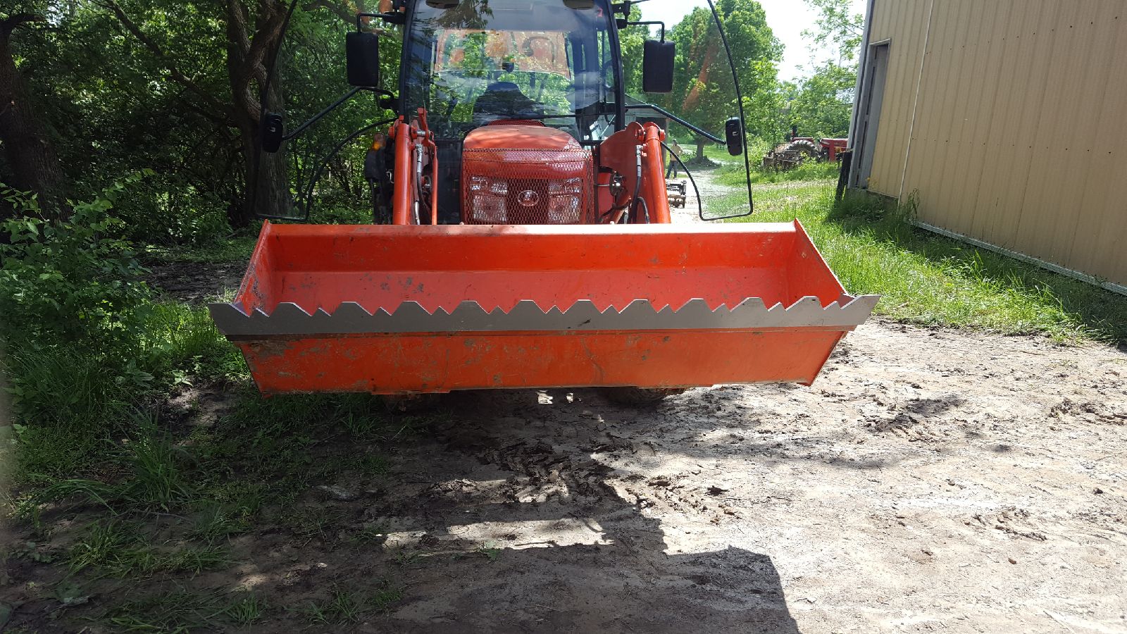

I have and love, love the pirhana tooth bar like in Bmyers last picture..
It digs well in our dirt, it keeps ware off the bucket edge when moving snow, it does take a learning curve to use for this job to learn not to tear up the driveway.... It works well to back scrape the slick ice on the drive and yard...
There may be other things that work better at specific jobs, but this does good enough for me on an everyday basis..
