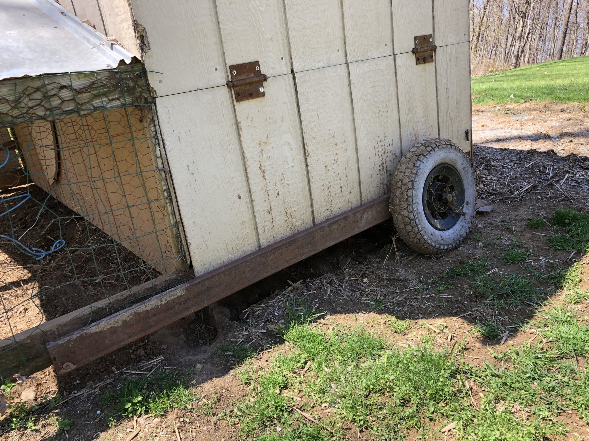

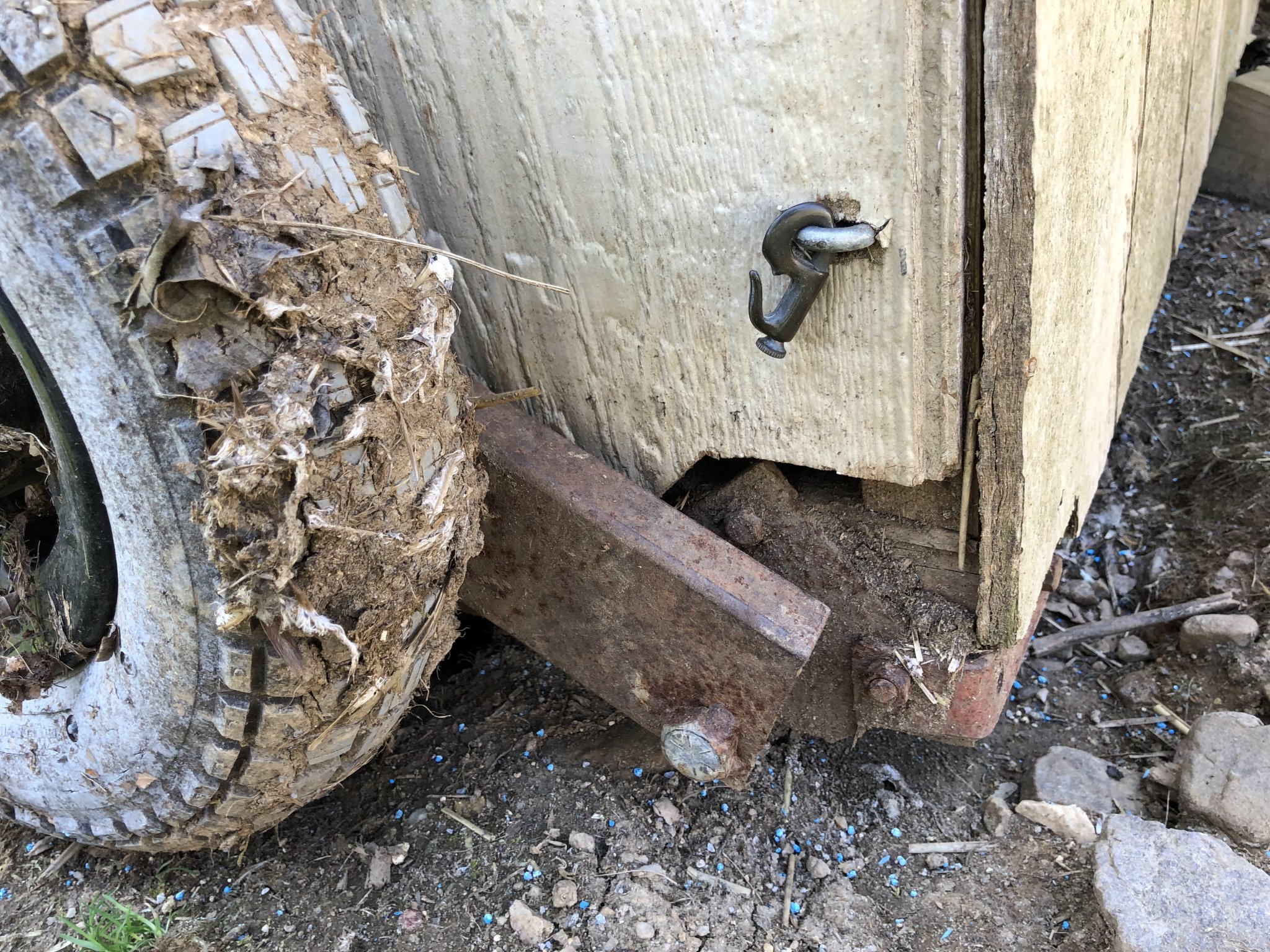

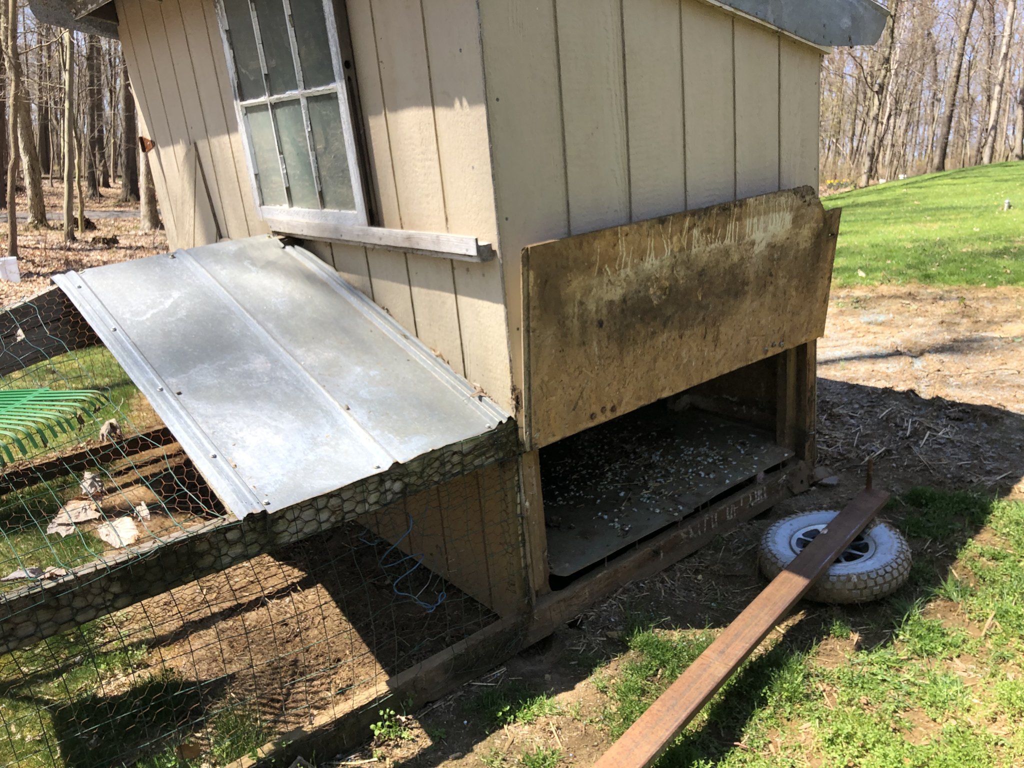

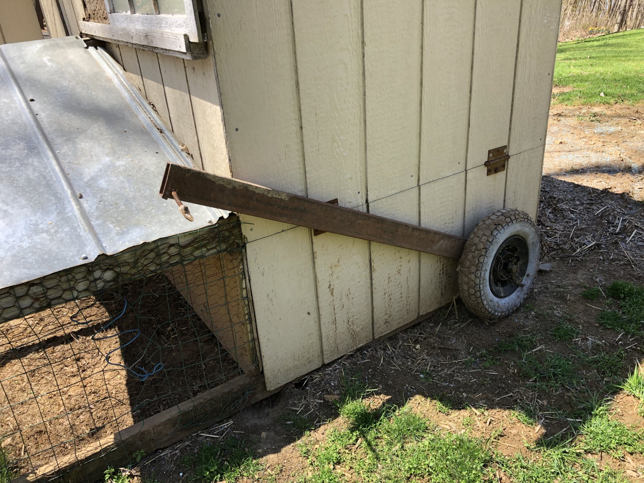

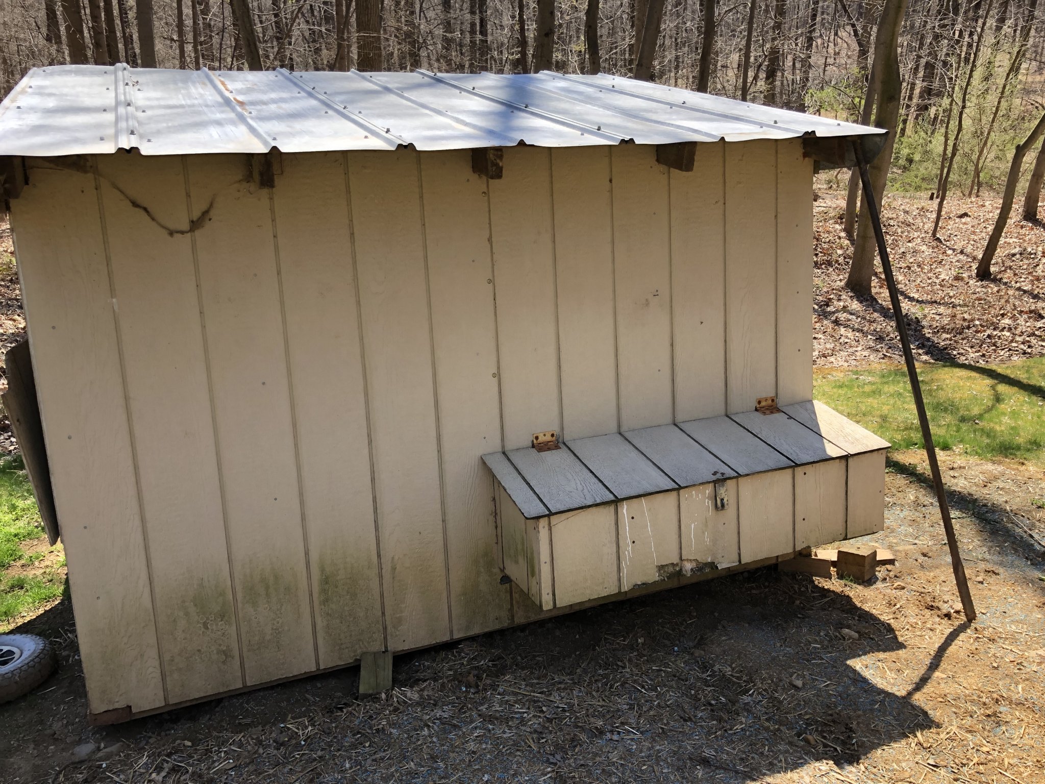

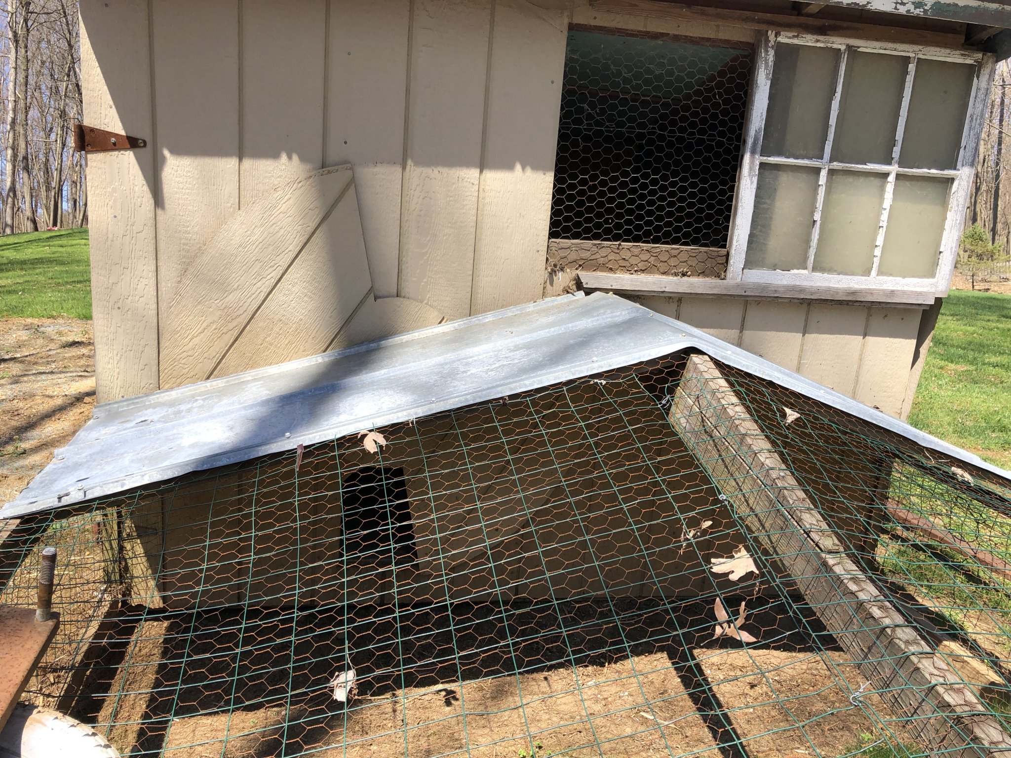

Here are a few pics of my chicken tractor:
i built it of used lumber and steel (for the roof). I paid $0.25/sheet for the roofing. The floor on the inside is repurposed semi-trailer lining (1/4" high-density polyethylene). Slick when wet, but easy to clean. The perches are just broomsticks. The siding is off-the-shelf stuff from Lowe's, and the most expensive (and heaviest) component. The main structural members are four horizontal 12-foot treated 2x4s, which can be seen framing the outside run. They run all the way to the corner posts at the back wall and are notched into them. The coop is plenty heavy. A guiding objective should be to minimize weight for a movable coop. Still, I can move mine without mechanical assistance, and I'm not a big guy.
Clean-out door
Nest boxes
Inside
Lift/move system: Ready
Lift/move systm: Lifted
Lift/move system: Detail IMG_0715.jpg IMG_0716.jpg IMG_0719.jpg IMG_0721.jpg IMG_0722.jpg IMG_0723.jpg IMG_0724.jpg
Reactions: 6 users

Hi Pigdoc,
nice job on the wheels! We had “chicken tractor” coops for many years and moving they about is key.

thanks. that's a pretty guide for me since i have essentially the same materials.

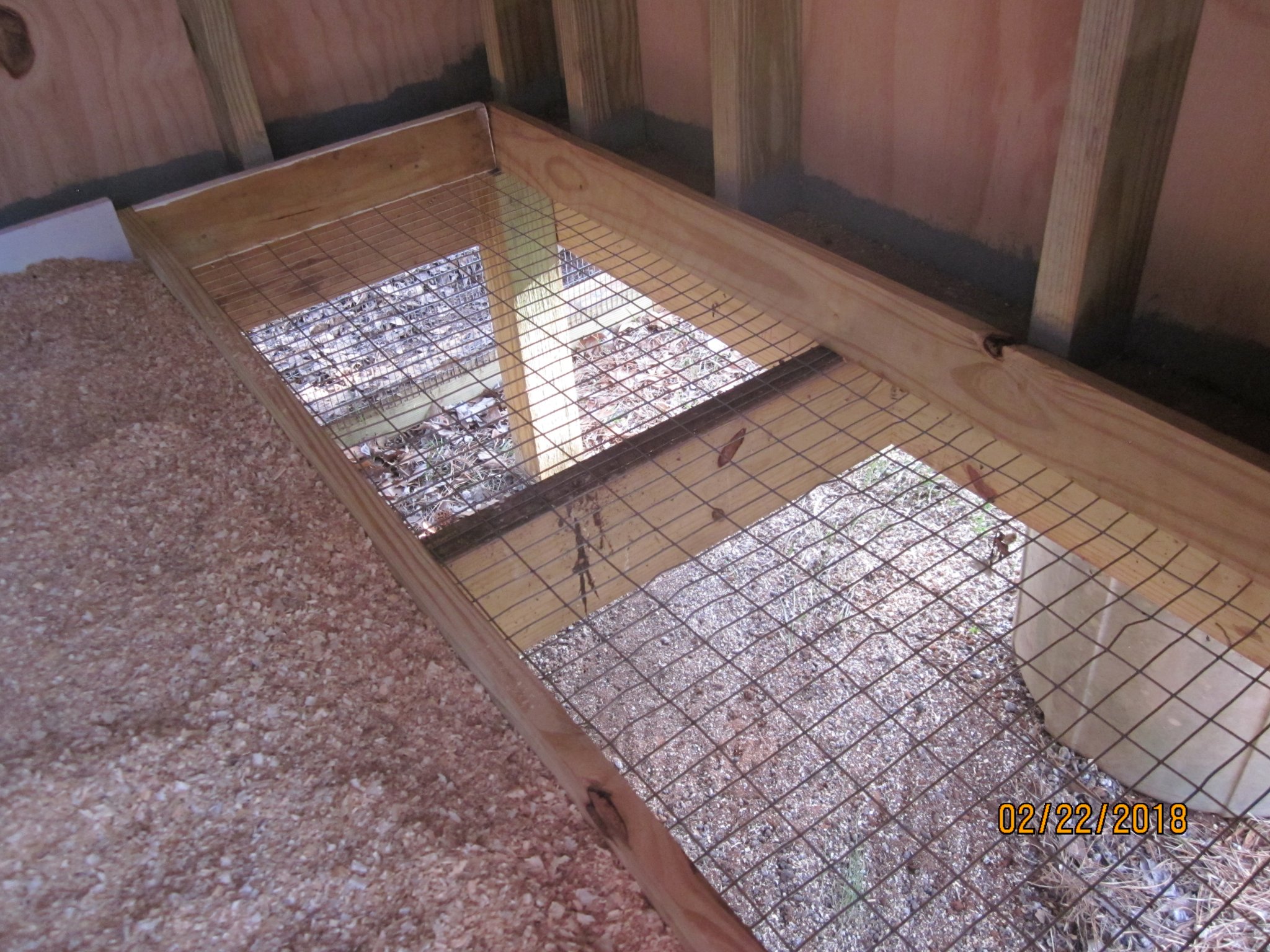

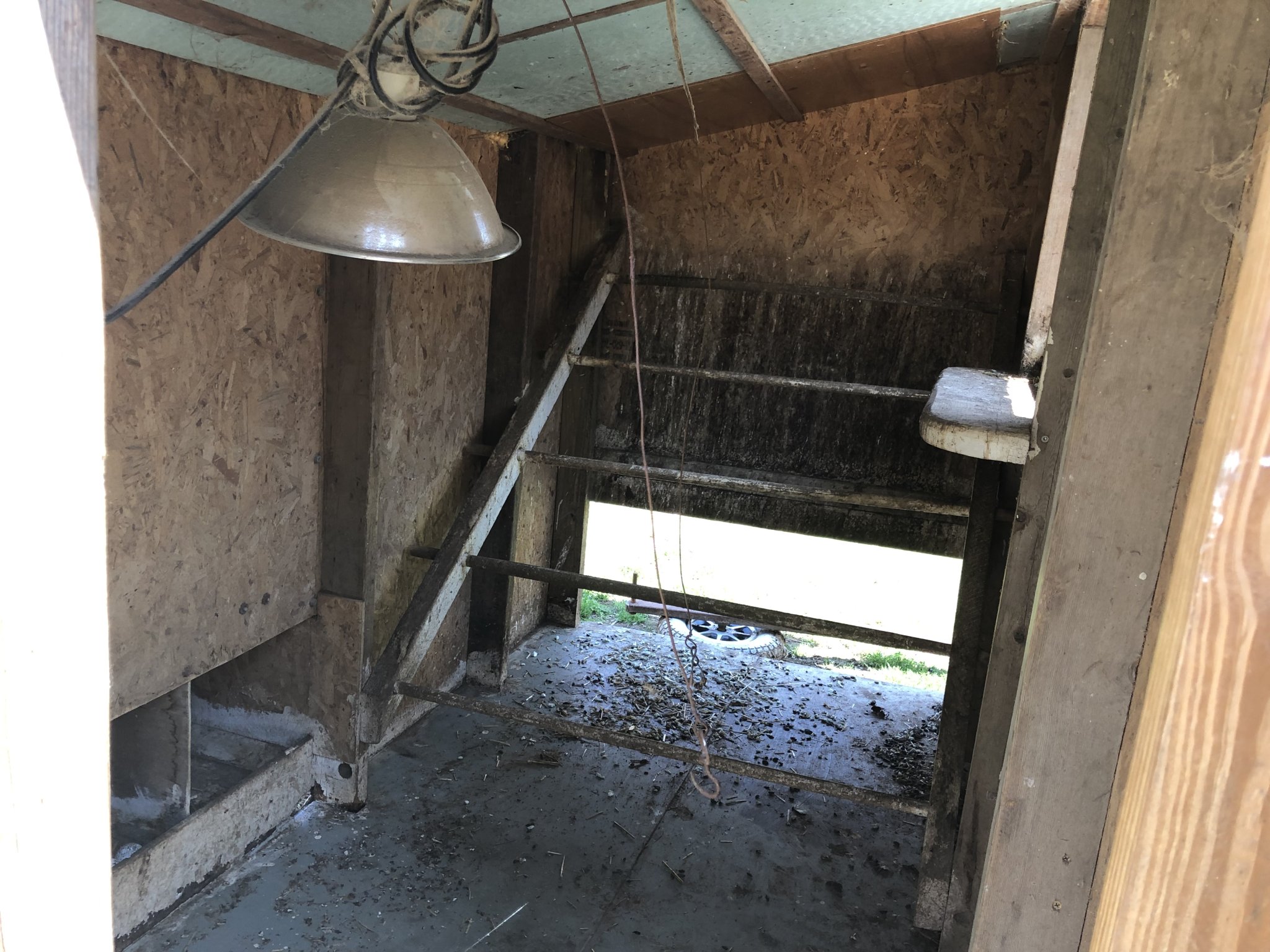

Here are some pics the 13 hens seem to do all right I intended to have 10 when I built the coop the other thing that worked out pretty well is i used linoleum on the floor and up a couple of inches on the walls of the coop so it is super easy to clean
