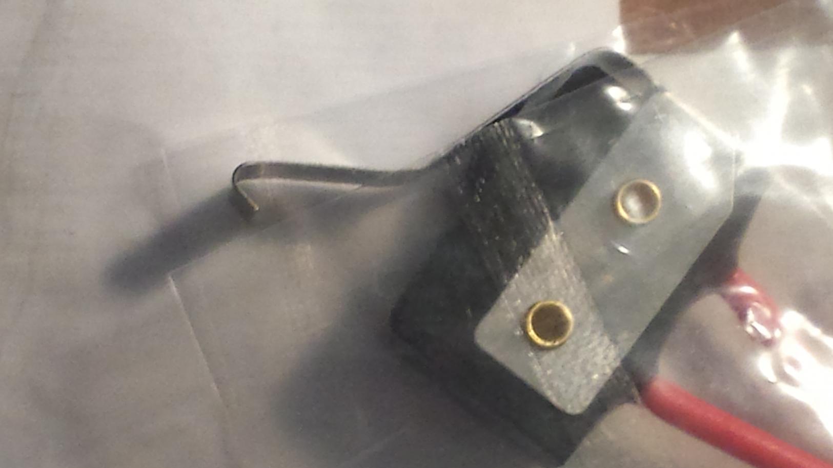

L3450 shuttle switch not working, their is a switch under l side shuttle control
when you place pressure on shuttle shift on startup when i turned off tractor
pulled down on shuttle lever and heard loud click, took apart ,their is a piece of spring metal that is bent and i dont know what position it is supposed to be in please help if possible

Just happen to have a replacement one that I got for my L3450 right in front of me.
