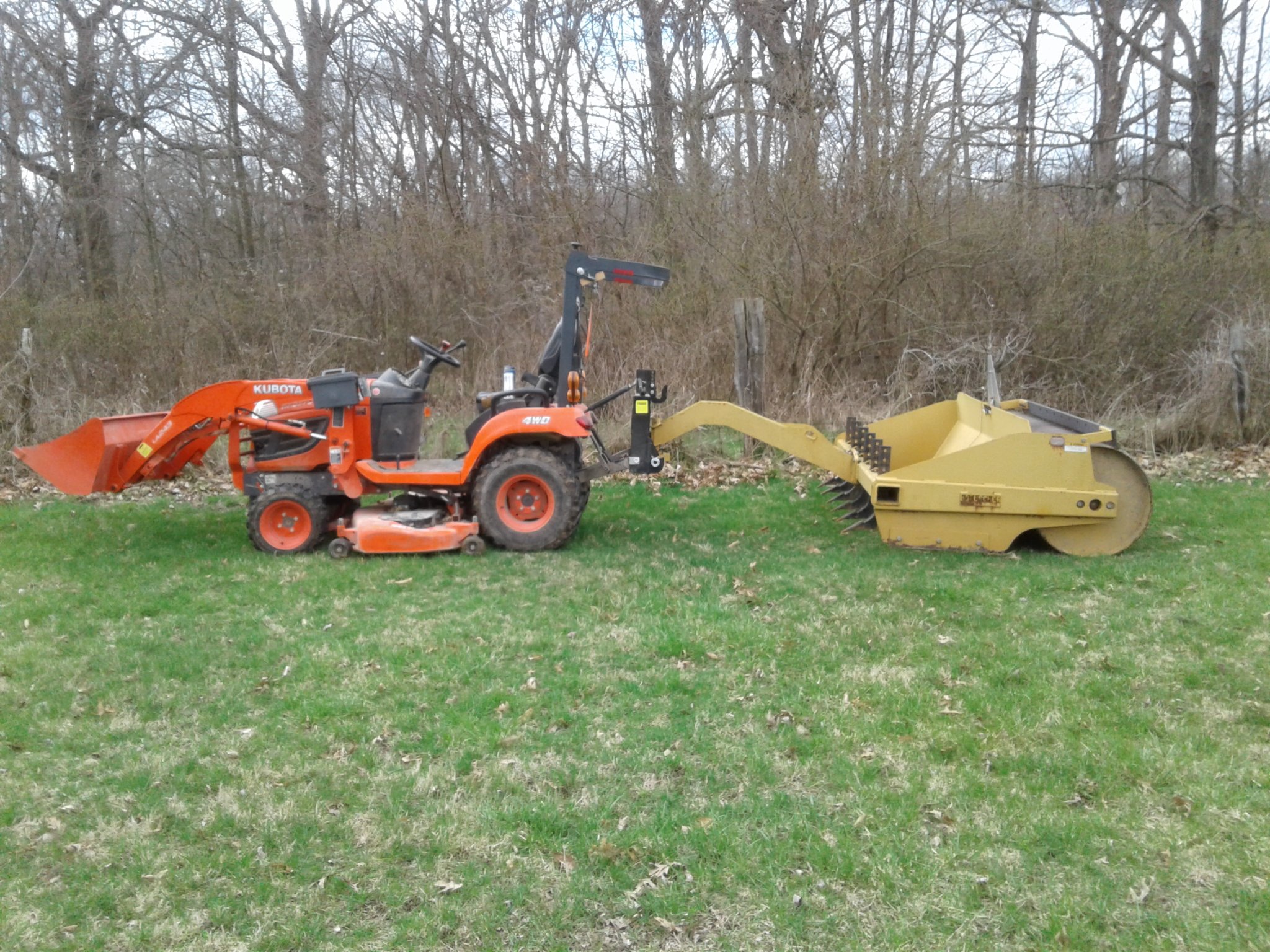

BX1880V w/LA344 FEL, BB1248 Scraper, RCR1248 Brush Mower, 60" Rock Rake
Mar 30, 2021
47
49
southern california
I am no expert.. had my tiny tractor less than one week. My 2 acre lower field is a nightmare of thick weeds, rocks and gopher mounds... I am now looking into a landscape rake to level those mounds and clear the rocks.. search landscape rake on youtube.. that may be what you want
