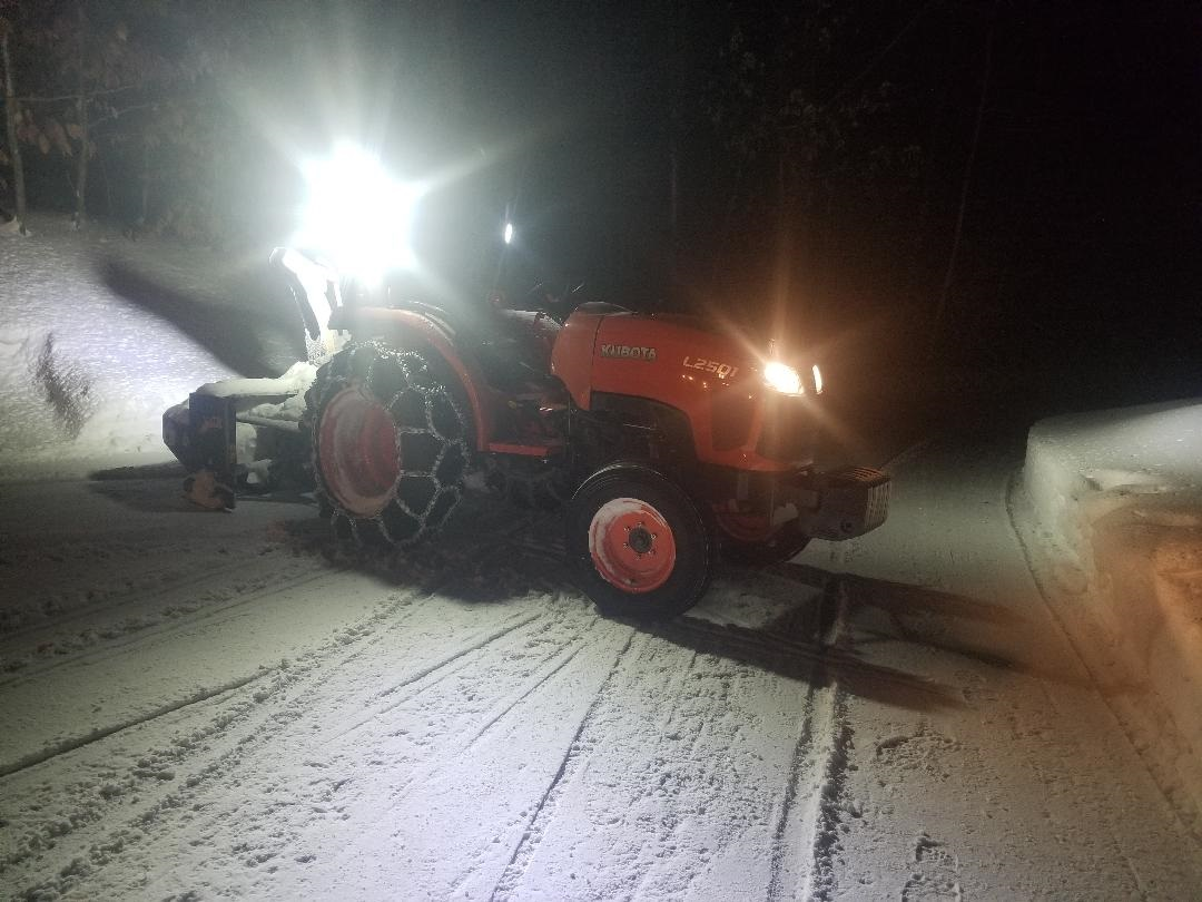

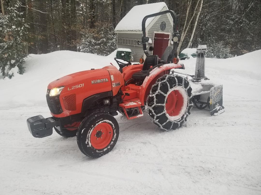

The primary function of my Kubota is snow removal. I have R1's with with diamond pattern studded chains from tirechain.com and they work great. As you can see my tractor is only 2WD and my driveway is hilly. I have no issues with traction using my 3 point blower. My driveway is asphalt and I have no issues with damage to the asphalt from the chains either. Also, if you decide to get a 3 point hitch snowblower
do yourself a favor and get a pull type snowblower so you don't have to drive in reverse the whole time.

How much snow does it take until you can't get the tractor through the pile so the pull-behind can deal with it? Are there issues with the compacted strips from the tractor running on the snow before the blower gets a chance at it? I like the concept, but can picture getting stuck in the barn and unable to make that first cut. It would take a lot more snow to maroon me if I can lead with the snowblower.
I haven't gotten stuck yet. The most I've dealt with at once is 2 feet so your mileage may vary.
There are no issues with compacted snow from the tractor running over it, that's an often repeated myth by people who have never owned a pull type snowblower. The tractor goes through the snow and a clean path is left behind the snowblower.
