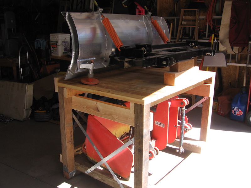

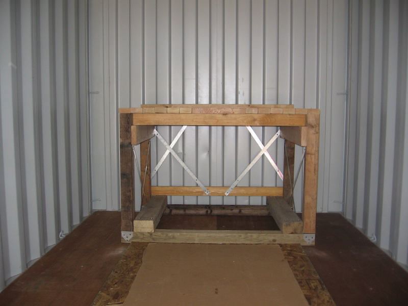

Great minds think alike. (although on different scales) :)
View attachment 153054 View attachment 153055
Yep, great way to save precious floor space. Some of my thought process was also to thwart easy theft. The class II implements bring the weight up quite a bit so it's not like 2 guys can just run up and grab one and throw it in the back of truck or trailer (boxblade is ~1200 lbs, grapple is ~875 lbs, brush cutter is ~1150 lbs). Then i chain/lock everything up even though i know a cordless grinder makes quick work of stuff like that but it's just another obstacle to get through and more discouragement (helps me sleep better at night). I have motion sensing lights and wireless (cell) trail cams too. Hope i never need any of that but figured i'd do what i can right from the start.

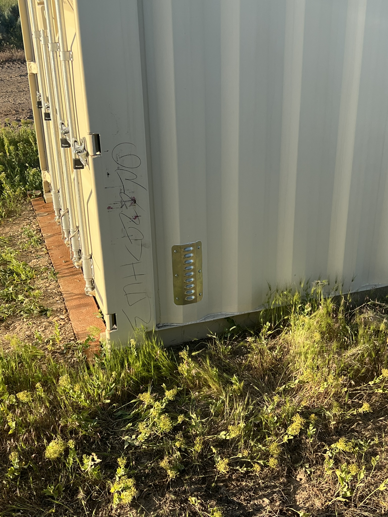

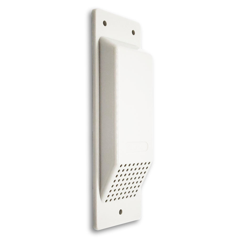

Earliest containers had no venting.
Early containers had one or two vents.
Usually, the newer they are, the more vents they have.
My neighbor's has 6, mine has eight, and I have heard legends about containers with 10.
You can also buy vent kits to add vents.

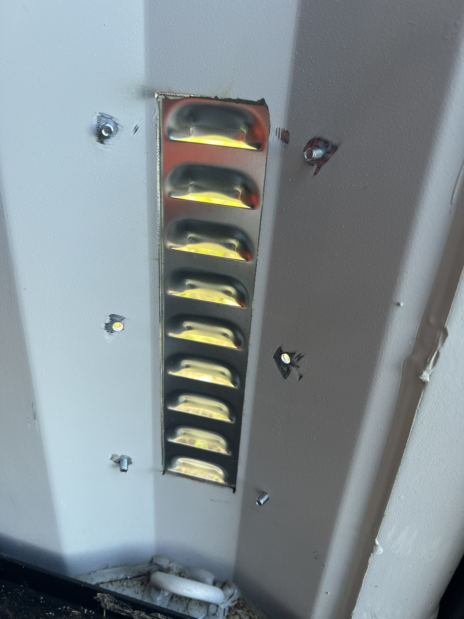

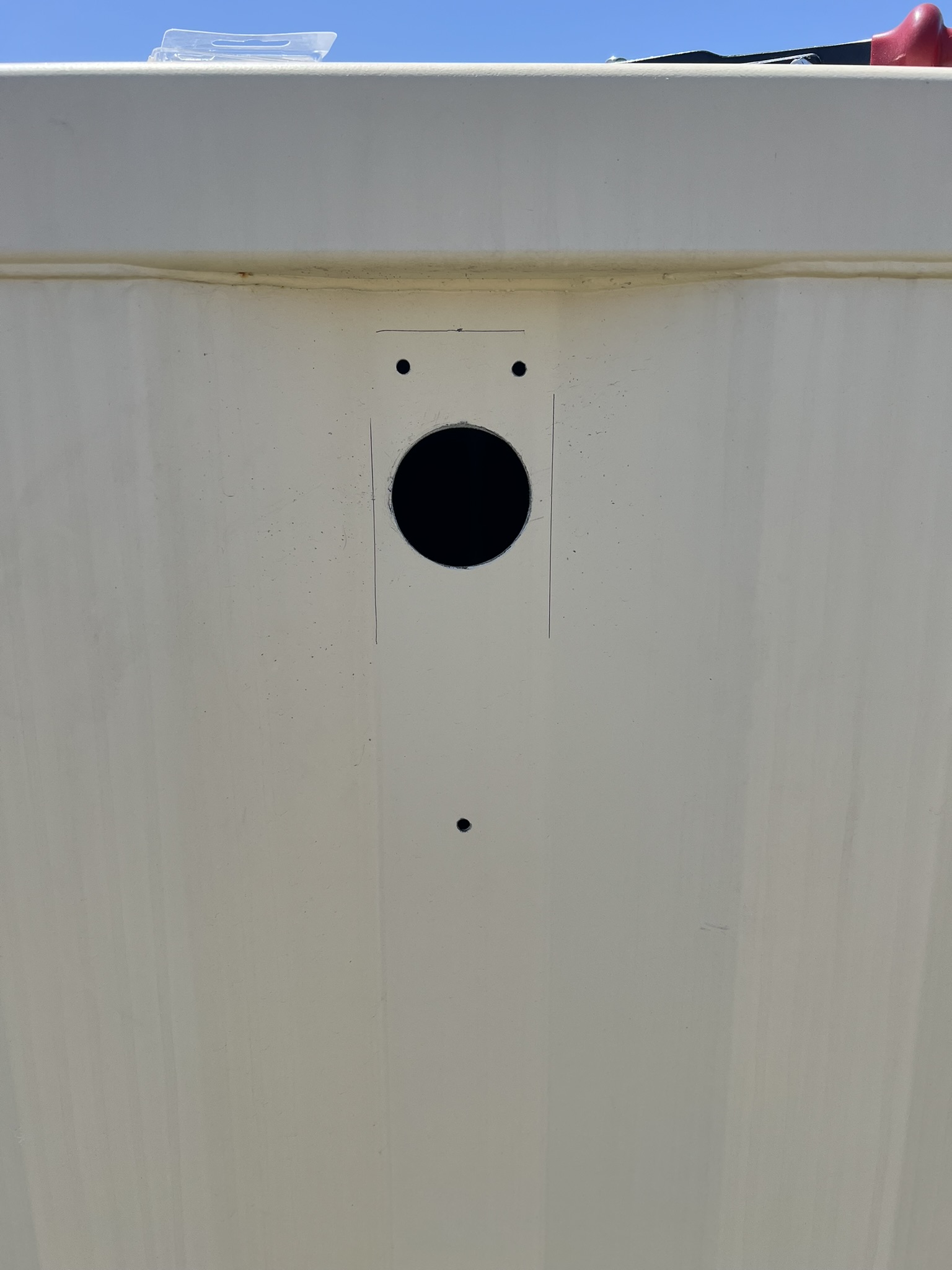

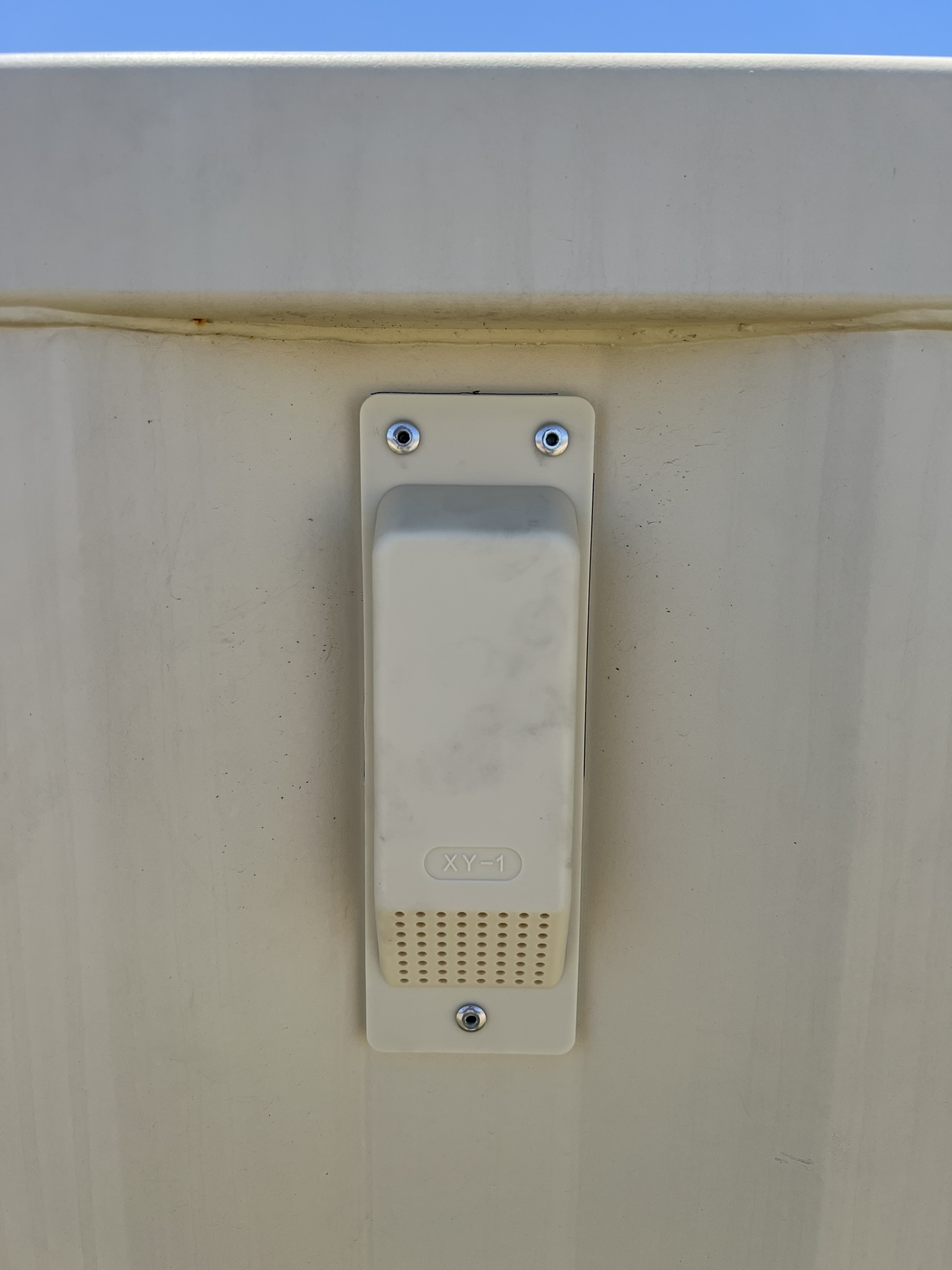

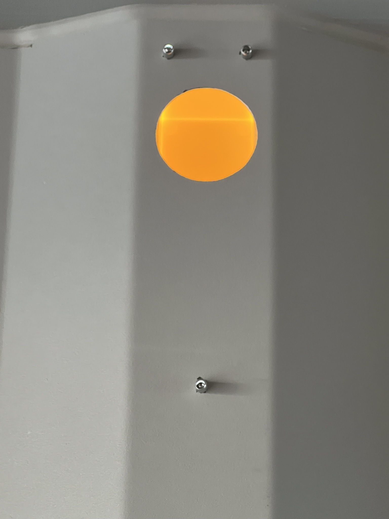

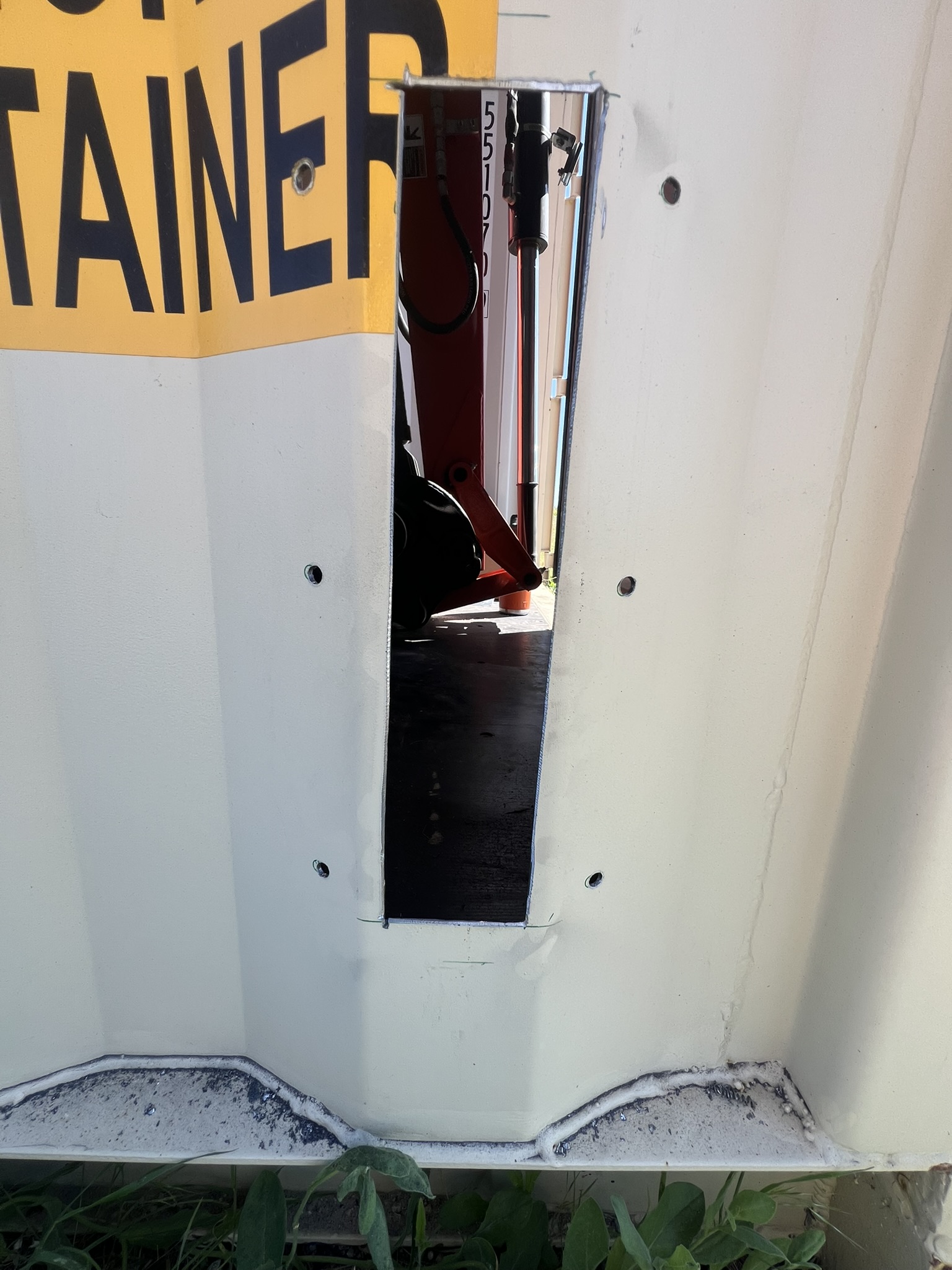

Added a couple more vents (8 in total): 4 lower corner vents and 4 more OEM upper vents. The corner vents are pretty nice, all stainless, fairly heavy gauge, working out great over the summer so far. I've brought a thermometer with me a few times on hot days to see how hot it gets in the shipping container. At the very top (ceiling level) i've only seen 5'F-7'F hotter than outside ambient temp, that's with the sun straight up beating on the roof. Generally when i open the doors it seems a little be cooler inside. No moisture seen or evidence of moisture since all the vents installed (end of May). House/shop blueprints are pretty close to being finished and submitted for permits (hoping to submit by end of September).
