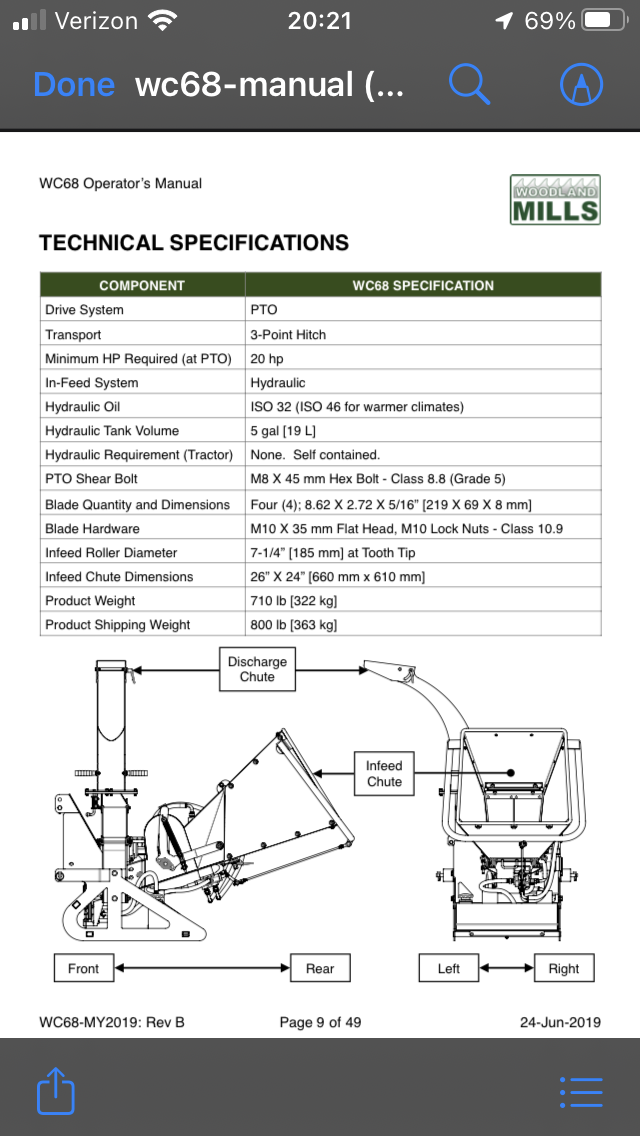

I finally made a decision to purchase the WC68 chipper, should be here in the next 2-4 weeks. In the mean time I want to get stocked up on spare parts like shear bolts. They spec out either an M8x50 8.8, or 5/16x2 Grade 5. It seems like many adverts with shear bolts neglect to state the grade of the bolt. I don't want to get a grade 2 or I'll be swapping bolts too frequently...so, does anyone have a favorite TRUSTED supplier of shear bolts?

Mine came with a couple extras and one already installed. Probably 75 to 100 hours on it between me and my brother (who co-owns it). Not sure what you’d have to do to bust a shear bolt. Chipping 5” sweet gum, hickory, oak, eastern red cedar, and loblolly pine won’t do it. Even if it gets clogged with gummy wet pine and cedar (slow feed speed if it clogs) it hasn’t busted a shear pin. Maybe trying to chip black iron pipe? (Don’t do that.)
If you want to stock up, Fastenal, Grainger, McMaster or a good local hardware store should have an appropriate replacement. Sounds like you know the specs but for whatever it’s worth, the specs in the manual should be below.

It's my understanding that Grade 5 and metric 8.8 are pretty much the same strength? I use 8.8's on my WC68
