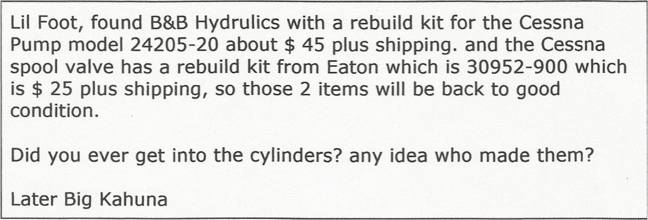

2. Does anyone know what Cessna model numbers pertain to the original valve and pump? Hoping to source rebuild kits for both, though I suspect only the valve has an issue -- methinks there might be a slight leak through one of the levers.
I knew I had this info around, just had to dig it out.
Ok, Big Kahuna sent me this info on the pump & spool valve rebuild kits…. I only did the spool valve, as my pump seems to be working fine & has no leaks.
The spool kit is a universal, and had some extra parts, but it had all the seals to R&R mine, with the exception of the float detent parts, which had become iron oxide in my valve.

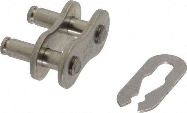

Evan, look carefully at the chain for the master link just like in the photo below. After soaking it with some PB Blaster it should come apart. You may have to use a small diameter punch to help drive out the link after you remove the retaining clip.
Both chains will have master links. Remember the direction from which you removed the retaining clip. Be sure to install it back in the same direction so you don't make more work for yourself.
If you want to replace it with a new link you need to track down a #40-2 (Double Connecting Link) master link. I got my links from a local bearings, seals, and drive shafts company.
