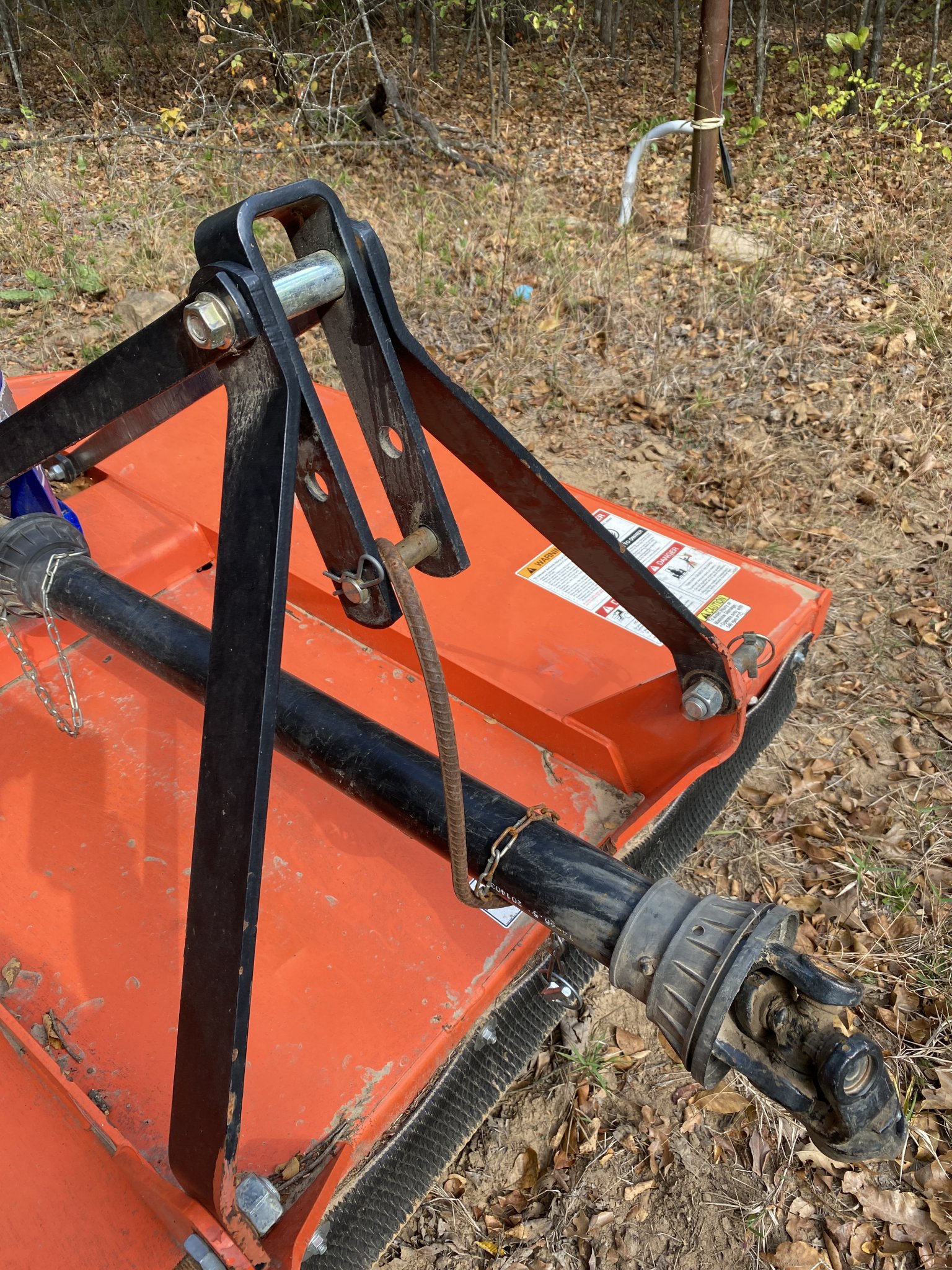

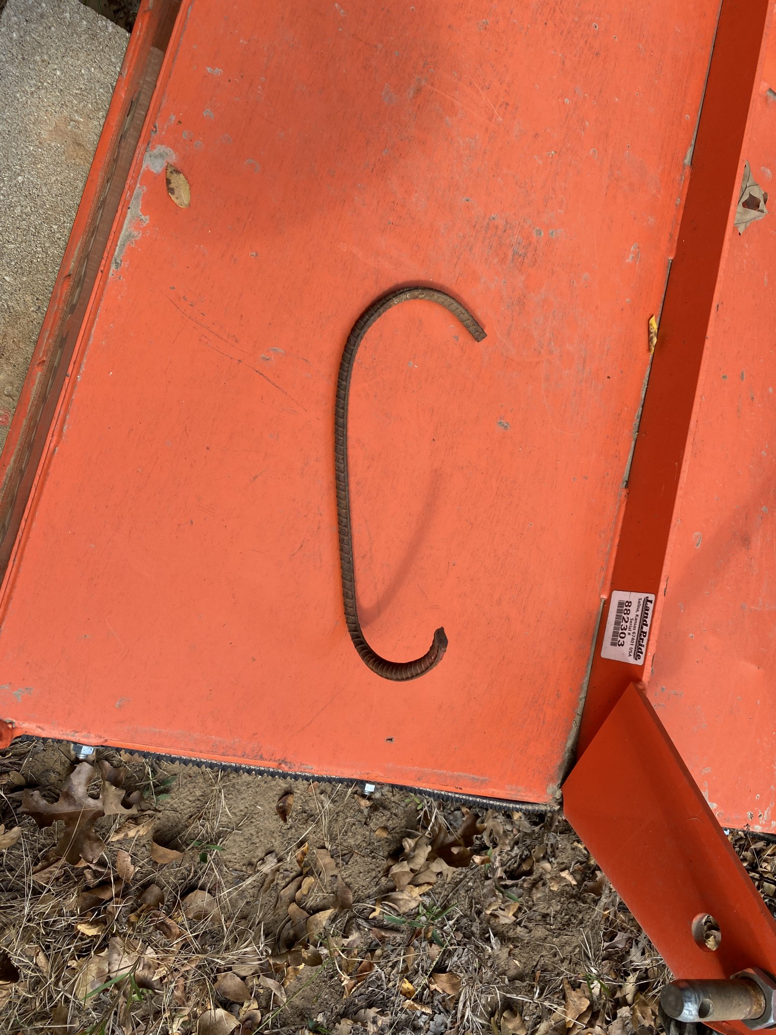

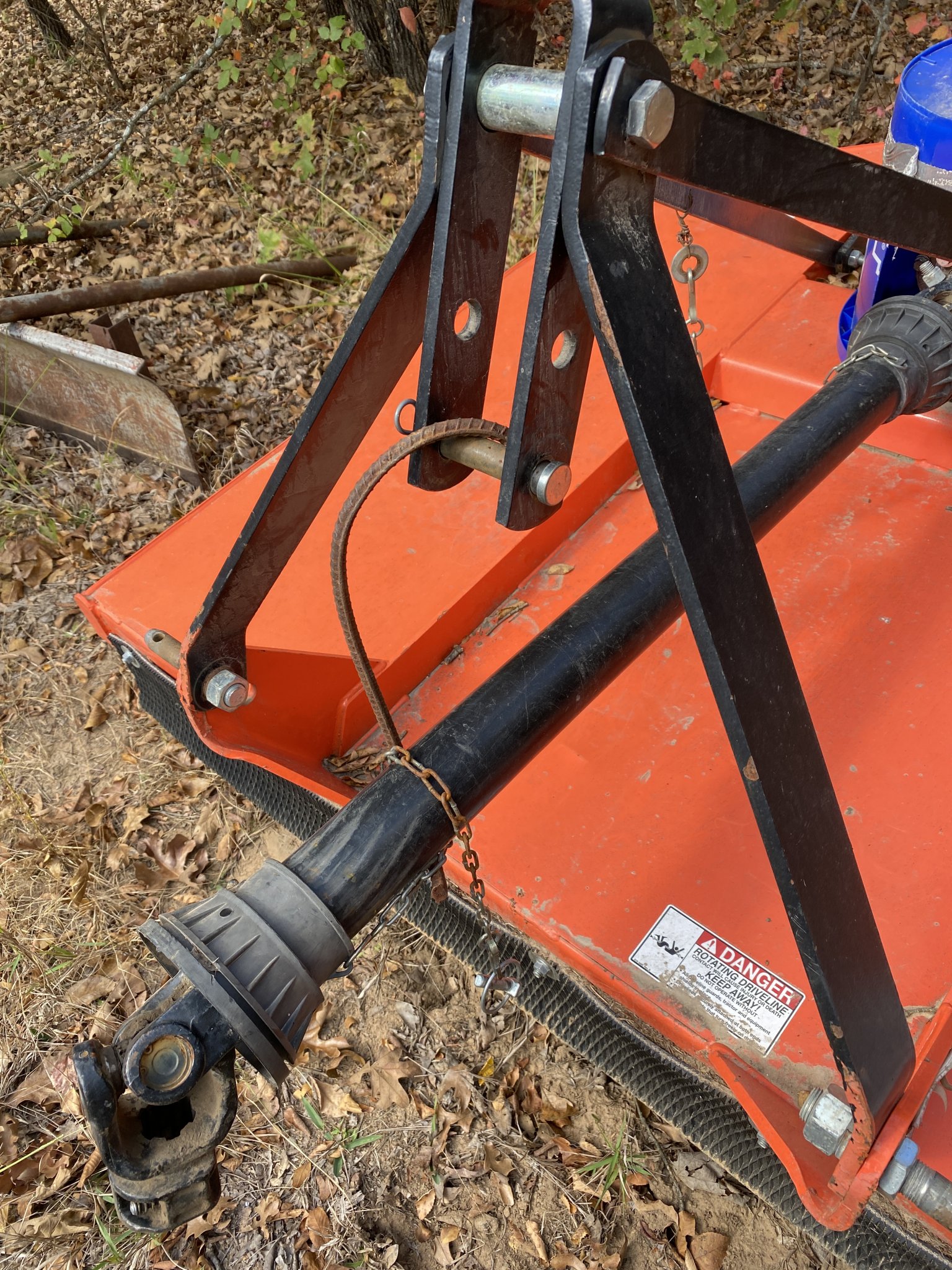

Just found this thread again after having lost it for a couple of weeks. The pics show a piece of cold bent rebar that I use to hold the driveshaft off the ground.
