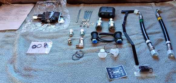

Go to the Kubota parts website and pull up the remotes parts list. Ot wil detail the contents of the whole goods kits. Print them our and check them against what you receive.
As I recall from an earlier quick look there are two parts to the kit. One is the valve itself and presumably that would be the $200 item. The other part contains the handle for the valve along with 2 hoses, fittings, couplers, and an additionsl coupler support.

Here is what I received for my $733. Looks like everything I need. Plan is to start on it tomorrow, I'll document the procedure.

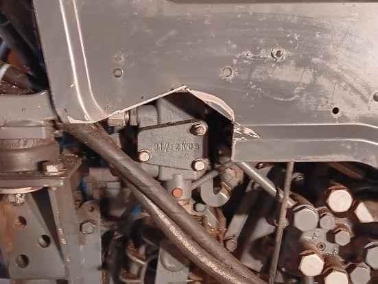

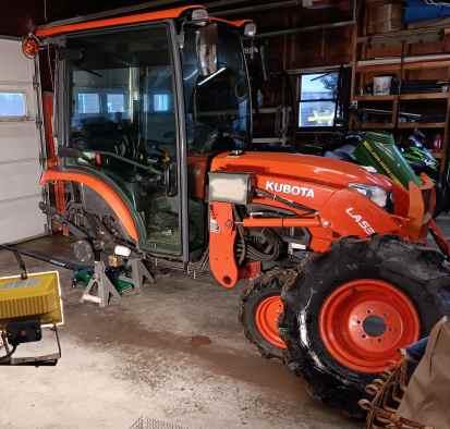

Pulled it into the garage, jacked it up enough to get the wheel off and set it on jack stands.
Trimmed the inner fender to make room for the second valve.

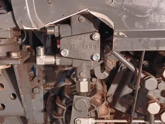

Removed stack end plate, installed longer stud and second valve with o-rings, replaced end plate and o-rings, secured with longer bolts provided.

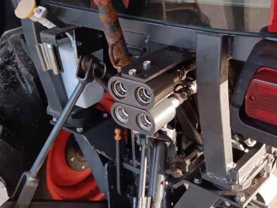

Assembled second coupler, hoses on valve end first then coupler, installed second coupler with longer bolts provided.
While not technically complex, getting and holding multiple parts in place while trying to start bolts/studs was a challenge, especially when you're 73 and what doesn't hurt doesn't work.
Getting the second actuator lever threaded through the side console and the floor and getting those itty-bitty pins and cotters in place while standing on a short step ladder, leaning over the back window of the cab and holding a flashlight in your teeth so you can almost see what you're doing required some verbal lubrication.
All that's left is firing it up and checking for leaks and proper operation.

Nice write up. I forgot about pins they were probally the hardest part of the install. For installing the pins I worked through the right side door standing on the ground instead of through the rear window. I do wish the kit came with a couple extra cotter pins just because they are so small and and very easy to loose. I know this because i dropped one and spent 10 minutes looking for it.

I'm amazed that I didn't drop either a pin or a cotter pin. I used a pair of locking hemostats to hold them which helped. Bending the cotter pins was a challenge.
Function check went fine, didn't see any leaks. When sweeping up after, I found an o-ring that I suspect fell out when attempting to position and fasten the valve stack for the umpteenth time. No leaks that I could see, but I saved it and if one develops I'll take a double dose of Chill Pills and pull it back apart to replace the (suspected) missing o-ring.

If an oring was left out I would think you would know PDQ. Like as soon as you pressured the valves. Did you deadhead each valve in both directions? Did it look like a tank or pressure circuot oring? They are usually different sizes.

It looked like one of the oval orings between the valves.
I did dead head both circuits in both directions and if there's a leak, it's a minor one. I'll go down tomorrow with a clean paper towel and wipe under the valve stack to see if there's any weeping.
