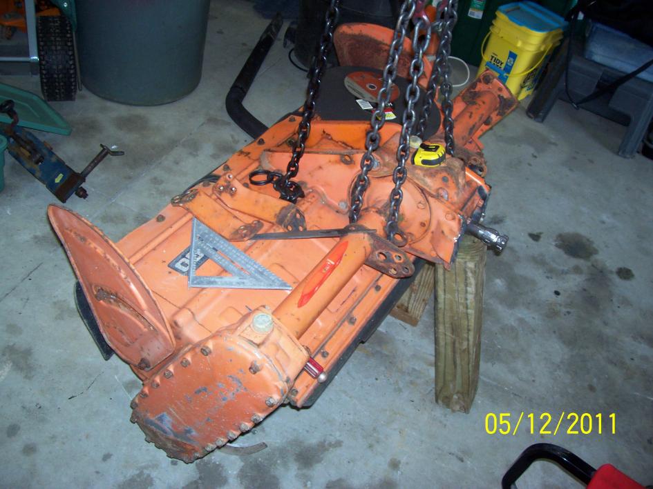

I been studying the situation I went to the tractor junk yard and bought a 3 pt hookup( triangle)off of an old implement.Im going to mount it on top of tiller, bolt and weld, like the kingkutter,tillers I had to grind a knotch in the shaft so the 3 pt qd will lock on I will take some pictures tomorrow. I took the grey upper pc off and the grey arms.they were just in the way.

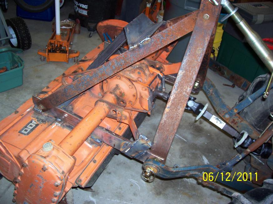

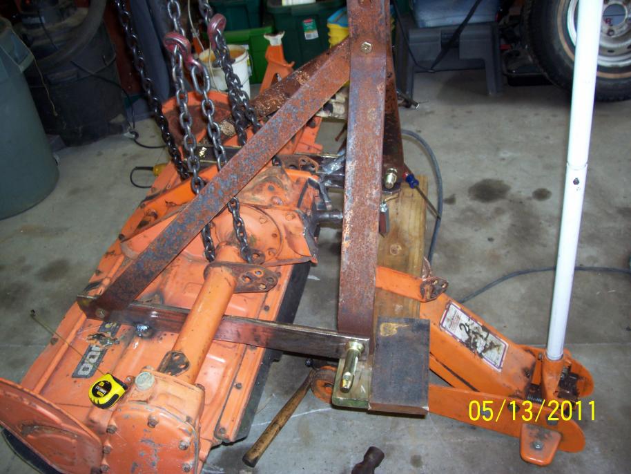

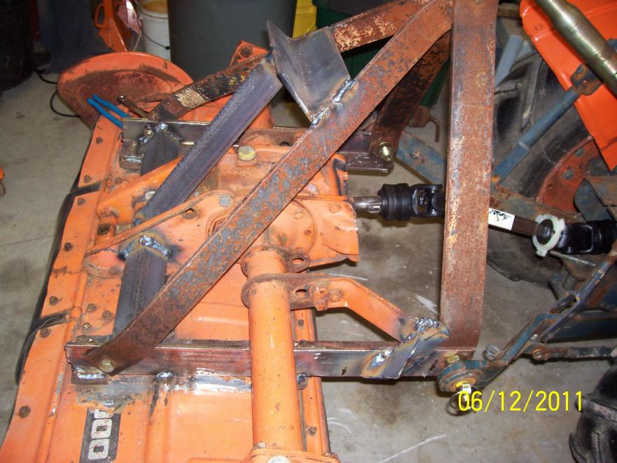

I have started to make this 3pt compatible did some cuttin and tack welding not done yet but heres some pictures so far
i have stardted to make this 3pt

I checked it and the shaft is 1 3/8 6 I had to grind a groove around the shaft so the QD on the pto shaft would lock on. I also had to cut the sides off around the shaft, orange part ( they were only 4 1/2 - 5 inches apart) so if I want to use a slip cluch I can

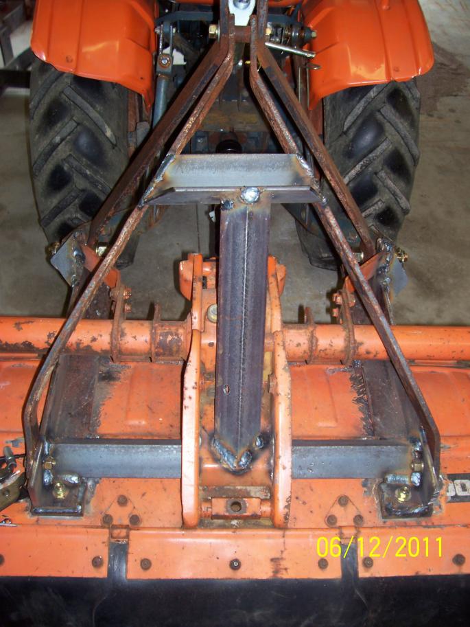

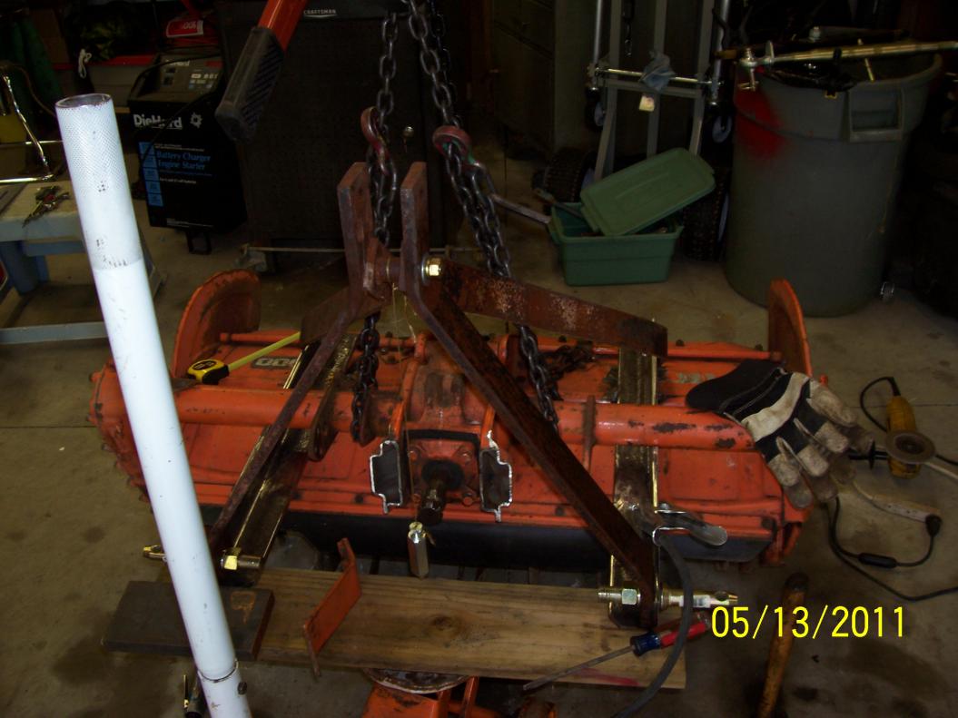

Im almost done with the retrofit on the tiller I have already run it Im not sure what way its supposed to turn(the tiller) I have some more grinding to do. I picked it up with my tractor , and have plenty of clearance and engaged PTO It turns I havent tried to till ground with it yet. here are some more pictures
