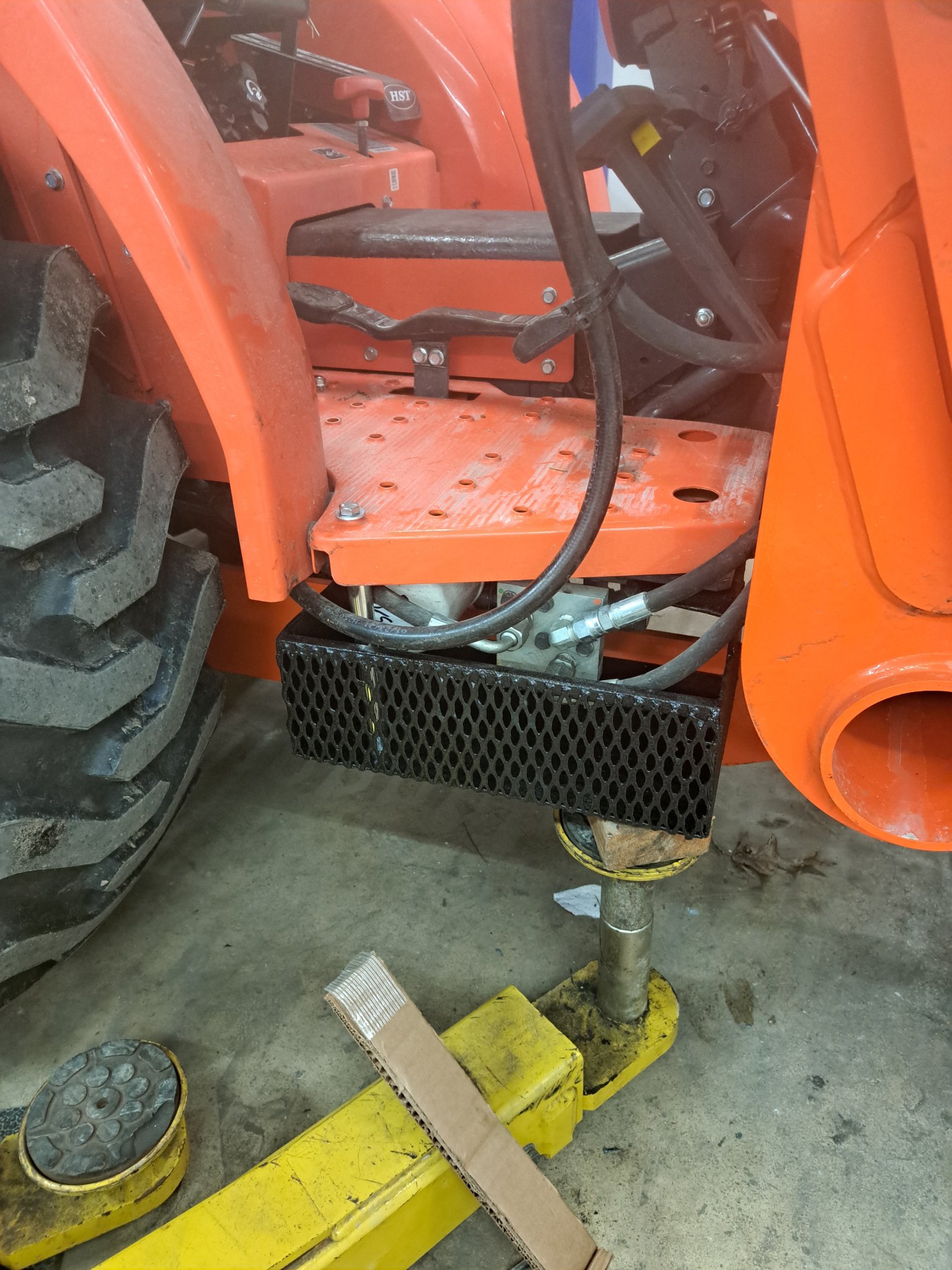

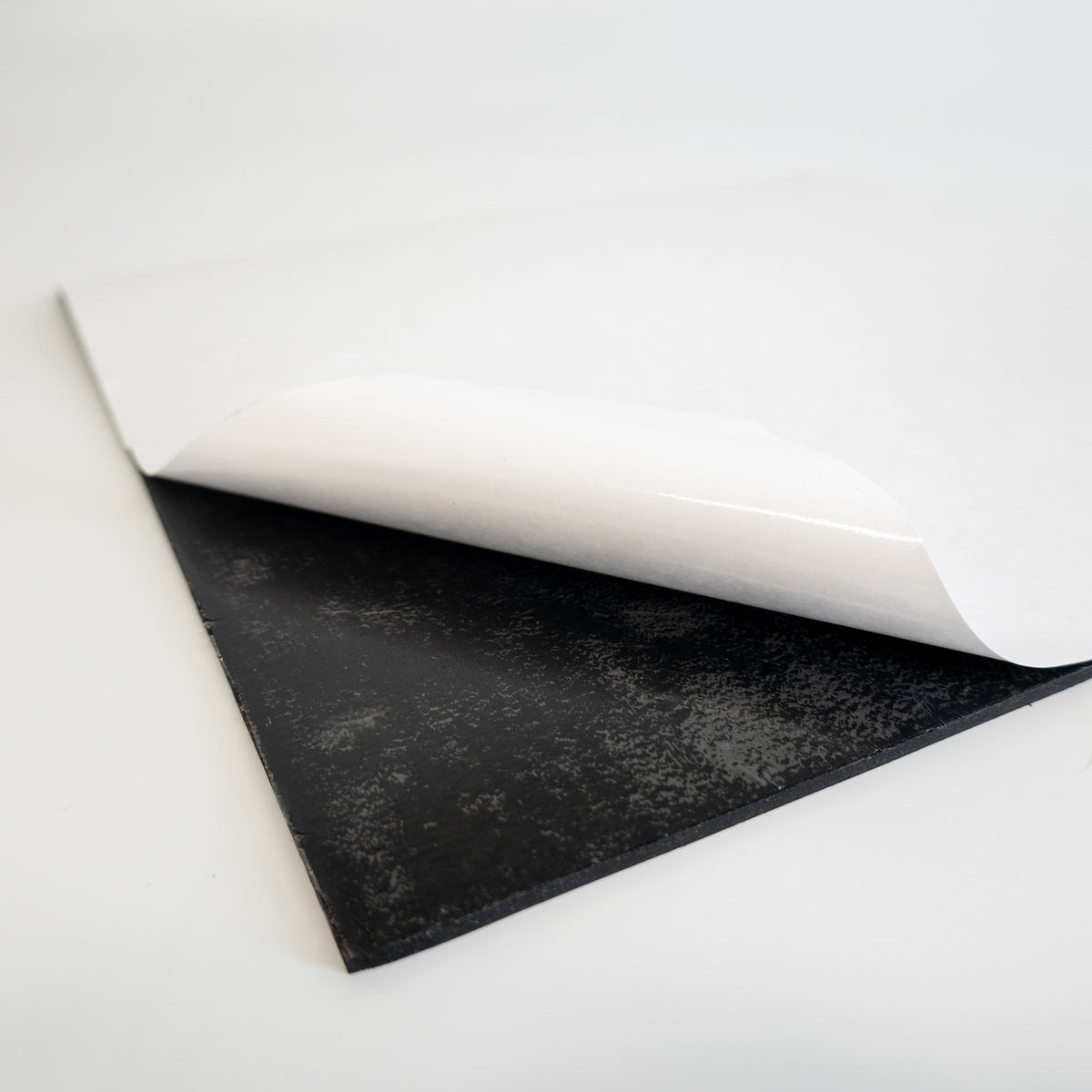

I used adhesive backed rubber sheet to cover mine and it works great,
Dont recall where I bought it from but its similar to this.

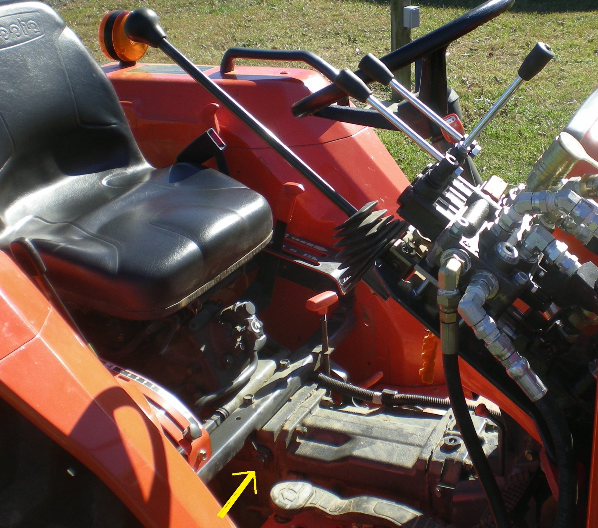

I just took mine off very early on when I was having PTO cable problems (HST) and never put it back on... Also removed the cover under the seat. Didn't see a need for either one, so I removed them.
And it looks like you took off the FEL control cover... Can't see if you have a hood/ bonnet or not. LOL... I did think about just leaving it off as well.

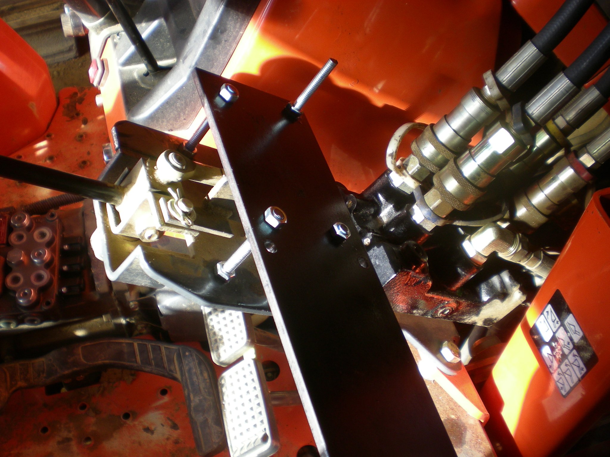

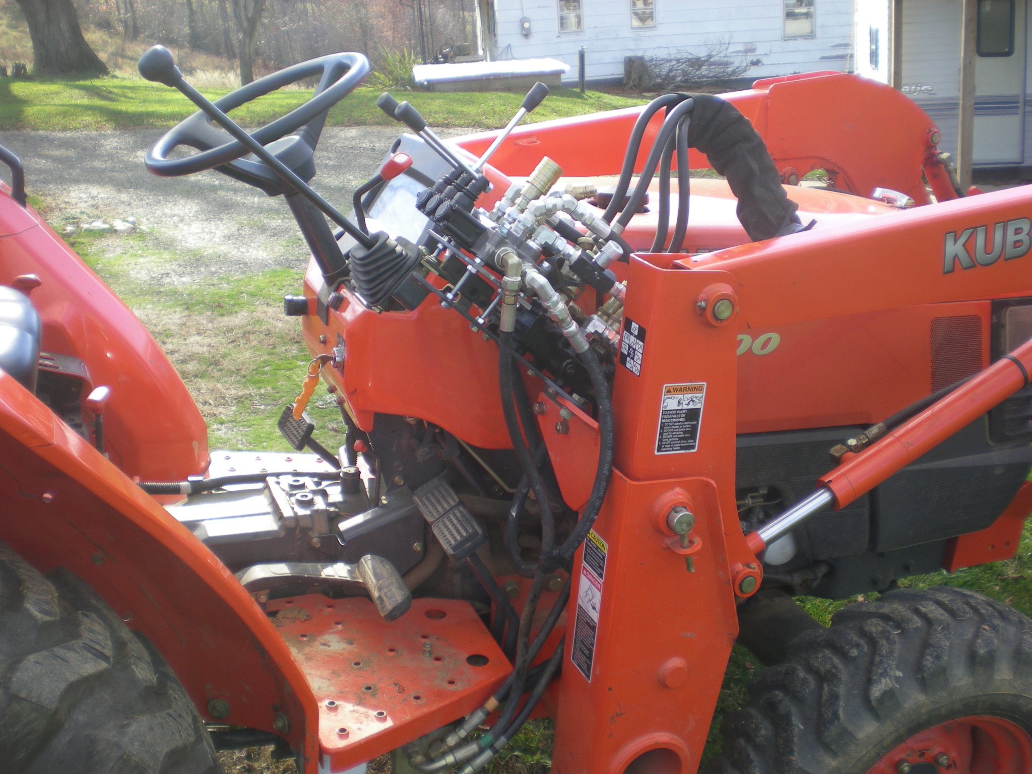

Yes, I removed that bonnet so that I'm able to mount a 3 valve spool on top of the FEL controls. I used the same holes to hold the bonnet to attach a 1/4" flat steel plate to bolt/mount the new spool to. The long bolt also held the new valve along the two holes near the close side. (that flat plate was cut down where the bolt holes are).
I was able to re-use hoses and only buy one hose to connect everything.
It's pretty busy up there but that's not a problem. I don't like that "bird's nest" out back when I'm hooking up the PTO..
Edit to add: that no paint has rubbed off in that area and never a problem with my feet hitting anything.
