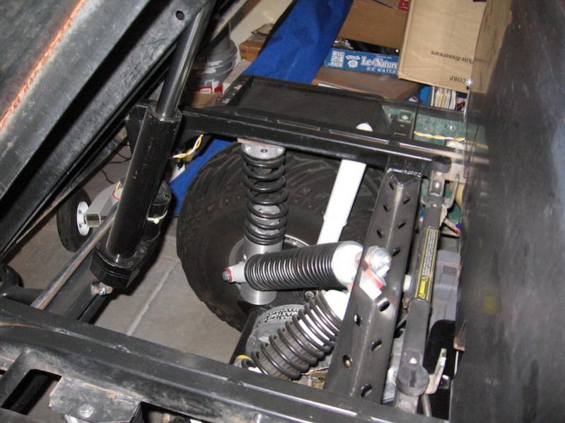

You can find Polaris Ranger beds all over Ebay for $300. They're 36.5x 54". Might be able to make something like that work.
8,199
3,580
There are also Yamaha Rhino beds on ebay; again, might be able to modify one from another application easier than building one from scratch.
Don't have any pics, but I talked to a guy who had his old school Ranger bed stolen :eek::confused: and had put a metal box from a small utility trailer on it as a dump bed. Looked odd, but it worked.

Thanks NBKING, It looks like your cylinder attaches further back then what a 2008 might.
For right now I have a simple pallet bed.
The old box should be enough to make an original out of.

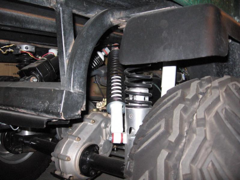

That second picture makes it look like a large dump already attached!:D
That's what I took off. It was almost 6' high. If i put anything in it I'd have to dump it all out on the ground to get it out. The pivot point is 2' above where the bed should pivot. It could dump into a dumpster I guess?? Not exactly what I want to do with my tools or grand kids or cooler.
