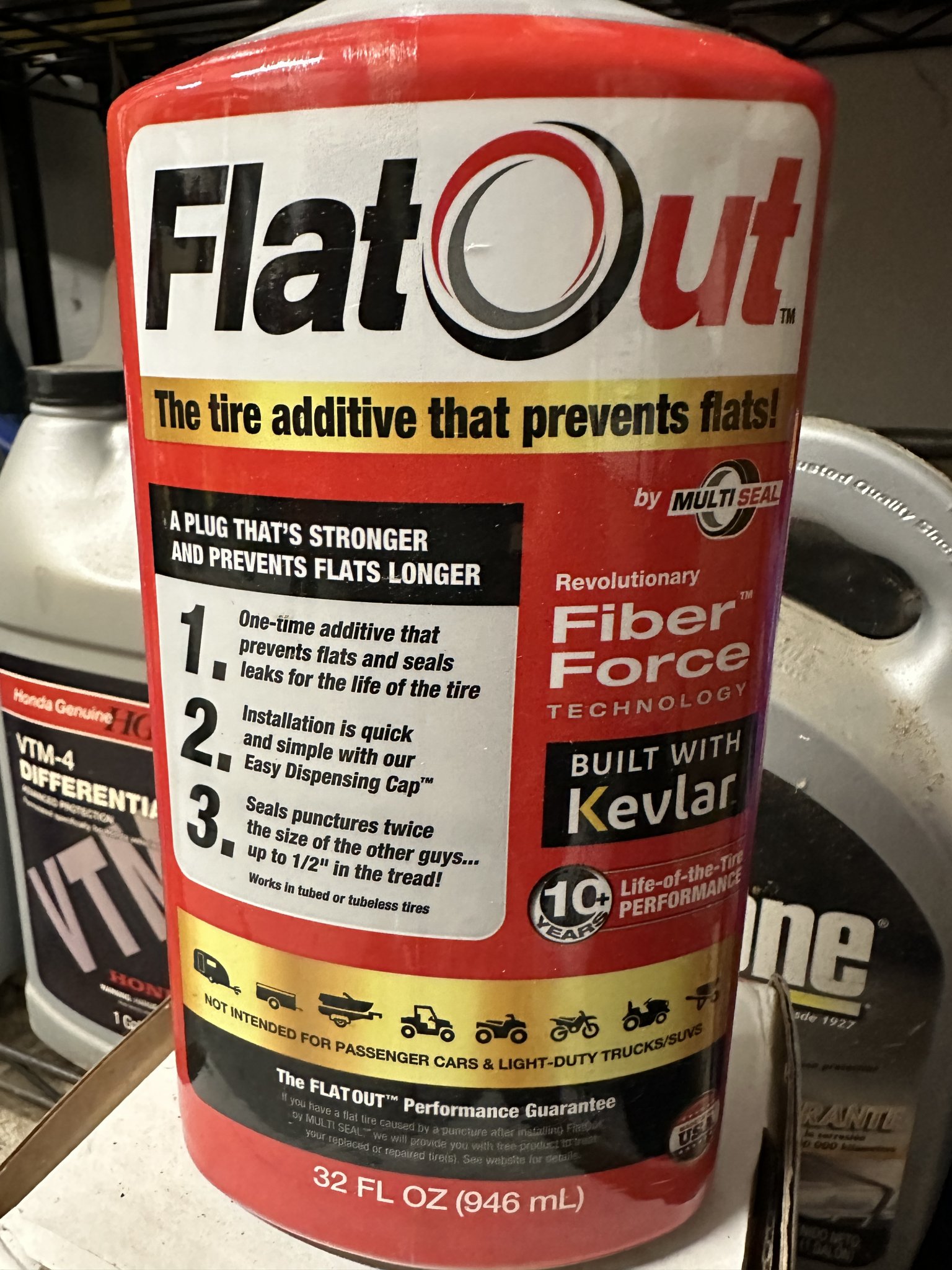

I use this in the quad. Flat Out. Big knobby tires that tend to crack and leak over time. Water based and easy to use and clean up. Rinses right off the wheel and tire. Stays liquid. No air loss on the quad since I added it back in 2019. Probably won’t help for a side wall puncture but anything in the contact area is covered. Picture doesn’t do justice to the knobs on those tires. Bought it used and it’s what it had on.
