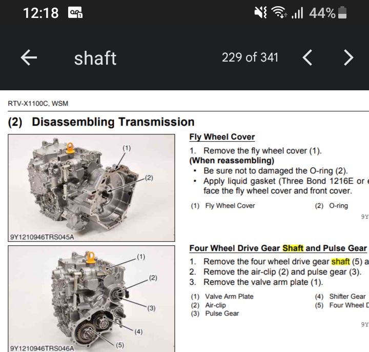

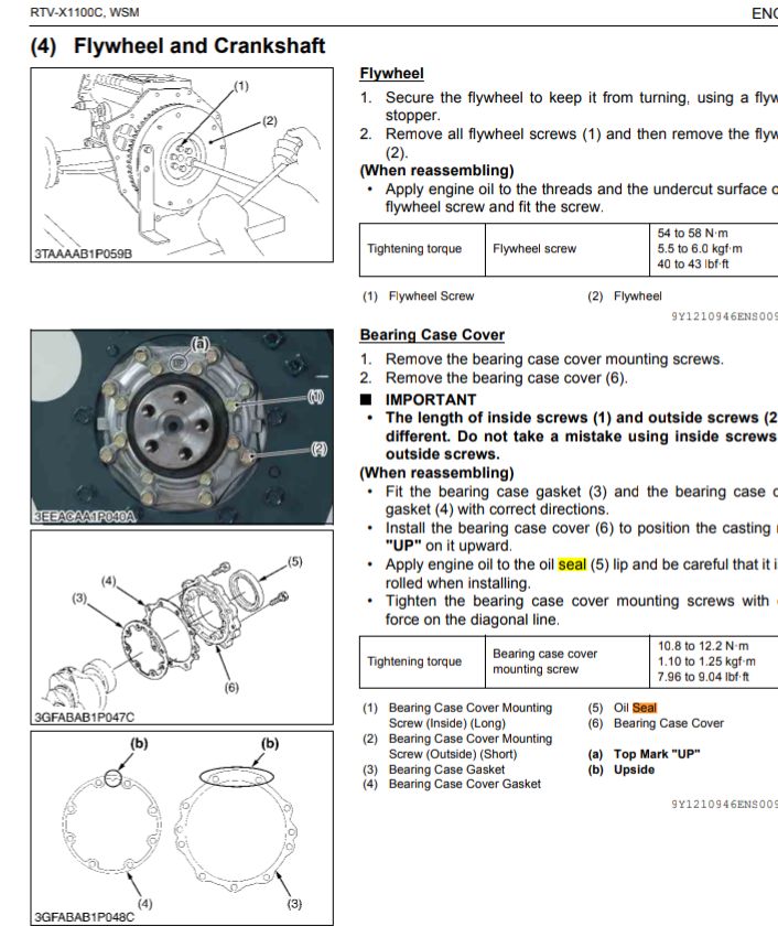

In the shop we would quote out
I drained about a pint of oil from the bell housing. I agree that the seals are the most likely source of the problem.. Any idea of the cost/complexity of replacing them?
Real time do it yourself first timer maybe a week time of work, All depends on the person I guess
You'll need some jack stands and a jack for sure, separating engine/hst from frame. Not too bad
