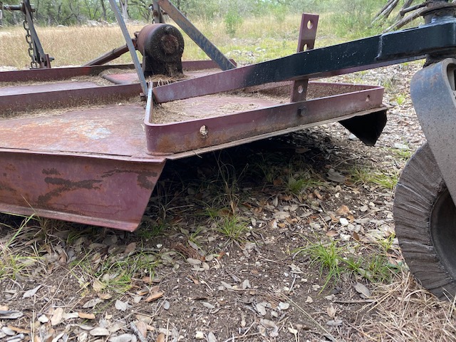

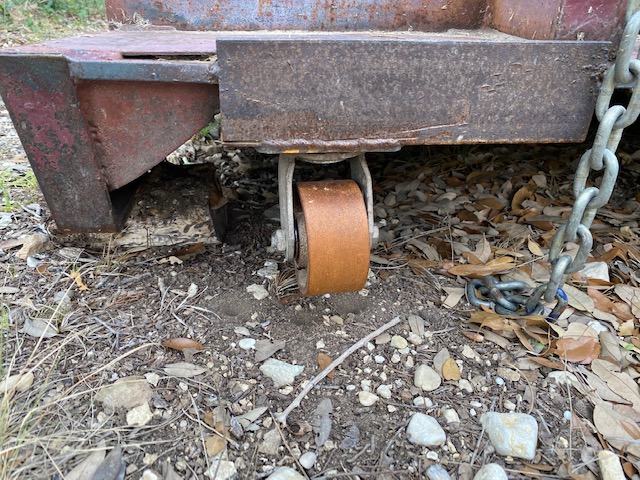

Everything is as should be, in fact previous owner welded steel caster type wheels on the front of the shredder to prevent the skid rails from dragging. Rear wheel hits the ground occasionally.

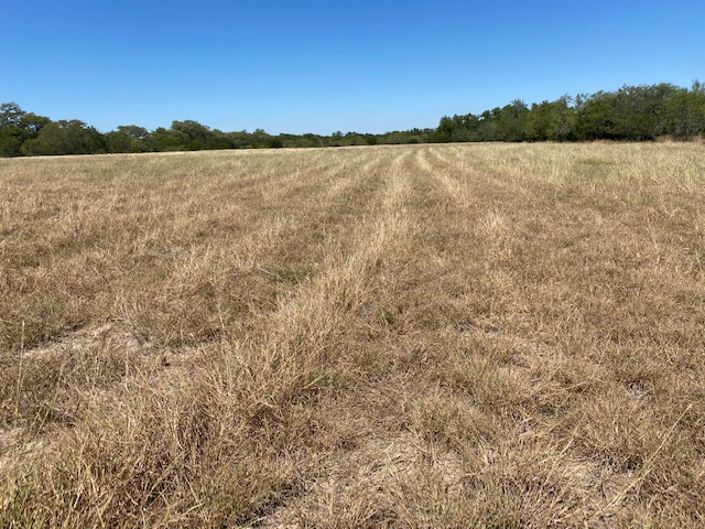

Got back up here and here's what it looks like. Had some rain up here last week, so the KR blue stem started perking up again.

In my experience with KR bluestem you cannot get it mowed well and it will look like your mower is not even trying to mow well. You may get it cut with a sickle bar mower going very slowly but a rotary mower blows it down before it hits the stems
Makes sense since it's really dry right now. Blades aren't flat, they have a rise on them, supposed to help with pulling grass up as it's cutting.
For grins I might make up some chains and see what happens as far as clomping goes.
