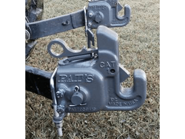

I will try that. I had to take my pats off to even get the top link hooked up. With no top I could put the pats back on. Once my tnt from Brian shows up, I’ll be golden!

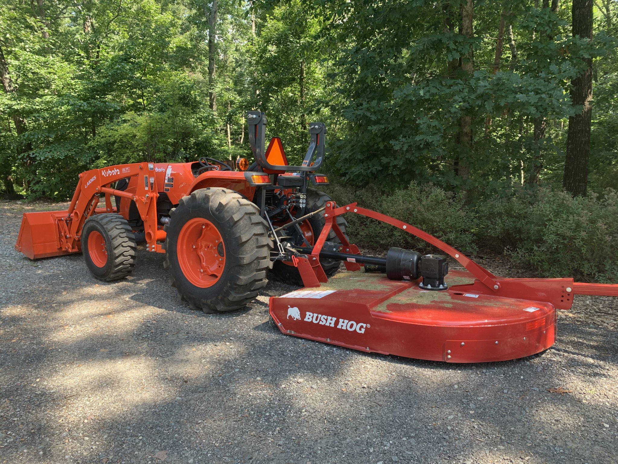

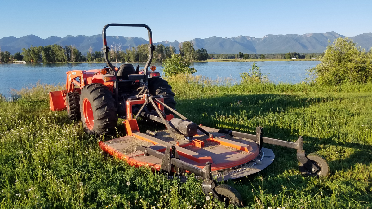

My cutter has a pivot pin near the top link to allow the cutter to articulate about the lift arm pins. It looks like Matt's Bush Hog has the same or a similar feature. Cresting a hill would load up all three connection points but the MX handles the weight with ease.
I've used my cutter a lot and am quite hard on it but the top link heim that I welded on has held up just fine, unlike the factory top link heim that buckled under load.

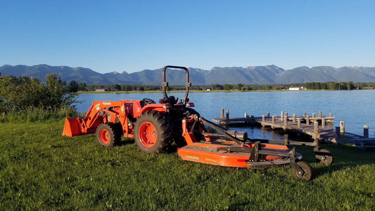

Awesome looking cutter! I like how tall it is. Even the color is nice too.
Thank you. Love it so far. Gonna raise the rear another hole and try that. I’ve already got some bends in the shield thing. Will probably use it as is, till it’s beat up, then add chains.

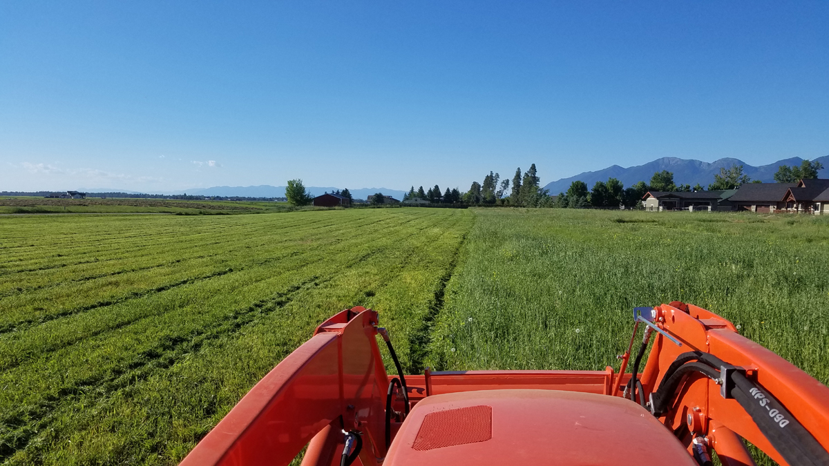

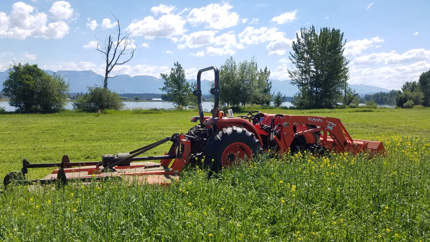

I got to run my rotary cutter around 8 acres today ... up and back, up and back ... with the occasional break to admire the scenery. I have to go back to tomorrow for about an hour to finish up but it was a fun afternoon for sure. The RCR1884 is an excellent cutter as far as I'm concerned, and the MX is simply outstanding.

I apologize for the possibly dumb question, but what is a “pat”?

It is a type of quick hitch.

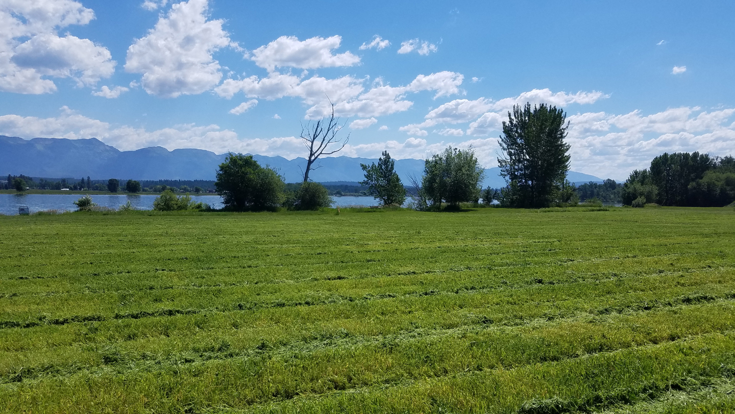

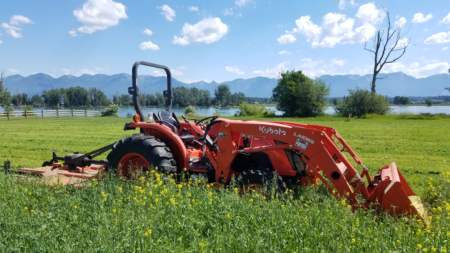

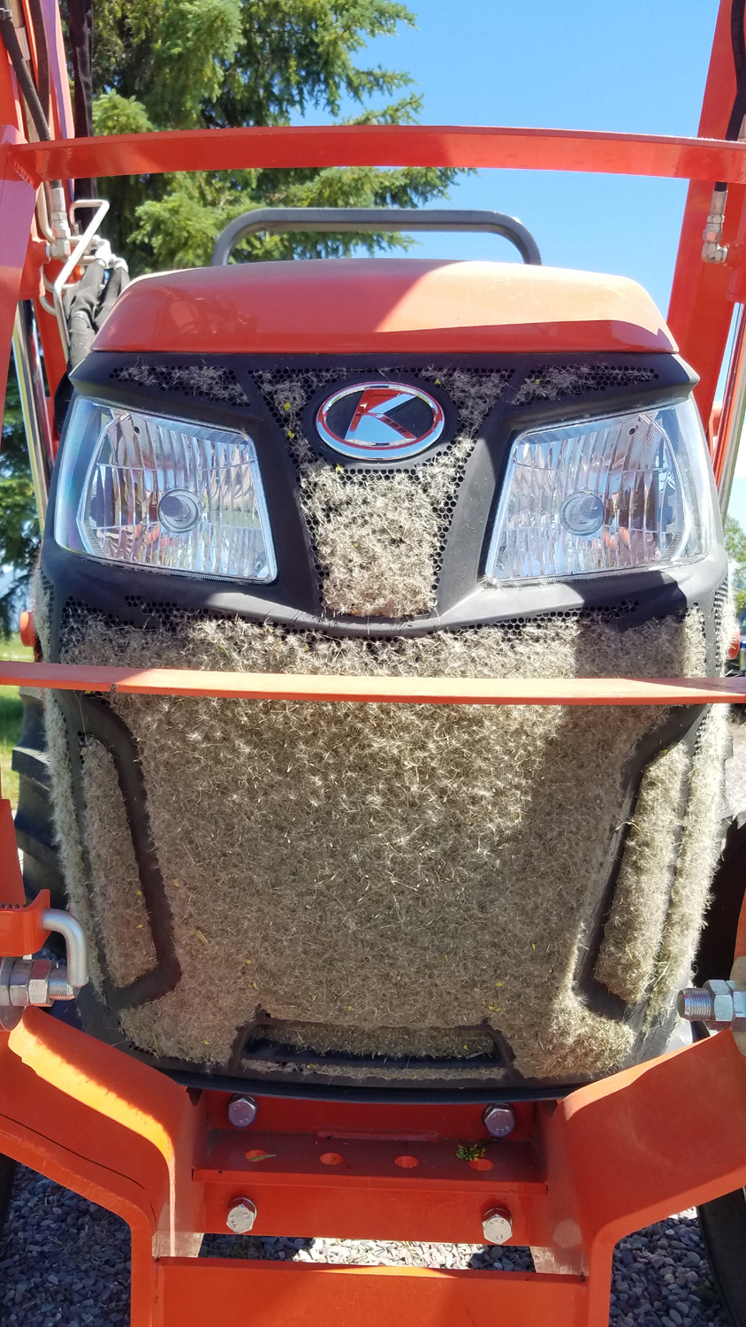

@Matt Ellerbee, have you used your cutter a bunch already? I'm loving mine for sure. I finished up at my friend's this morning and am very pleased with the final product. It's not a finish mower but it sure does do a good job with the tall stuff. Amazingly enough, the tractor wasn't even close to overheating despite all the fuzz on the face. Kind of looks like a bee in the last photo. 😂

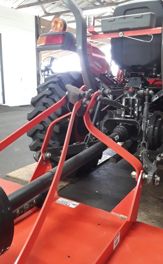

This is a drawing of my Rhino TW96 mower hitch: https://store.germanbliss.com/servis-rhino-tw96-sn15129-current-rotary-mower-hydraulic-offset-parts
As you can plainly see there are only to points to hook up the mower. I was trying to find a better way to explain that 2 points is all that you need to have a safe rotary mower.
This photo shows what happens when you use the top link and the amount of movement allowed to the top link is exceeded. This is on a L3901. All 4 bars that run to the top link where bent. The operator of the tractor, my son's boss, has no clue how he did this to the mower.
