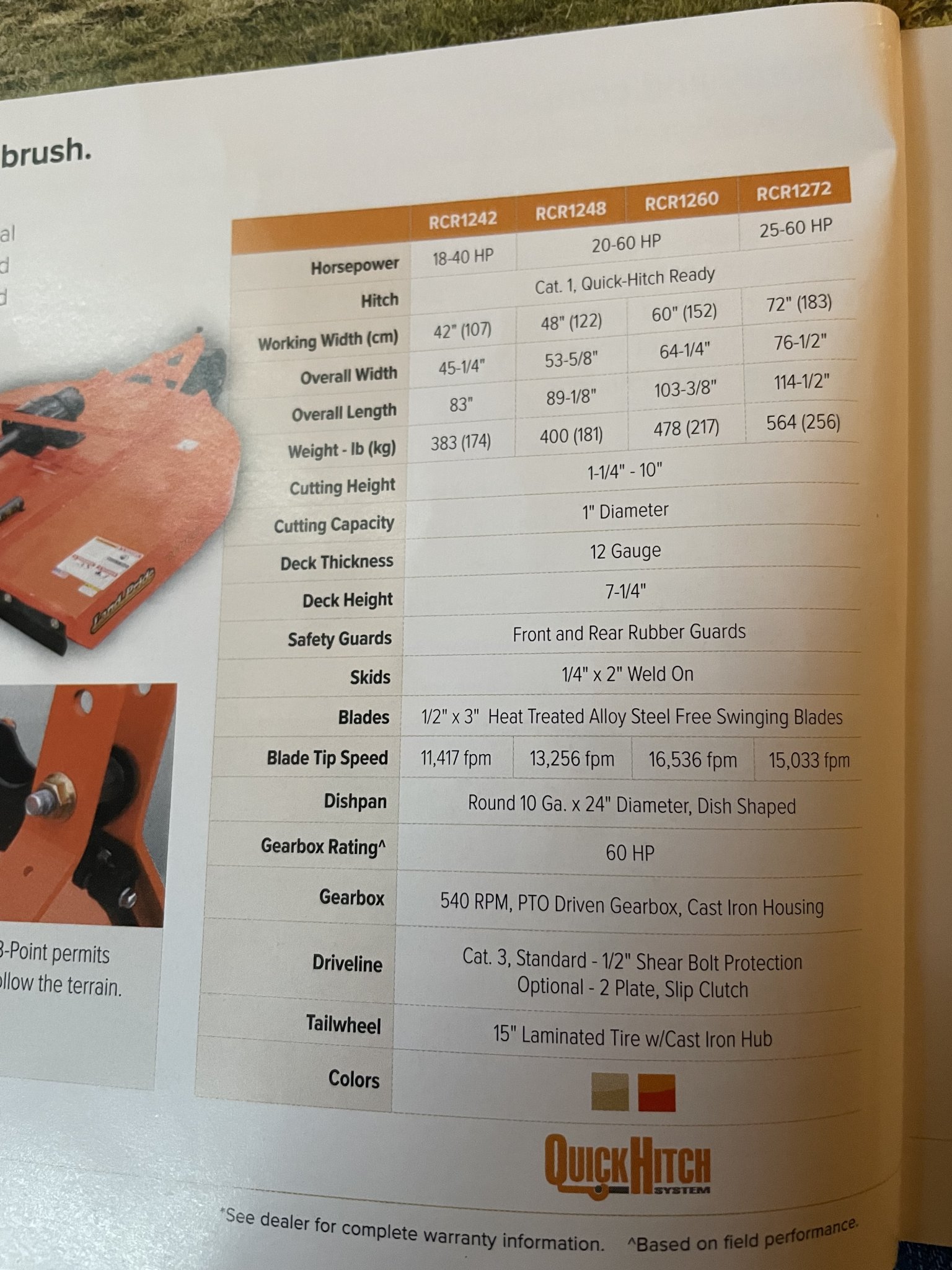

To your question…see below…this is a bit dated, so I’d also check LP website. Beyond the spec in the pic, I think your expectations will determine whether you will be satisfied or not.

I could see baling some of it down the road. Previous owners would cut 3' tall cedar and leave them in the field. Also some bigger ones that left sizeable stumps. Its been too dry to burn the last 3 years and I've been mowing portions well with a little B7500 and a 4' landpride. So I kind of think the 6' width is what I need to cover tracks and the specs seem to support it working with the L3560. I work there for mental therapy so mowing in low even is not a huge deal to me.
I'll probably go with the Land Pride, perhaps that TIMIC mower, or perhaps another brand but looking for one 6' wide. Those flail mowers look nice but not sure how they would do on mole hills, yuccas and perhaps some larger branches.

Id get the 1872 with slip clutch. The 6' will be all that tractor wants when hot.
