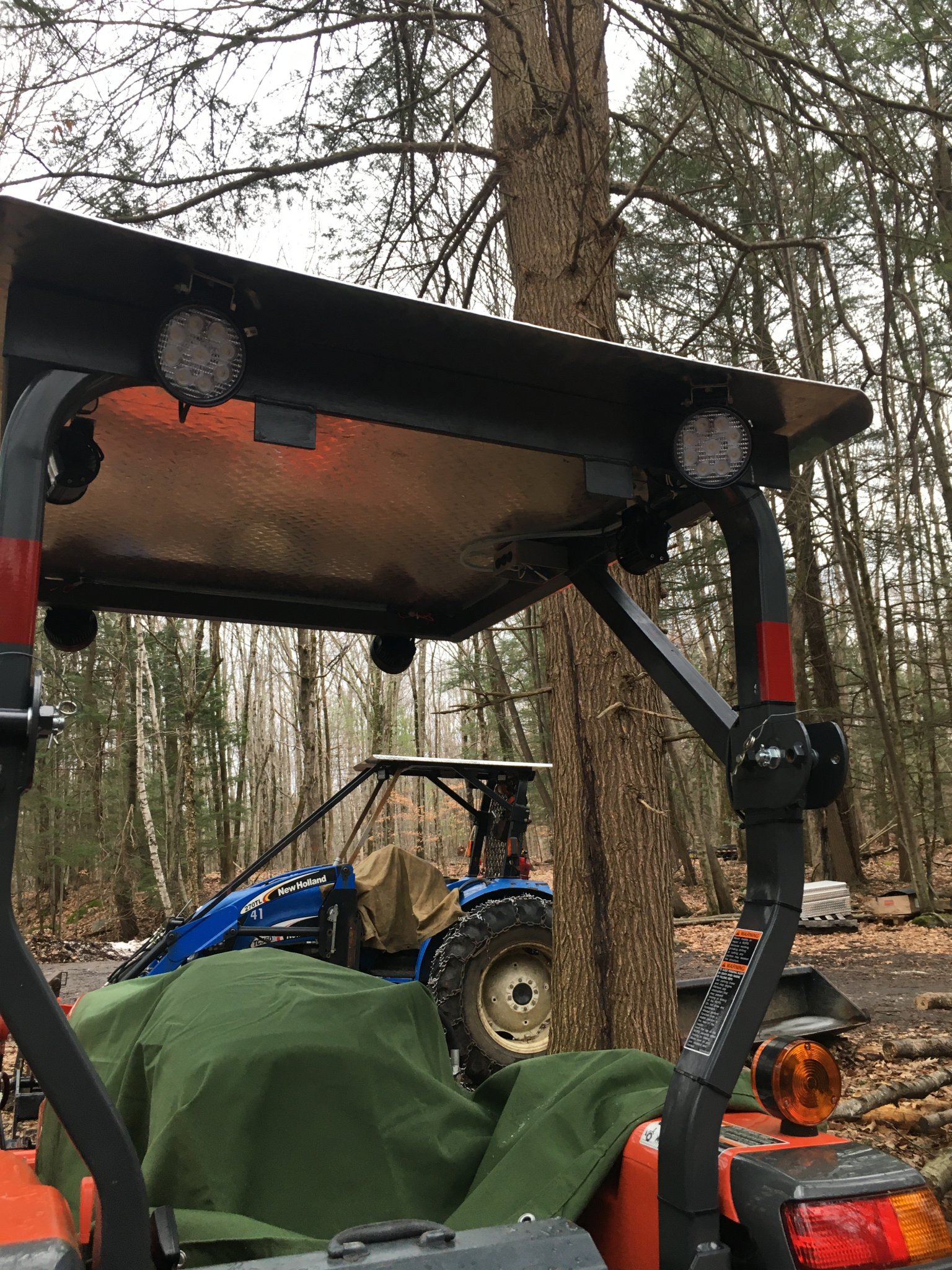

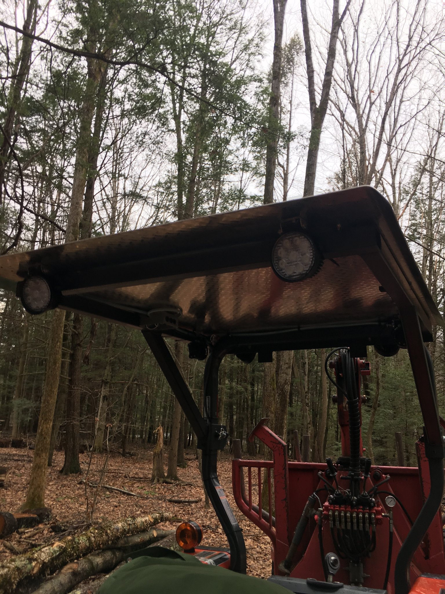

BUT....if you are envisioning a nicely hidden wire run internally etc. this is not the kit for you. These come pre wired, switch is sealed up well and ready to go.....all ready for external install with heavy zip ties etc.
Work amazing. I have run them blowing snow and it is like daylight, 2 front and 1 rear for the back blade.....
Highly recommend. These Canadians take their ROPS lights seriously.......

Also, this may seem obvious or simple but the Rear light comes labeled with a sticker "rear" so there is no guess work.
I did wrap my ROPS with black vinyl tape where I was mounting the bracket for additional "stickiness" and to keep from unnecessarily scratching the ROPS......

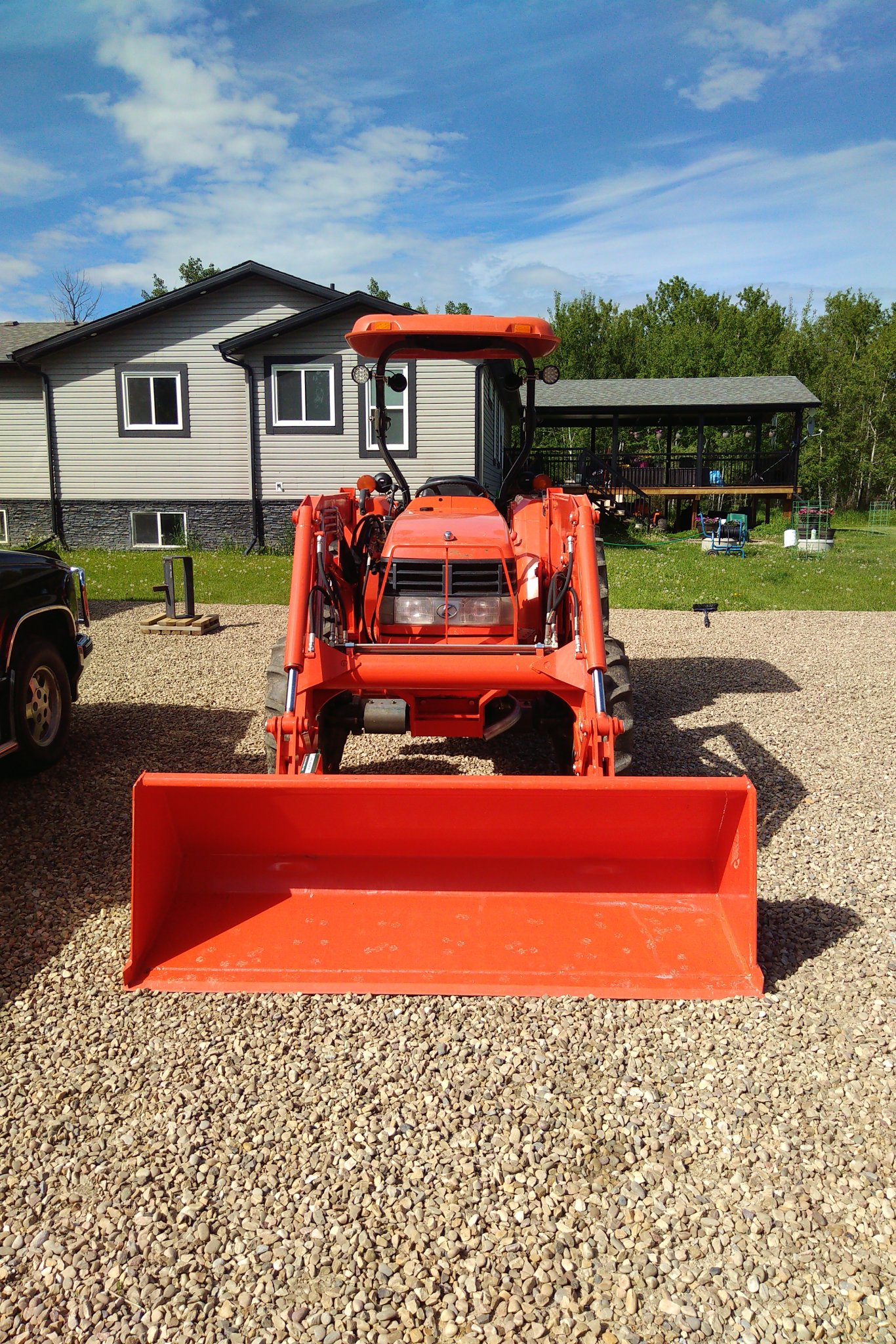

I have the 4 light setup on my MX. 2 front and 2 rear, each set on their own switch. They are plenty bright, and were complete plug and play. (My MX has a set of factory extra connectors under each fender). They came with plenty of extra harness that I rolled up and zip tied.
My only complaints are that the switch boxes are just cheap plastic that aren't weatherproof, and the toggle switches are the illuminated type but were not wired in so they light up. I called and talked to John? and he said they couldn't be wired in to illuminate???
