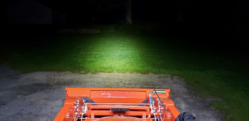

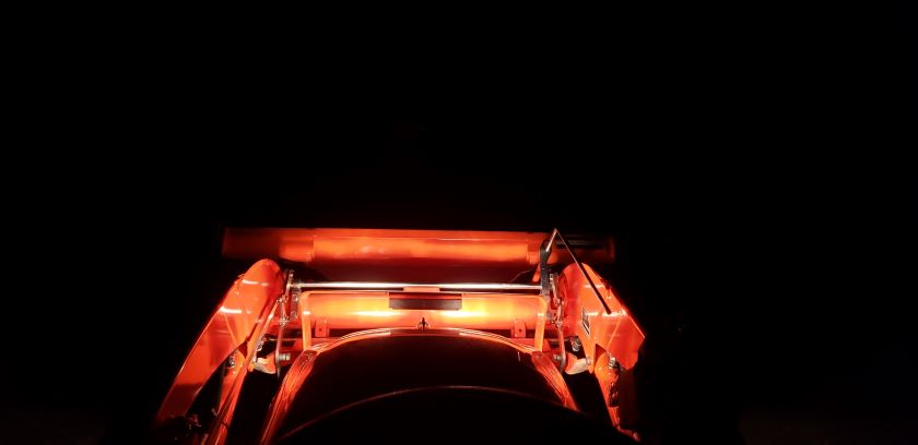

I have a ROPS mounted light bar pointing forward and two spots pointing backwards, one down towards the 3 pt. and one back about 10'. The bar lights up a nice wide area. Contrary to JT above I have the "cheap Amazon" lights, no leaks or condensate, three years so far, stored outside uncovered most of the summer. Inside in the winter.

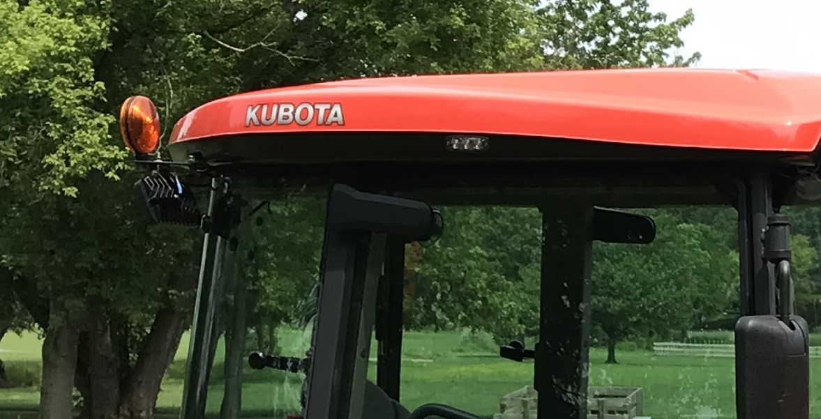

There are lots of threads on lighting. My preference is LED floods because you want to light wide nearby areas. Spots aren't useful on something that only travels 17MPH. Individual lights / pods can be aimed independently and that's an advantage over bars. I think some people go with light bars because they enjoy saying "light bar".
In recent years different programmable LED flashers have come along. They're available as domes, surface, flat and semi-flush mounts. Not wanting to add height to the cab, I used these flat little 3-LED guys on the perimeter of the L4240 Although they're small, the light is incredibly bright. At night the ones on the front and rear light up road signs at quite a distance and the ones on the sides light up houses along the road. The wiring is fished around the inside of the top.

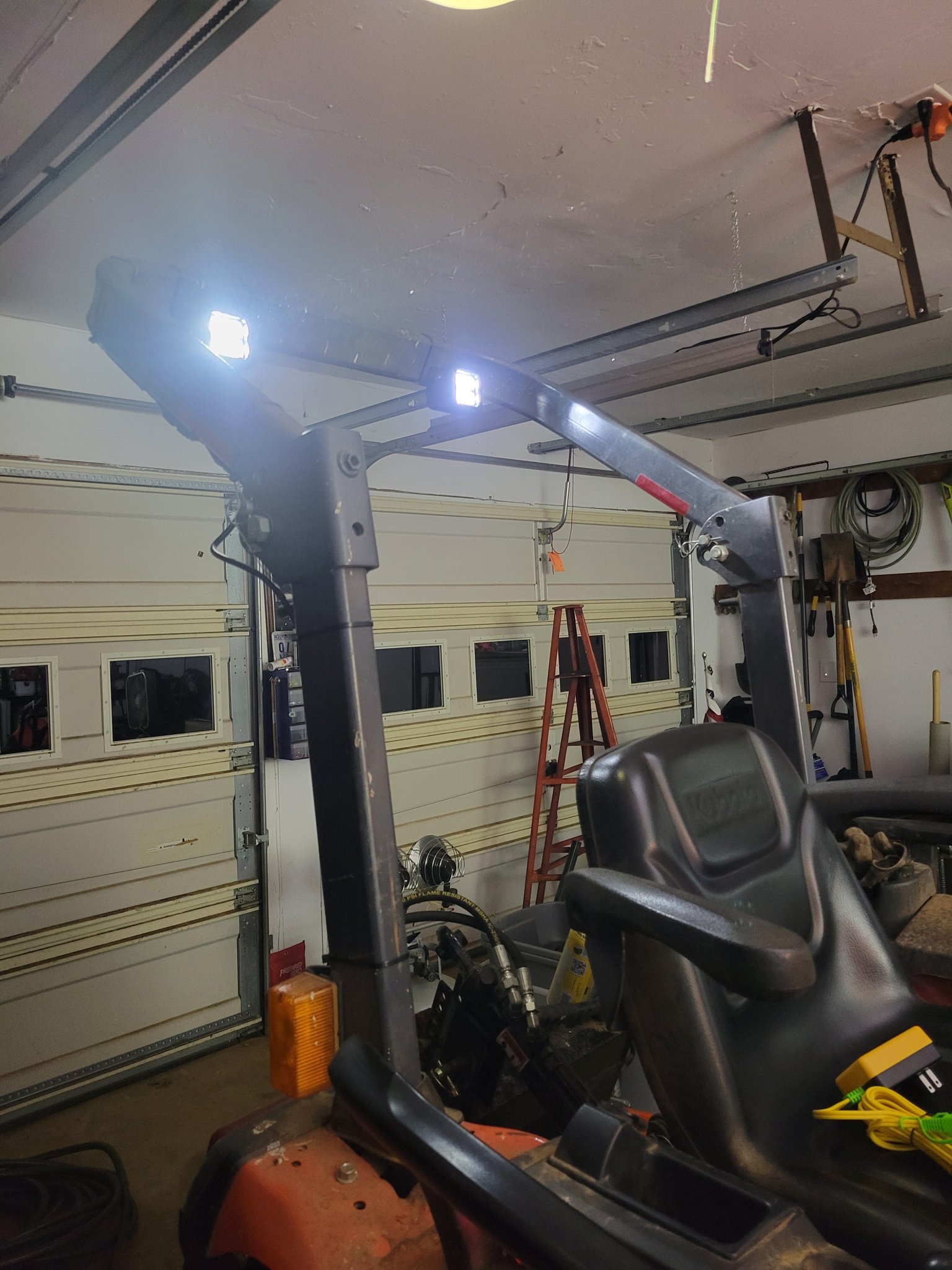

The forward facing flood is held to the underside of top the ROPS with two 50# magnets (also Amazon).
Each rear facing flood is bolted into existing holds on the sides of the ROPS.

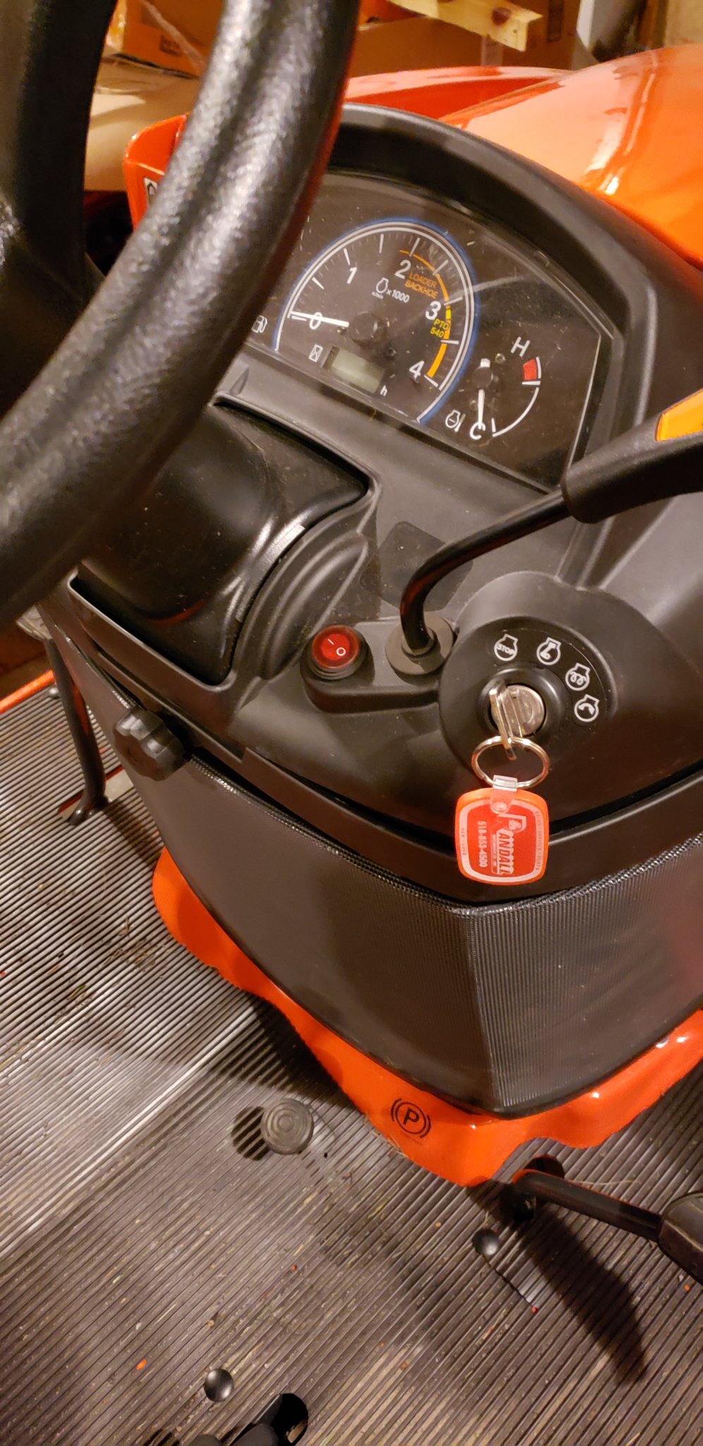

The wire harness is routed inside the ROPS, under the seat and chassis, to the battery. It's not wired through the key / relays at all so I have to be sure it's "Off" so I don't drain the battery.
The on/off button supplied with the wire harness fit right into the unused hole for the cruise control which the BX1880 does not have.

I used round rubber coated magnets with 1/4" male threads. I would have drilled a hole in the dash if I didn't have the hole already. The 30 lbs. one would probably work just fine.

I mounted two pods on my B2650 as shown. I used the pods because I had them from a Holley clearance sale from like 5 years ago. I mounted the switch on the outside of the right-hand storage bin. Out of the way and easy to wire. I also tied into the existing work light wiring for the power feed. I have used expensive light bars and cheap light bars. Honestly, where the market is now, unless I need on-demand scene lighting like in my municipal job, I'm going with an Amazon or Harbor Freight option. The quality is there for tractor use, and god forbid something happens, they are cheap and easy to replace or add on to.
