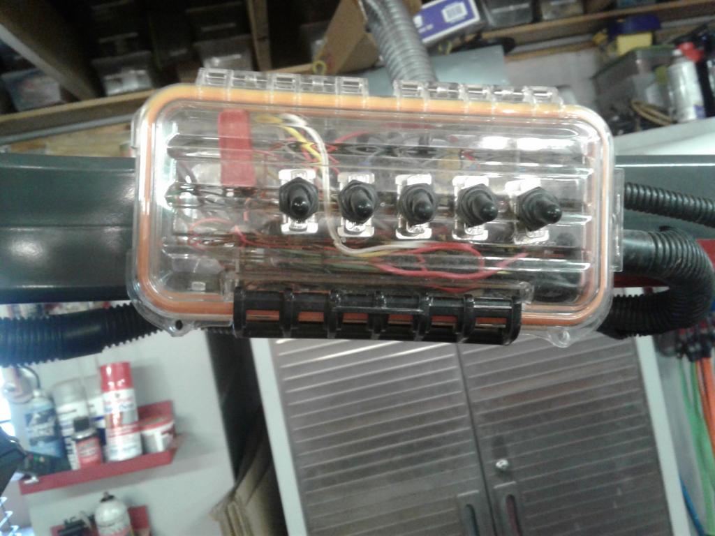

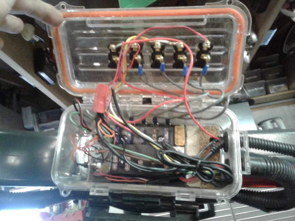

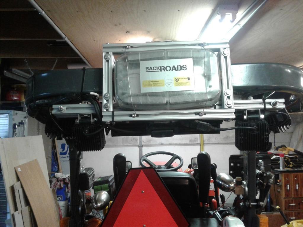

I purchased a power amp wiring kit from Walmart (replaced 80 amp fuse with 60 amp fuse) and used the 12v connector found on winches and electric pallet jacks (buy from fork lift dealer 3 connectors around $22, $21 each from superwinch reseller).
I used a 10 circuit fused power distribution block from NAPA and a watertight box. Using 5 circuits, other side holding spare fuses. Used watertight switches and the rubber boots.
Box has 2 mounting magnets from Harbor Freight. Water won't flow uphill, drill wiring access holes in the bottom
Built an Aluminum mount out of 80-20 extruded aluminum double sided tape and cork to protect ROPS paint job.
A cheap jumper cable with the same connector makes it easy to jump start tractor or car.

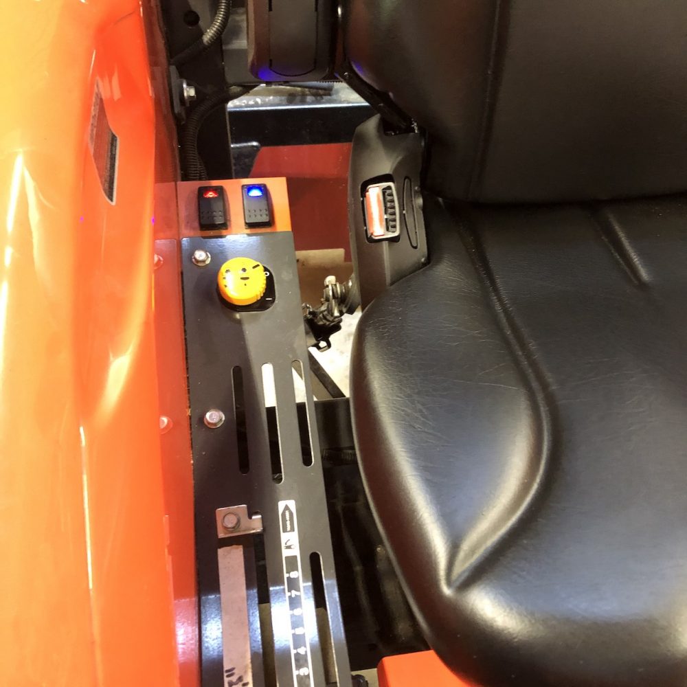

I put my ROPS light switches on the right side of the seat. Those are water-proof marine switches.
