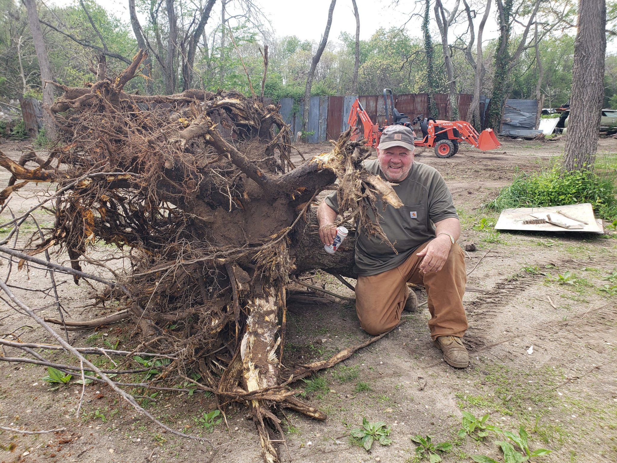

...With BX and B01 tractors lacking size and weight to rip out stumps with their backhoe any bigger than a large bush...
12" bucket on a B2601 can rip out stumps slightly larger than a bush, just takes a few movements around the stump. I've taken out quite a few already, this being the biggest. This one was the fifth I took out that day, all after lunch and before dinner. (Neighbor posing with the stump to show the size)
A "scissor" to cut the roots extending horizontally would be nice, but you'd still need the bucket to dig around and rip out the tap roots that extend vertically down underneath.
