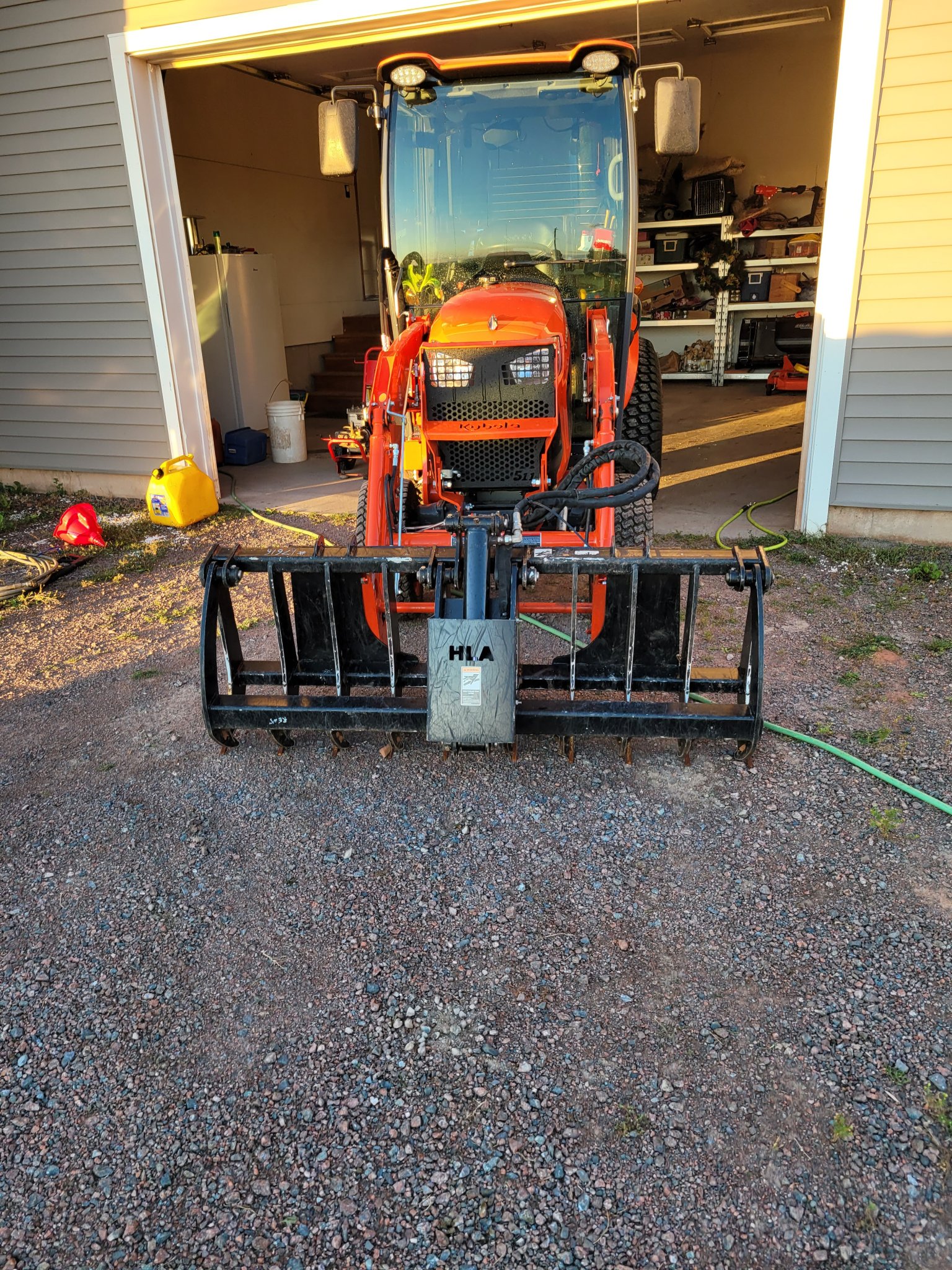

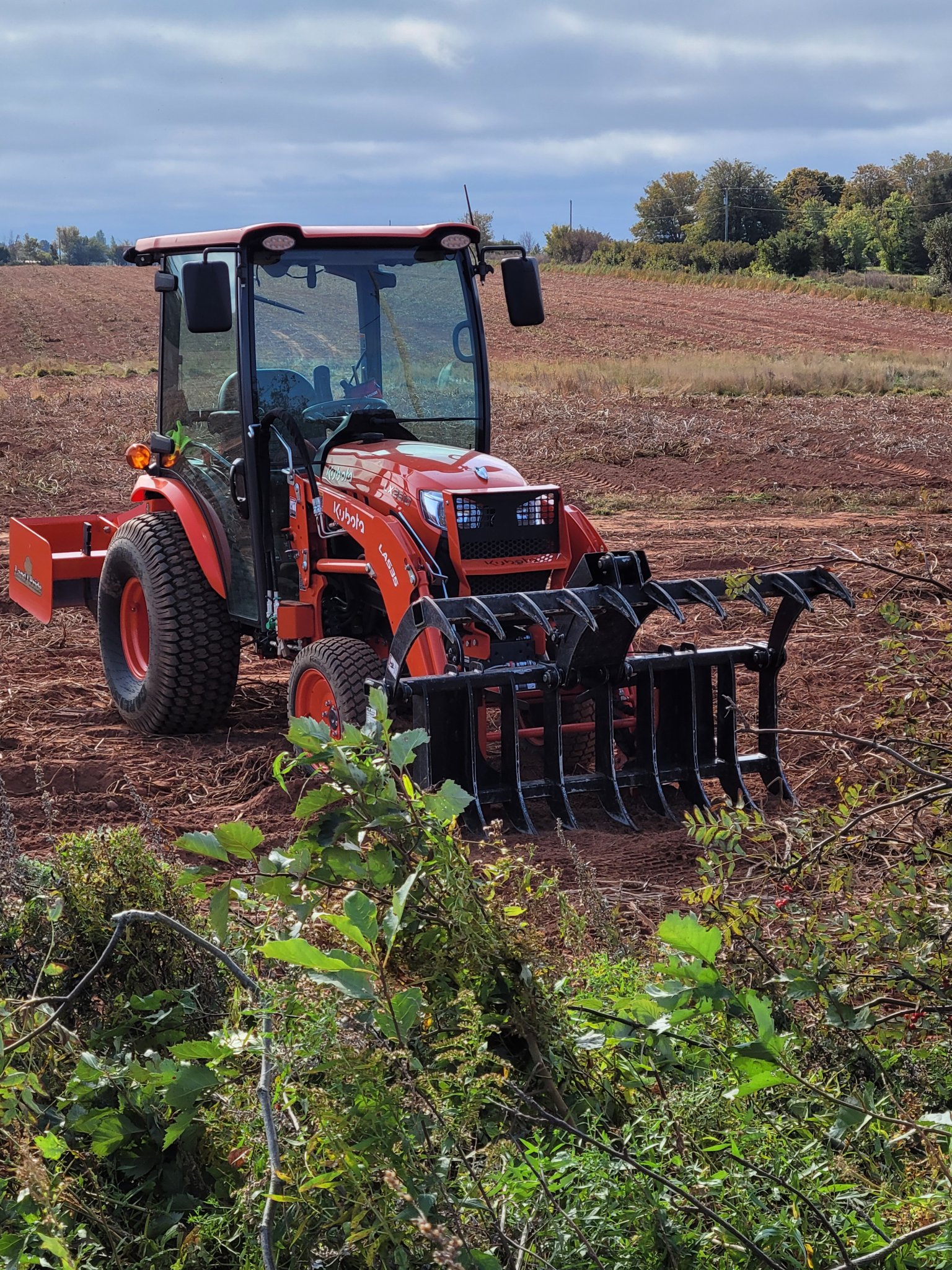

I have the same HLA grapple as GP but far different soil conditions. GP is on the Canadian shield with plenty of granite and he will push his gear to the max rooting boulders. I have sandy soil and shale. So far, using mine rooting and pushing trees over it's been unscathed.
If our dollar was stronger and shipping more reasonable I would of probably went with with a EA 55" to try it but buying direct from the States isn't economical.
