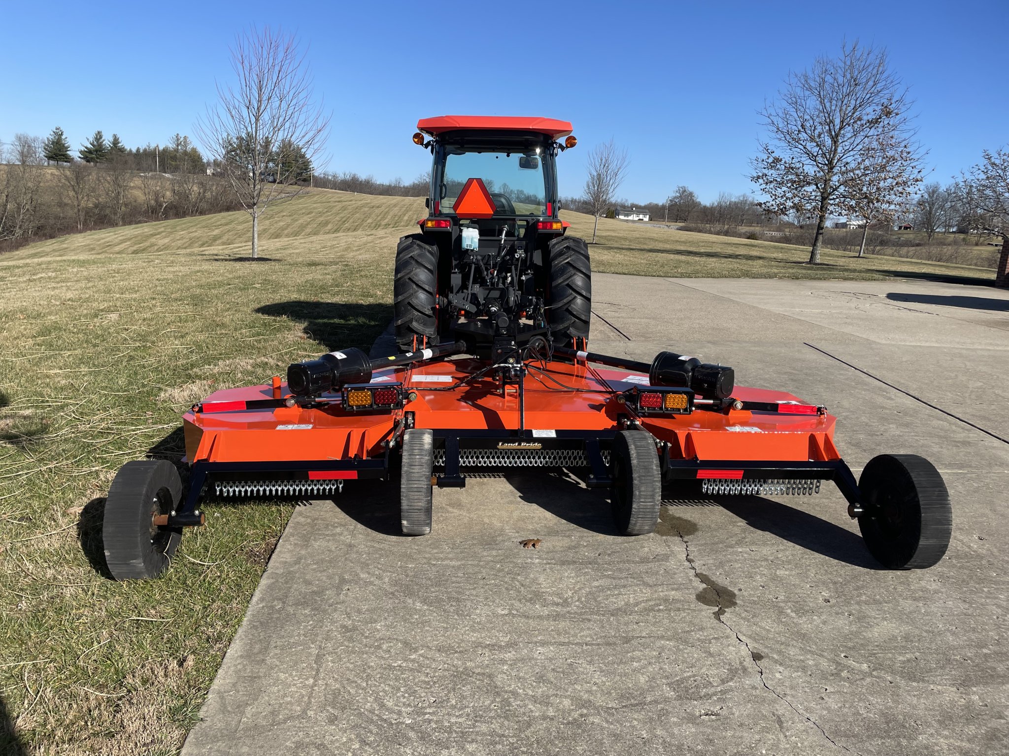

Here are a couple of pics. I’m excited to put it to work. Just didn’t want to end up in the trees at the bottom of one of my ridges I’d the tractor was under sized
Holy Moly! :love: That's one cool-looking setup and a very nice property. Given that the cutter is a little over 1/4 of the max weight rating for pulling on the drawbar, as listed in the owner's manual, I can't imagine you having any trouble at all.

The striped grass you see in the one photo is my main yard that I have large mower for. The stuff I’m bush hogging is the hills behind the unit in the photo that shows the basketball goal. It’s mostly grass, but not looking for a finished mow look necessarily
