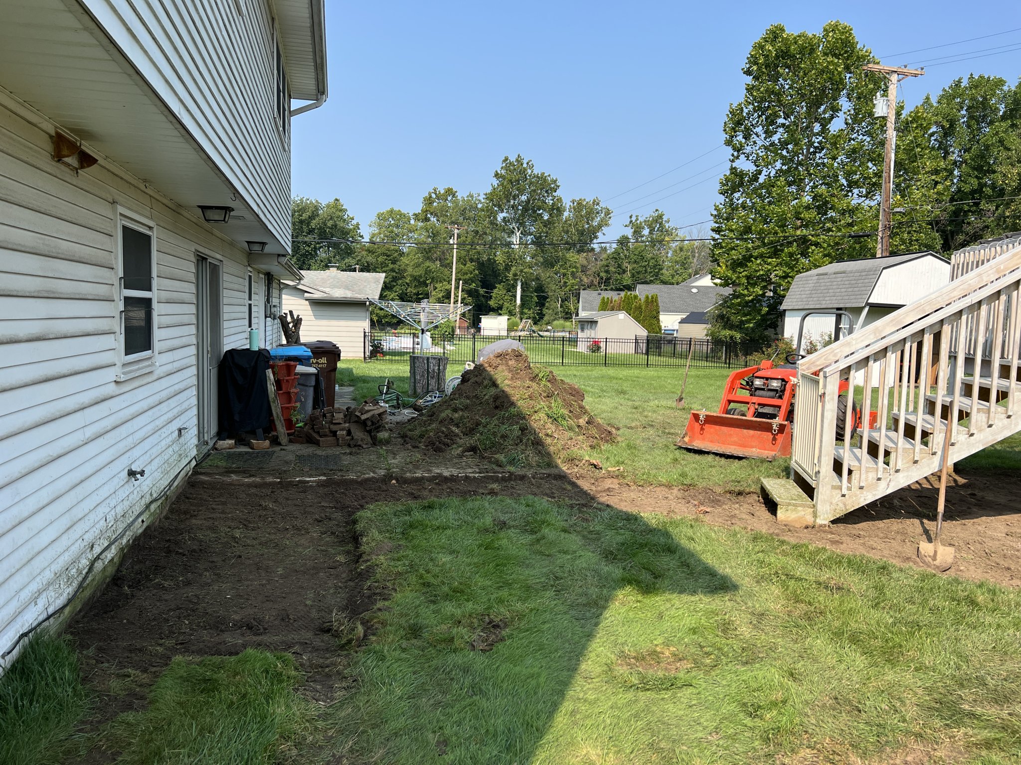

The MMM also sticks out the sides etc and gets in the way of some projects like the one below.

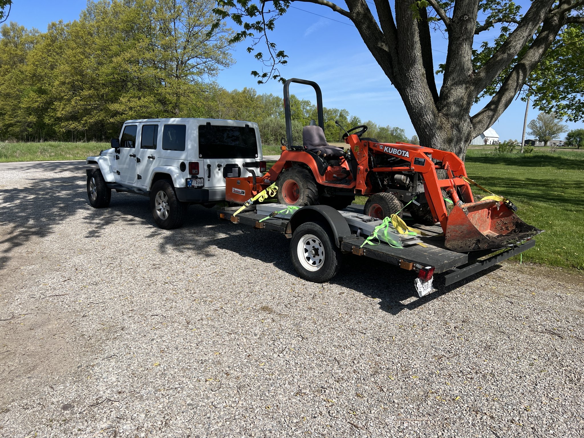

Loading on the trailer with my current setup would also be more difficult with the MMM due to the loading angle and the MMM hanging down
