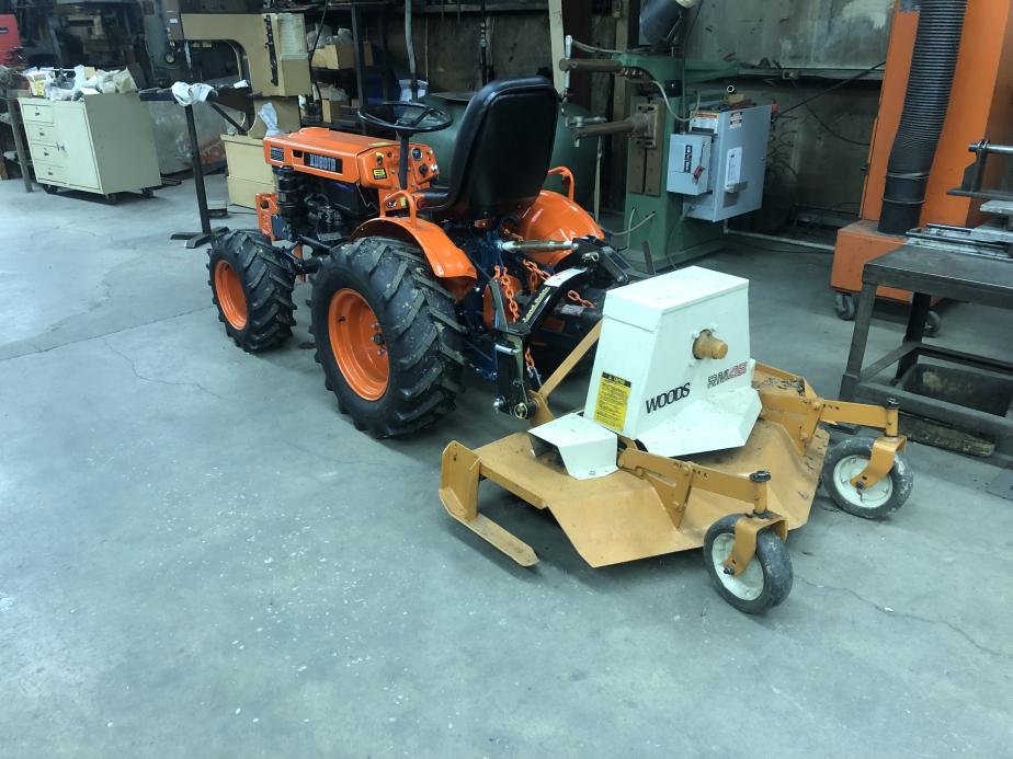

An RM48 or RM42 would be a better fit. My RM48 is about all mine can handle in high grass. I have a reverser but my B6000 I had in the 70's didn't. The reverse blades and spindles are available but a bit pricy. Check mine out.
