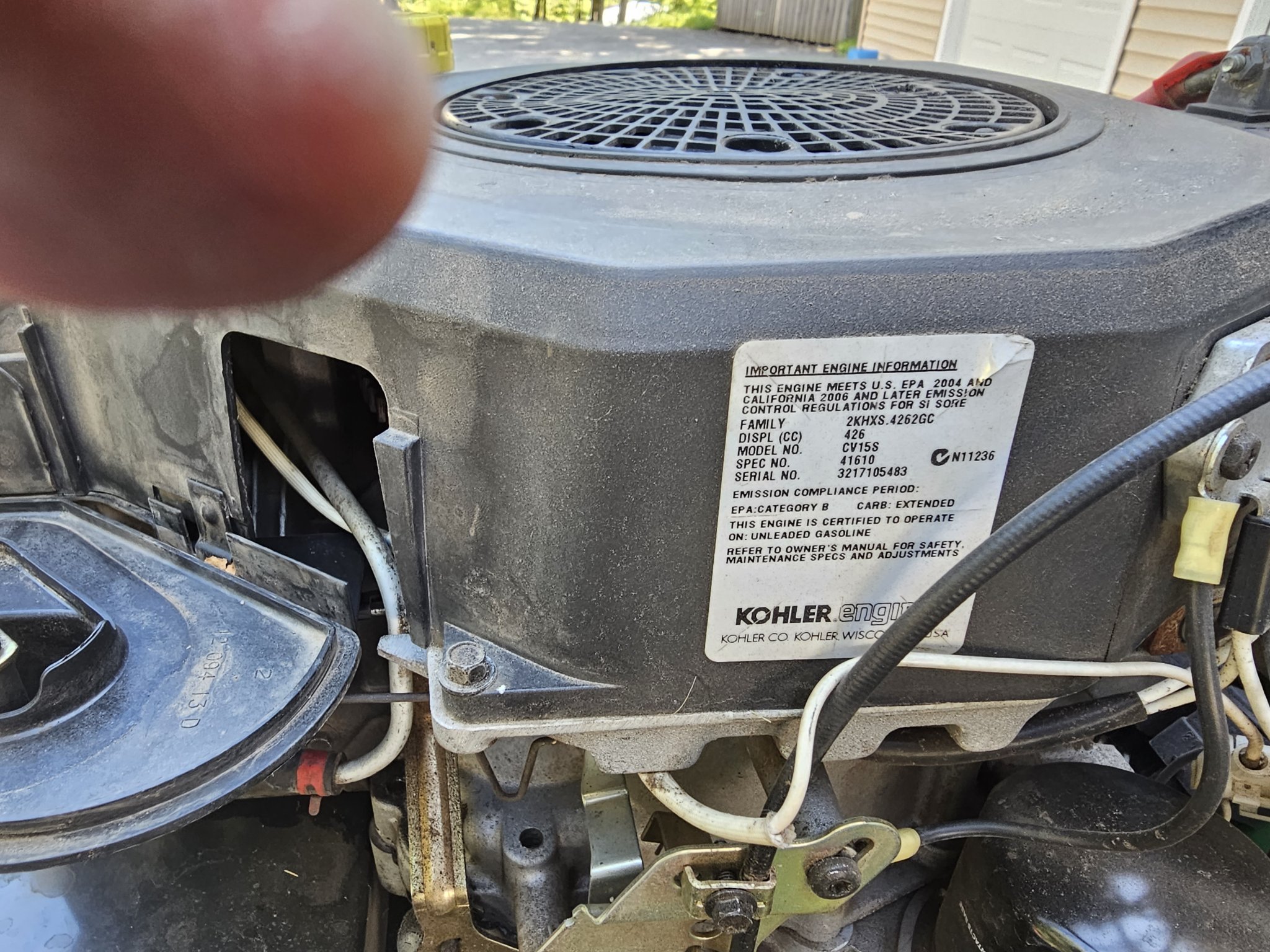

Saw a riding mower today beside the road for sale.
I have alot to bush hog
But not alot of lawn. Of course it was the wrong color. But the guy took $200. For it.
Said it just would not fire. I took it home. Hooked up the charger. Put in some gas. Cleaned the plug. Took off the carb bowl and wiped it out. Blew out the air filter.
There spark at the plug, gas came to the carb. It would back fire while trying to start it once in a while. But just wouldn't start.
So dropped it at our local Mennonite repair shop.
I know the basics. But this is beyond me.
He looked quick and said the factory Kohler carb had been replaced. But he would check it over. He said he liked that engine much better then the newer ones.
The serial number is
MOL 150B027240
I tried to look up the year on the JD site or other sites claiming serial number lookup.
But no luck for me.
Just looked at this engine tag. It mentions 2004 and 2006 , so possibly that old. I'm not sure.

I had a Kohler engine on a riding mower that was doing what you described. I finally found that the flywheel key had sheared and caused the engine to get out of time. It was a simple fix then (replaced key). Why it had sheared in the first place is beyond me. It ran great for years after that.

Yes, flywheel key may be sheared or 'mushed' enough to toss timing off, seen a few like that.
Other possible ... the 'anti-backfiring' solenoid on the bottom of the carb. The little rubber end will stick shut or just open a wee bit, can't get gas into carb bowl. Usual 'cheat' is to remove the rubber instead of buying a new solenoid at $130 !
when you get 'up and running' try to find and install a front bumper....

Sounds like timing to me.
Had the same thing happen on an l120 (Kohler engine). a 25¢ key and a half hour's work fixed it.

Just got a text from the repair guy.
He'll be going by on Friday and drop it off.
The bill is $192.
I haven't found out what the issue is yet.
But he was changing the oil, filter and air filter, plus checking the blades. And getting it running. He looked quick while I was there and said the carb wasn't a Kohler carburetor. He said the Kohler carb was a much better one then the one that was on it. So he said he might get a Kohler one.
But I'm thrill with a $192. Bill.
