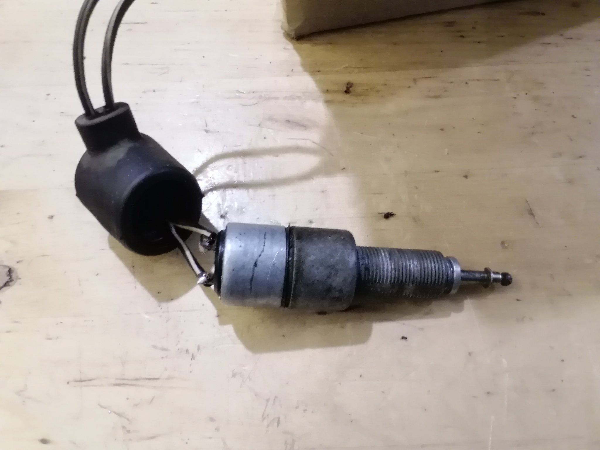

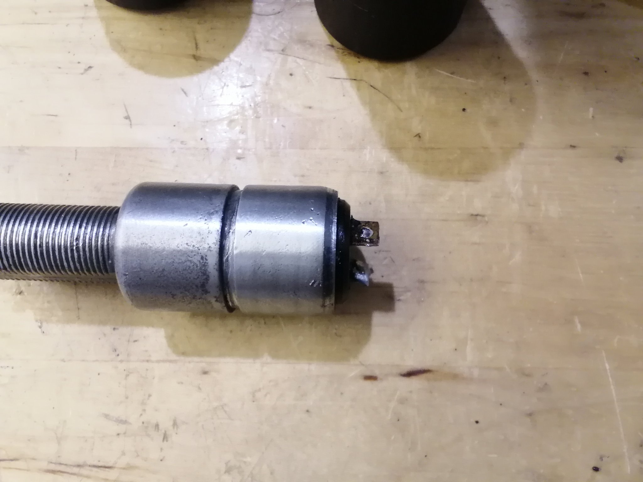

Brake switch repair
My brake switch was faulty and I had it bridged with a wire. I had bought switches but it turns out they are the wrong ones, the brake switch is normally closed and opens when pushed in.
It is always worth trying to repair things, you have nothing to loose and can't make it worse but you have the chance of fixing things.
I took the switch out, pulled the rubber gaiter from the back, removed the silicone potting compound and desoldered the wires. Then I removed the pressed in aluminium from the back on the lathe until the black lid popped out.
You can also use a small grinder or similar. After taking the top rubber off and removing the clip ring everything comes apart.
The plunger has an isolated part in the back with a copper ring. This ring is the contact together with the two contact springs. The spring in the middle is there to push the plunger back.
I polished the copper ring and the two contacts and cleaned up everything else.
Before pressing in the lid hold everything together and test the switch. It has to be closed when the plunger is out and it has to open when plunger is pushed in. Mine had contact now but due to the wear on the two contacts it hardly opened, so I inserted two small plastic washers between the metal and the plastic plunger. That worked perfectly now.
I made a little tool for pressing the housing together again, one with a conical shape (20 degree angle) and a cylindrical one as a slieve over the threaded part. The small spring is for holding the black plastic lid in place when pressing everything together.
I applied some lithium grease compatible with electric contacts on everything and put all parts back together. The press tool over it, into the vice, a bit of a squeeze and we have a nice pressed end again.
Now the cables soldered back on and acid free electronics silicone applied to the back.

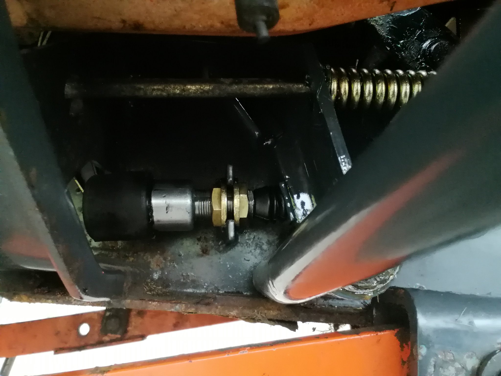

Push the rubber cap on and wipe off excess silicone squeezed out. I also added two washers because I did not like the thin nuts directly on the slotted sheet metal. Repaired and fully functional switch ready to go into the tractor.

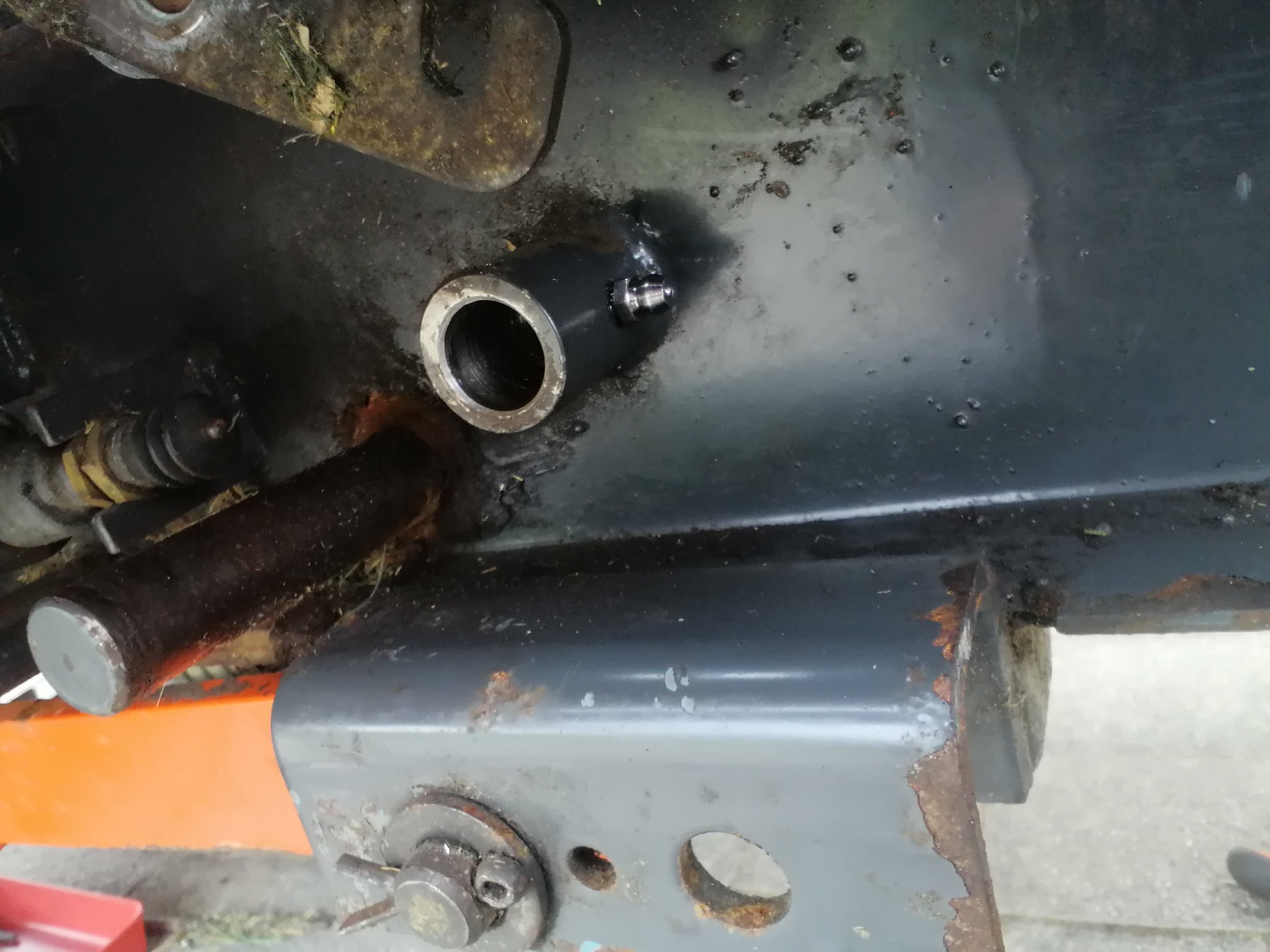

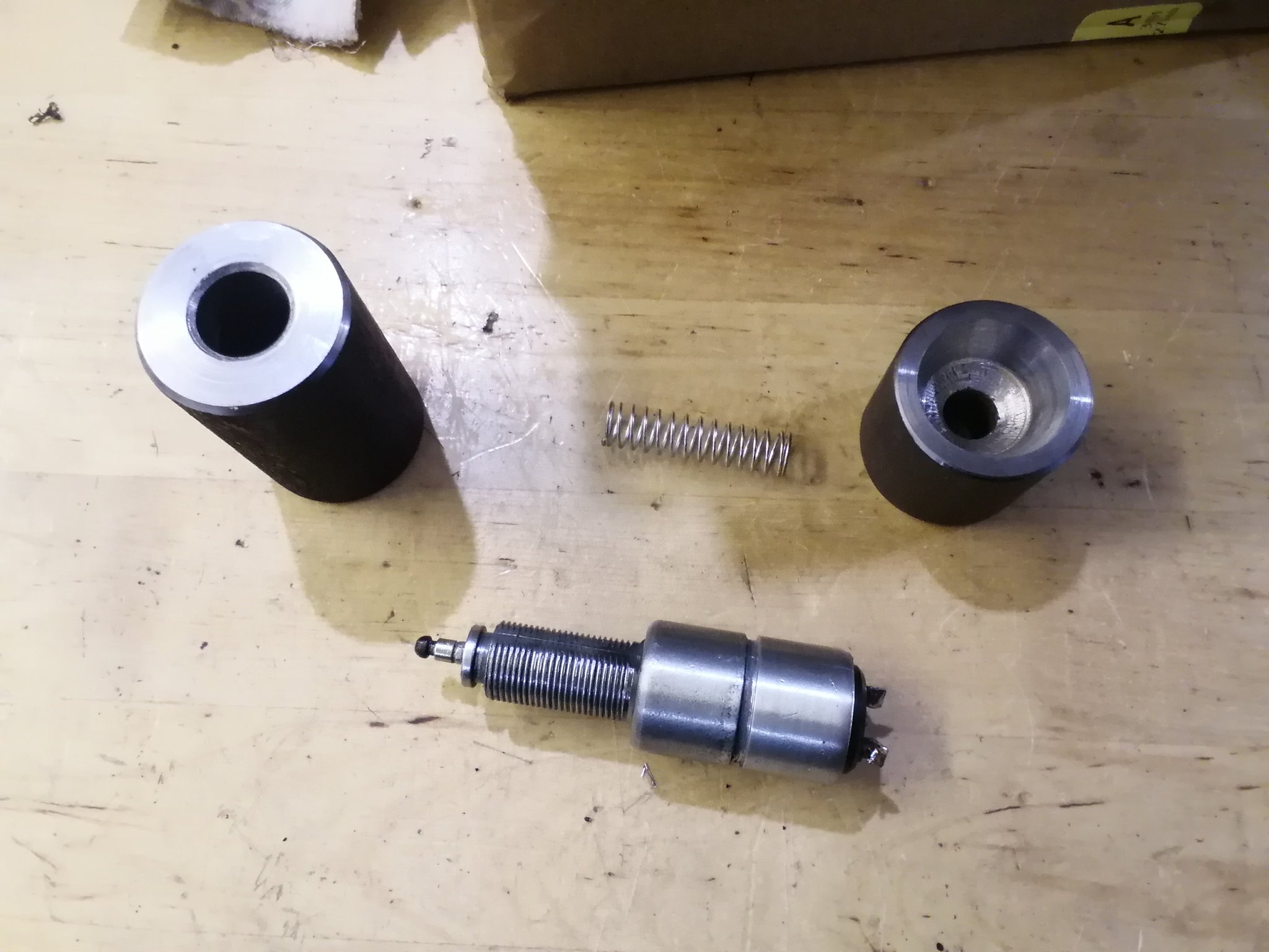

Speed and brake pedal

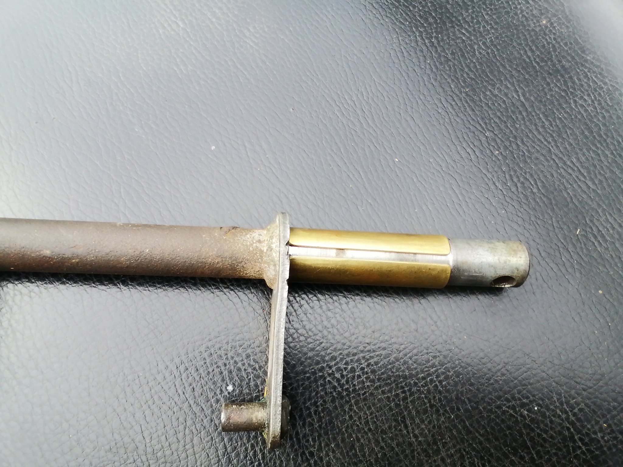

The speed pedal was all wobbly, the usual, lack of grease, hence rust and worn out. And the brake pedal had been crudely cut off, welded and bent to make it fit into a cabin at some stage.
I removed everything and machined down the speed pedal shaft inside the bearing part to 15mm. The outside for the arm I left at 16mm, otherwise I would have to modify the arm too.
I drilled the pipe to 17mm diameter and added a grease nipple that Kubota had forgotten in their design.
Now I made a slieve of 1mm brass sheet metal and pushed it over the diameter reduced part of the shaft.
Everything pushed in, pedal and arm attached again, a squeeze out of the grease gun and a bit of grease applied to all the linkages and springs and I have a nice play free speed pedal again.

Fitted the refurbished switch, adjusted it, greased everything including all linkages and I have a fine fully working brake pedal again.

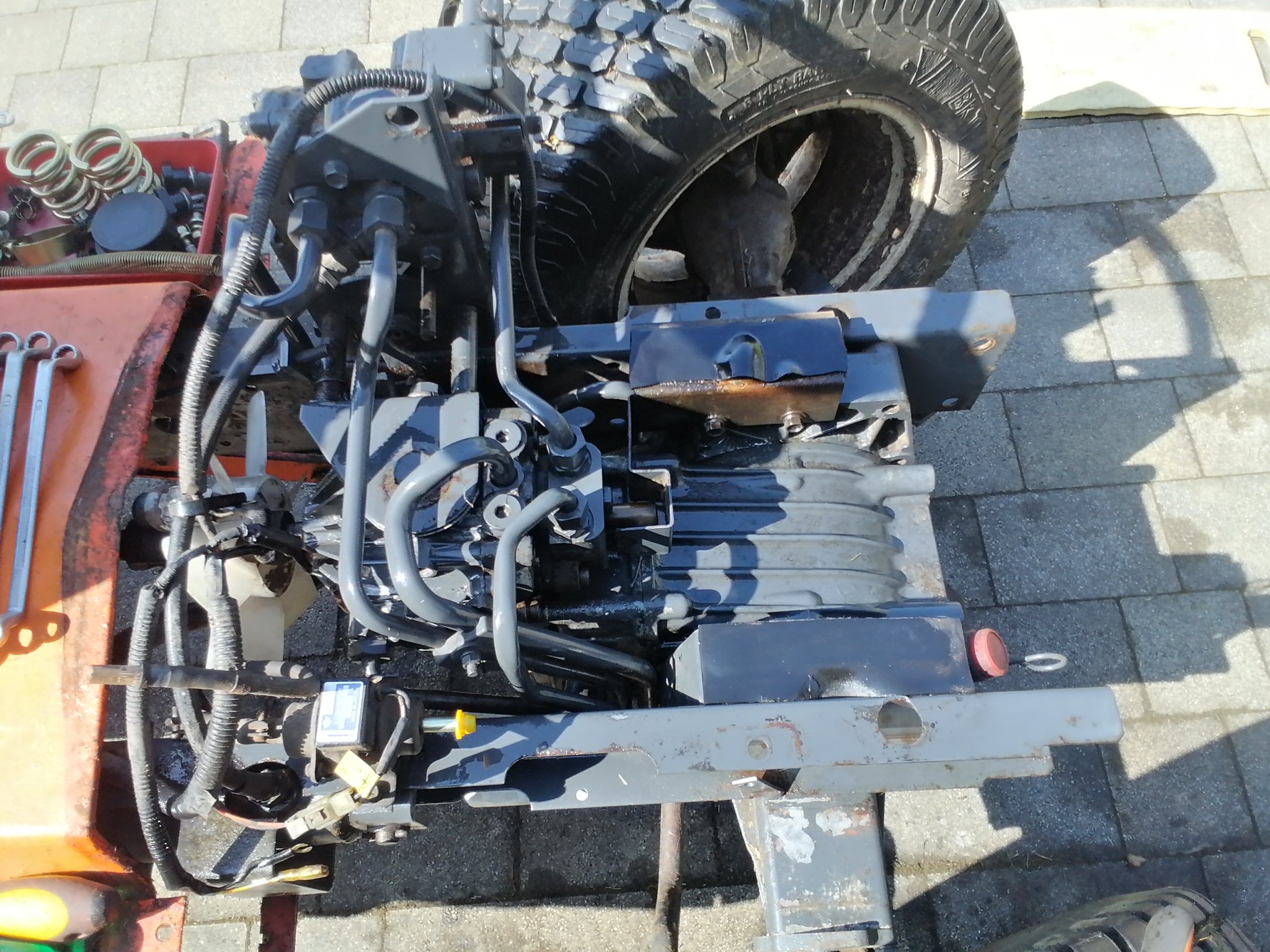

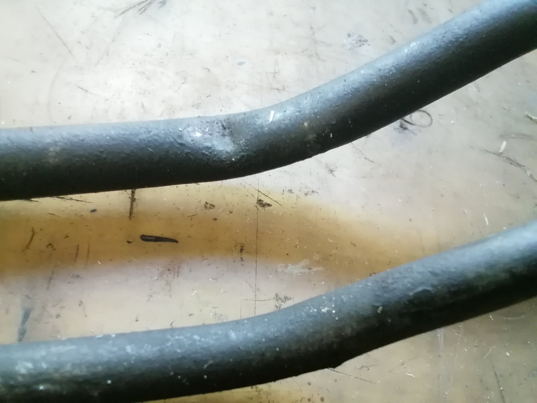

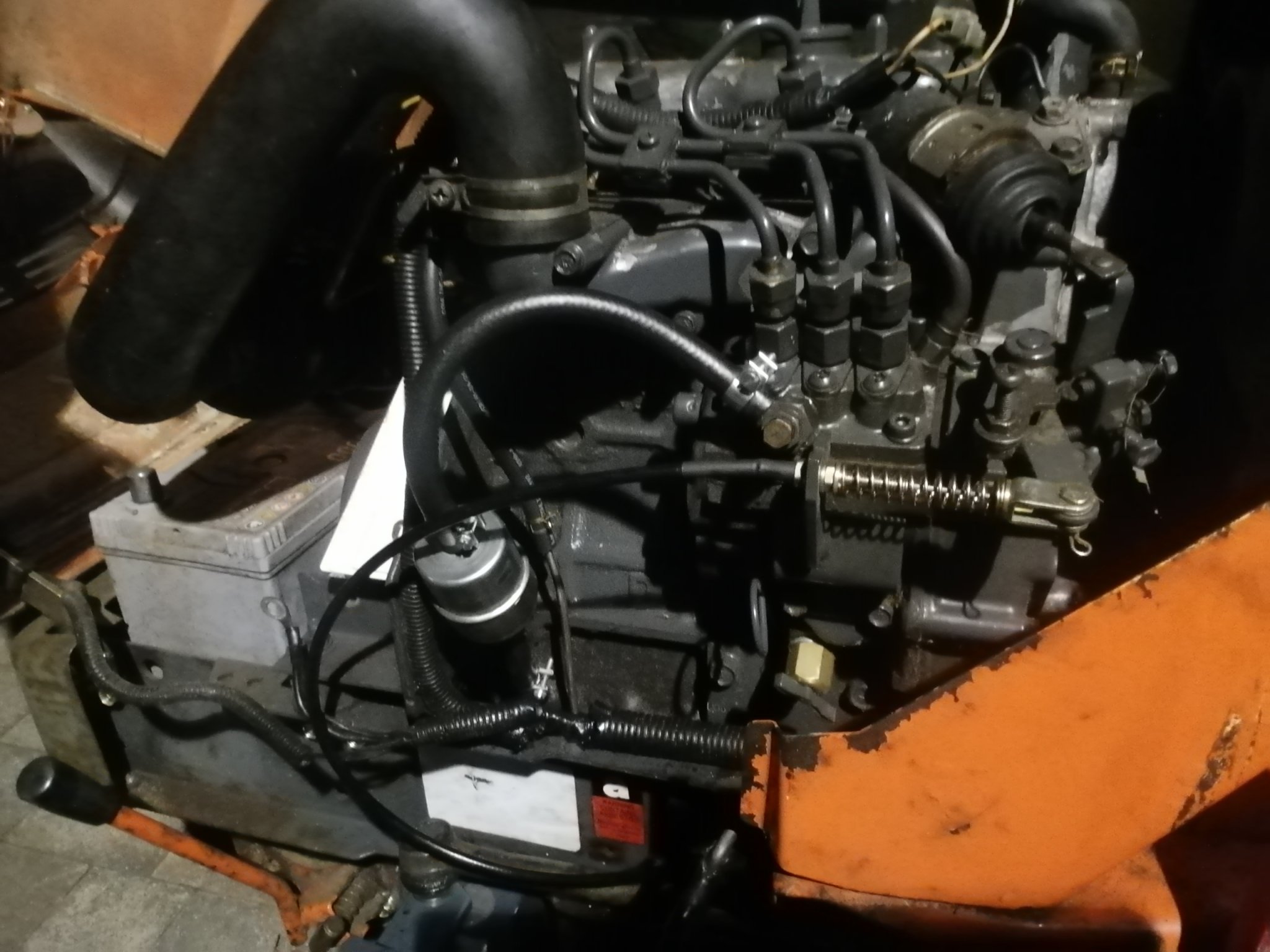

Fuel lines

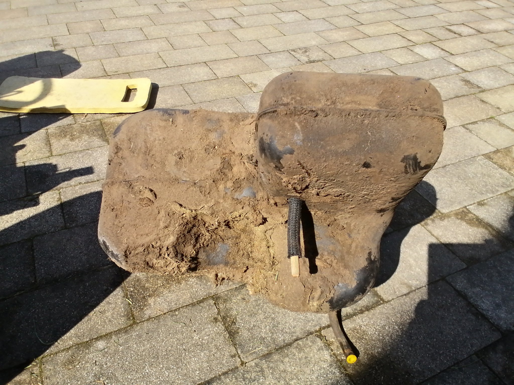

When I first looked at the tractor I had noticed that the fuel pipes were kinked, squeezed, to about half the cross section. I wanted to replace those. And while I am at it I may as well replace all the fuel hoses too.
First I drained the tank and then took the seat and fender off. Dirt collected over 30 years greeted me. Yikes !
Cleaned that up a bit.
Then I took the fuel pipes and hoses out. Here you can see the kink. Don't know how anybody managed to do that, they are well protected by the frame.

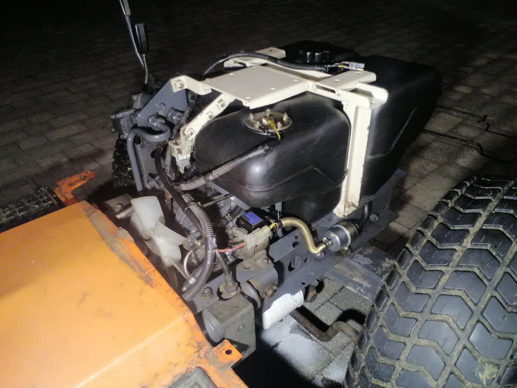

I made new pipes from Cunifer with the holders made of brass soldered on.
Everything back in.
The minus contact of the battery cable wasn't very healthy, it could not be tightened any more, so I made a new one.
Took much longer than I would have thought but nevertheless a successful day :)

the kinked return pipe is normal, a lot of them had it. I think it was probably manufacturing "defect" which didn't cause any problems, other than our OCD hating it.
Interesting that you saw more of those kinks.
I have seen reductions or wider parts as a damping mechanism in Diesel fuel lines but I do not think that this is intentional. It looks to me as if something hit the pipes and pushed them onto the frame, the forward pipe has another kink on the outside too, see pictures. I could not see anything that could have caused that, but the cutting deck is off. Kubota offered a "Mower swing stopper" option, maybe that has to do with the fuel lines being hit by the deck.

those are the exact kinks I saw on a lot of them. Pretty sure they did it at the factory, maybe while installing the engine to the frame. dunno, but it was quite common to see those. I don't remember taking a new one apart enough to note it, but some of them back in the 1990's had under 100 hours and I did indeed notice it on those as well, going off of memory.
I thought about making all new steel fuel lines on my old one but decided it was getting too close to mowing season and (2) it didn't hurt anything. So I reassembled the mower after winter service and sent it back to dad. Winter service, I pull the fenders off for cleaning and inspection every year. Good thing to do. This past winter I found a couple fuel leaks and an oil leak on mom's current 1800; she didn't know about them apparently but I went ahead and fixed them. Easy enough to do, before it swarms in the middle of mowing season when I get real busy at the shop. She's already had to mow her yard 3 times, and from mid may through late july, it'll be twiced a week. Oddly, though, those old mowers don't use much fuel, so she can run ALL season on a tank of fuel. That's the ONE thing I miss about my g1900. The ZG127 cuts better and a little faster, but in comparison it DRINKS fuel. 4-5 tanks a season usually.

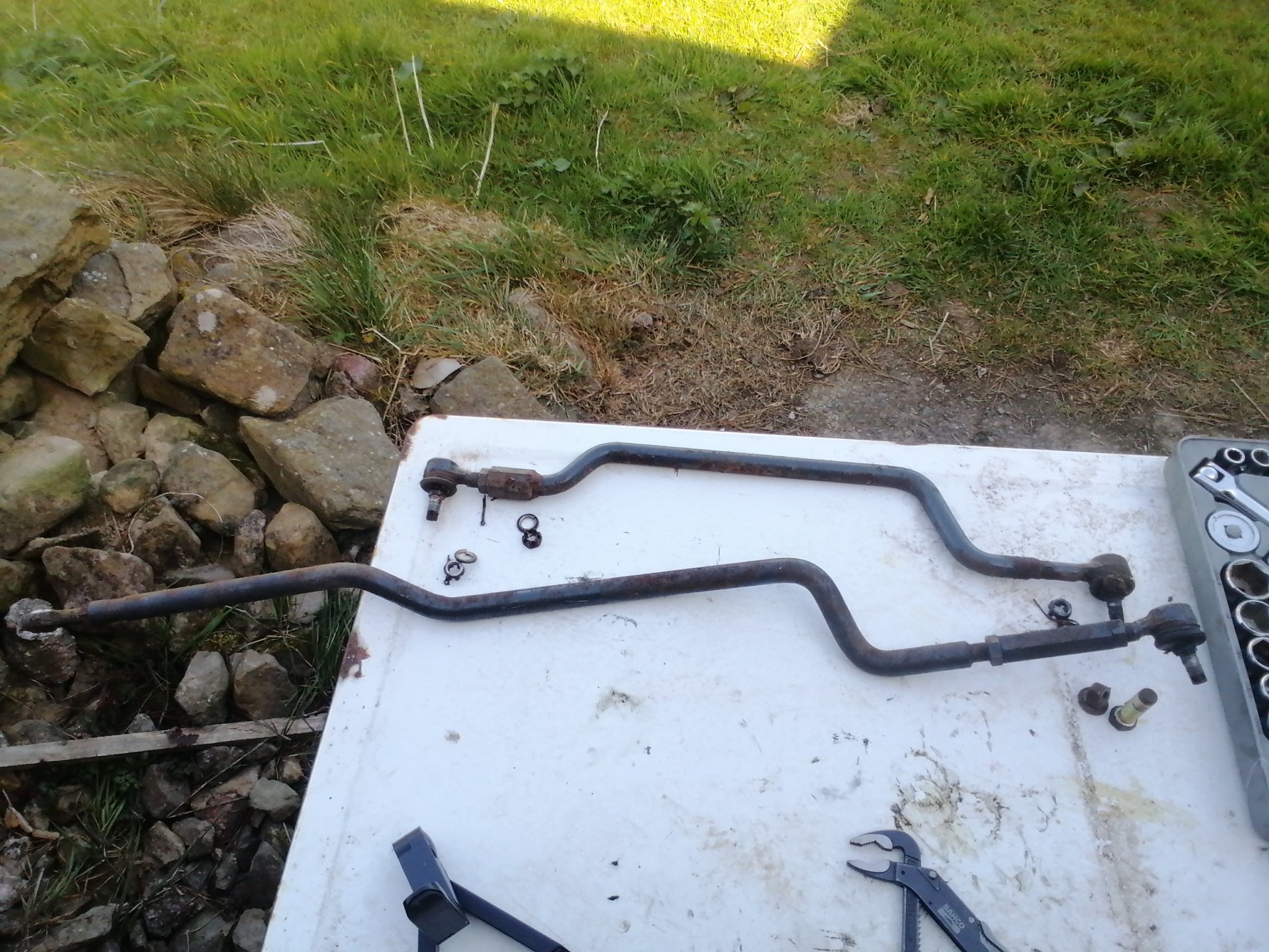

Rear wheel steering linkage ball joints (rod ties)
I have the rear axle steering apart because I had to do something about the appearance of the rims (spreading muck on the freshly painted front wheels as somebody suggested here was not really an option :giggle:) and the excessive play and possibly increasing damage was a concern. So all the linkages are out.
The steering linkage ball joints were fairly good but not tight any more and one had a bit of play, about 1/10mm (0.004"). The parts seem not available any more and one is welded into the tracking bar, so potentially expensive. The threads are M16x1.5 on the bar side and M12x1.25 on the ball side.
I always wondered how those ball joints are being manufactured but could not find anything. Millions of the same videos explaining how to change a ball joint cluttering up the search results. Any hints in that direction would be appreciated.
So I thought squeezing the whole thing a bit may be suitable to reduce the play or make it tighter. So I made two little tools, one slieve for the top and one sitting inside the recessed part at the bottom.
Into the press and slowly increasing the pressure I got a really nice tight and play free fit again. It took only from 2 to 2.5 tons of pressure.
Selecting two suitable nuts from a socket set and a vice should produce the same result I believe.
Another small step towards a precise steering.

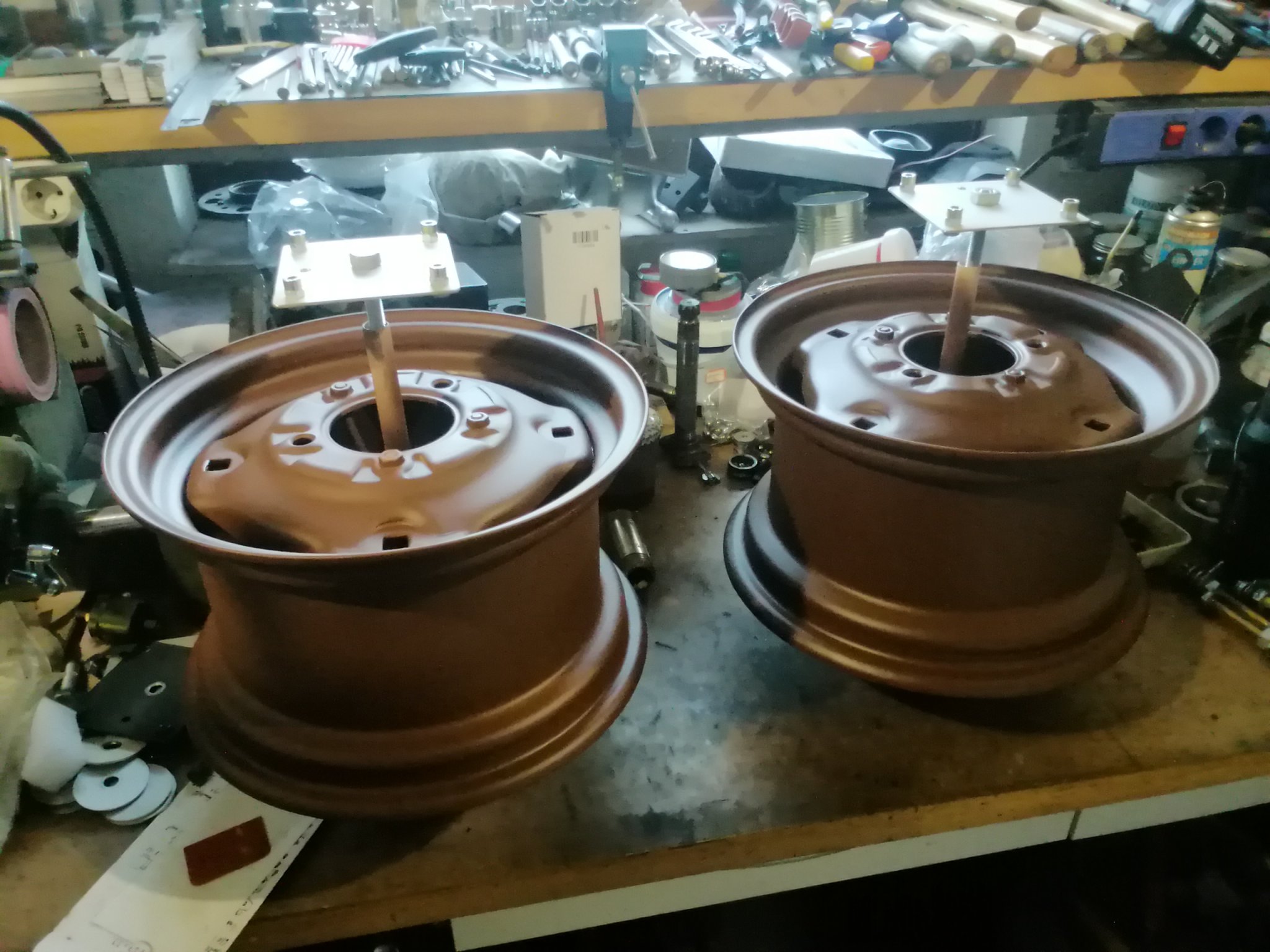

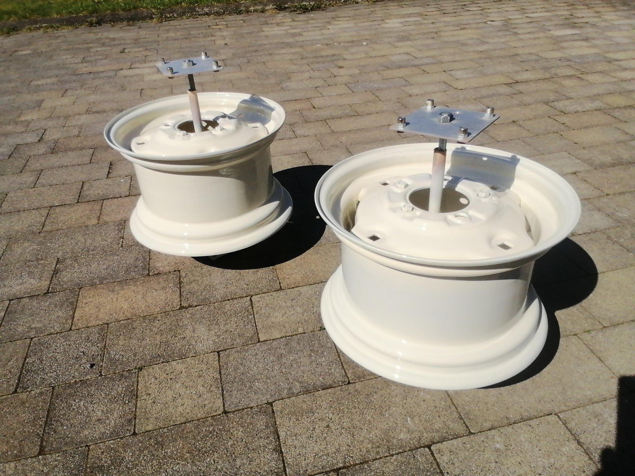

Rear wheels

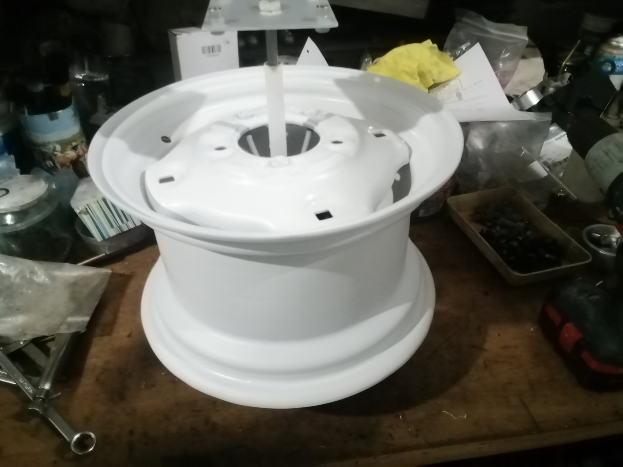

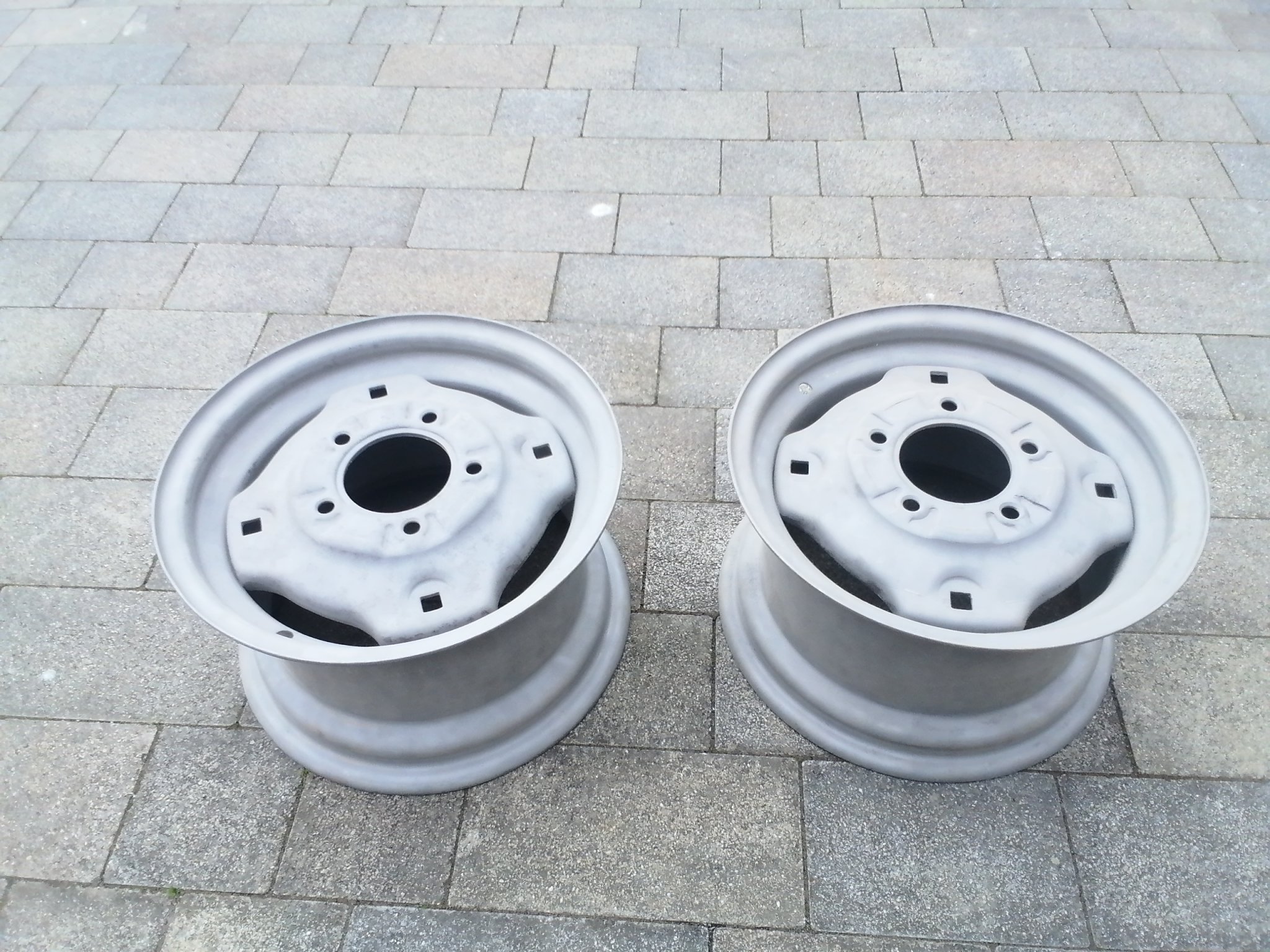

After doing the front wheels, the rear wheels looked really shabby and were very rusty.
Taking the tyres off both had tubes in them, as expected. Straightening the dented edges first. Then the usual corrosion treatment with CSD disk, sandblasting, phosphoric acid.
Then two thin coats of epoxy primer for 60-80um total thickness. This time with different colouring in it. For the front wheels the dealer had omitted to add the colour pigments, so I was basically spraying clearcoat which was, well, challenging :) I had to use a bit of filler for the pitted inside of the rims. Not visible from the outside but I do not want to see an uneven surface when lying under the tractor. :)
And then the top coat.
I have some runners, not really visible but may take them off at some stage. A good excuse to buy one of those nifty blades to remove them. What did a friend on mine say: "Professional spray painters also get runners. The difference to the amateur is that they know how to remove them." :ROFLMAO:

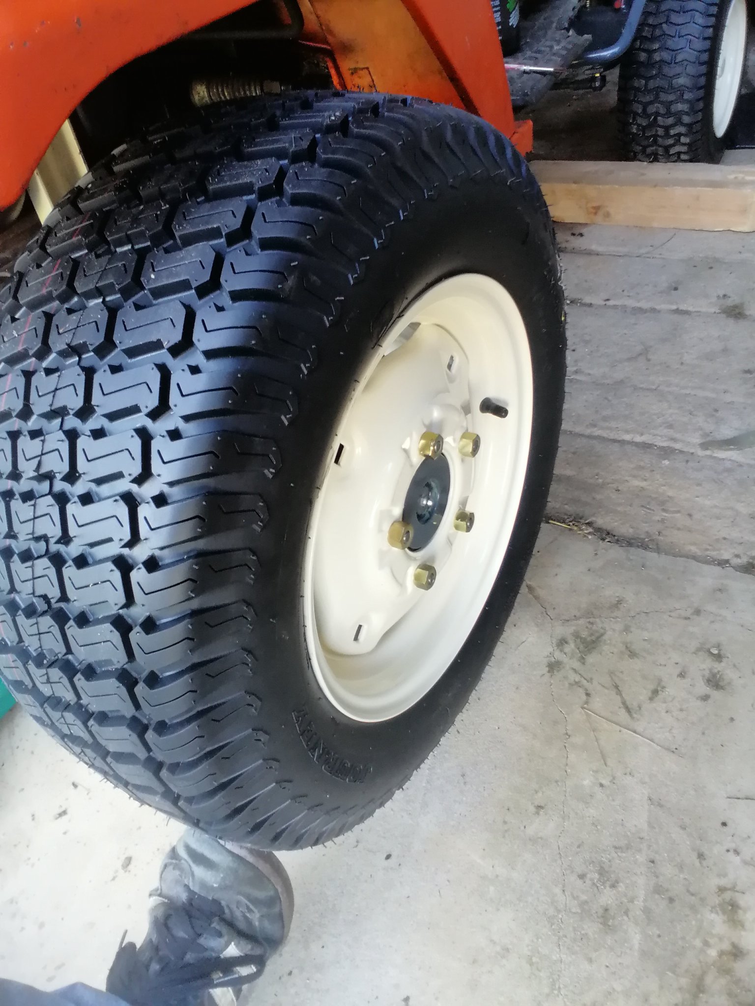

One tyre was cracked already but the other was fine, so I had ordered only one replacement. Taking the tyres off on the tyre mounting machine I damaged one of the tyres and of course, applying Murphys law, it was the good tyre. So had to order another one and paid shipping cost again. So I paid shipping cost twice, normally when you order two tyres shipping is free... At least I have two new tyres now.
New valves, fitting the tyres was a doodle (you learn from mistakes) and I have nice new rear wheels.

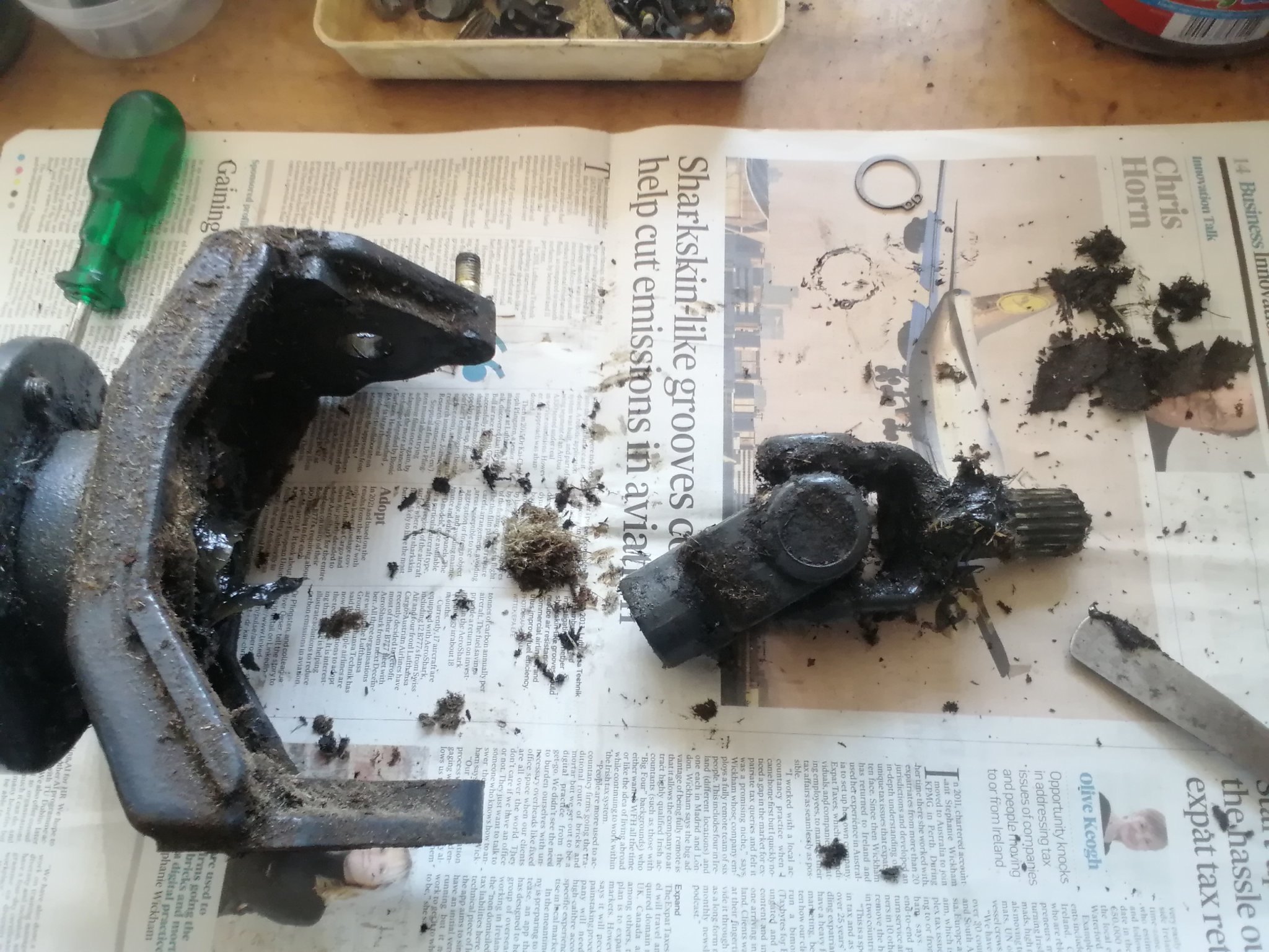

Rear wheel steering disassembly (continued)

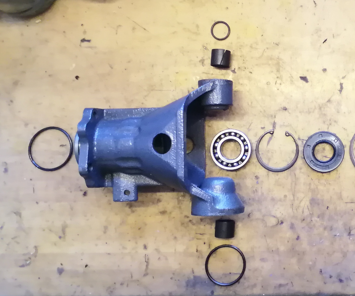

If we dig away about half an inch of grease and dirt outside the wheel hub we will find a small clip ring holding the u-joint. Remove that clip ring (goggles!) and pull out the u-joint.
Remove the clip ring on the inside holding the wheel hub and pull put same. Clean away the grease and dirt of the past 200 years.
Remove the large clip rings in the axle support (goggles !!!) and take out the wheel bearings.
On the king pin support remove the thrust bearing at the bottom (if still in there), remove the plastic bushings top and bottom and the two o-rings top and bottom and the o-ring to the rear axle.
To remove the rear drive shaft bearing the seal ring has to be removed. I used a puller tool for that but it may be possible to use hooks or screw drivers, the seal ring typically is destroyed taking it out anyway.
Now we can remove the clip ring and pull put the bearing.
Now we clean all parts and have them lying in front of us.
From left to right:
- drive u-joint
- clip ring wheel bearing
- wheel bearings
- axle support
- king pin (above)
- knuckle arm (below)
- clip ring wheel hub
- wheel hub
- clip ring u-joint
And the king pin support.
From left to right:
- seal o-ring axle
- king pin support
- king pin bushing (above)
- seal o-ring (above)
- knuckle arm bushing (below)
- thrust bearing (below, not shown)
- seal o-ring (below)
- rear drive shaft bearing
- clip ring bearing
- drive shaft seal ring
