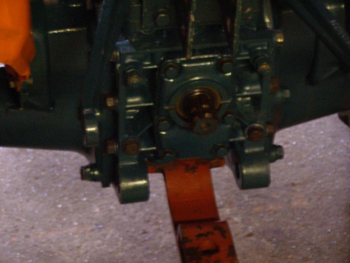

I am looking @ a B6000 which the current owner says has a reverse PTO...he says Hub City used to make a "correcting" gearbox to make the rotation standard. Does anyone know of a source for that device? The B6000 has a K600 backhoe & a factory bucket. I'll need to attach a bush hog, so must have the convertor for this to work for me - anything else I need to be aware of about this particular model?

There is a very easy answer to this, the B6000's have a anticlockwise PTO, and kubota manafactured Implements to suit this format.
other companies also made implements for the B6000 with suitable PTO direction.
Any kubota implements designed for the B6000 inc backhoes, which , have hydraulic a gear pump, the pumpwill be configured to run anticlock wise also, hence the lack need for PTO reverser.
If you wish run any PTO based implement from a b6000 which is standard 540 clockwise rotation you'll need a reverser such as a hub city device.
Have a Read through my previous threads on this same subject, i had a b6000 and have been allthrough the hubcity route etc.
In the end i swapped the whole rear end over on my B6000 ending up with a conventional clockwise 540 PTO shaft and output.

To clarify, all b6000's were designed and manafactured with an anti-clockwise PTO, as were certain Satoh and mitsubishi compacts.
B6000's were manafactured for distrubution for the JDM and European markets, of which both versions also ended up in large quantities in th US and other countries also Australia and New zealand.
labels in Japanese etc are machine that were set for The JDM market, english overseas to european locations etc.
Machines are all pretty well the same spec overall but with differing levels of safety fitmentsdue to market specific requirements. B6000 never complied with US safety standards hence why it was never offiacally offered there.
Some b6000's also had a mid PTO output for a mid mount mower but again specific to market placement ( i had such a version).
Engine rotation or fitment has no connection to the PTO rotation on the B6000, the rear end is the key point that differs.
hope that helps.
