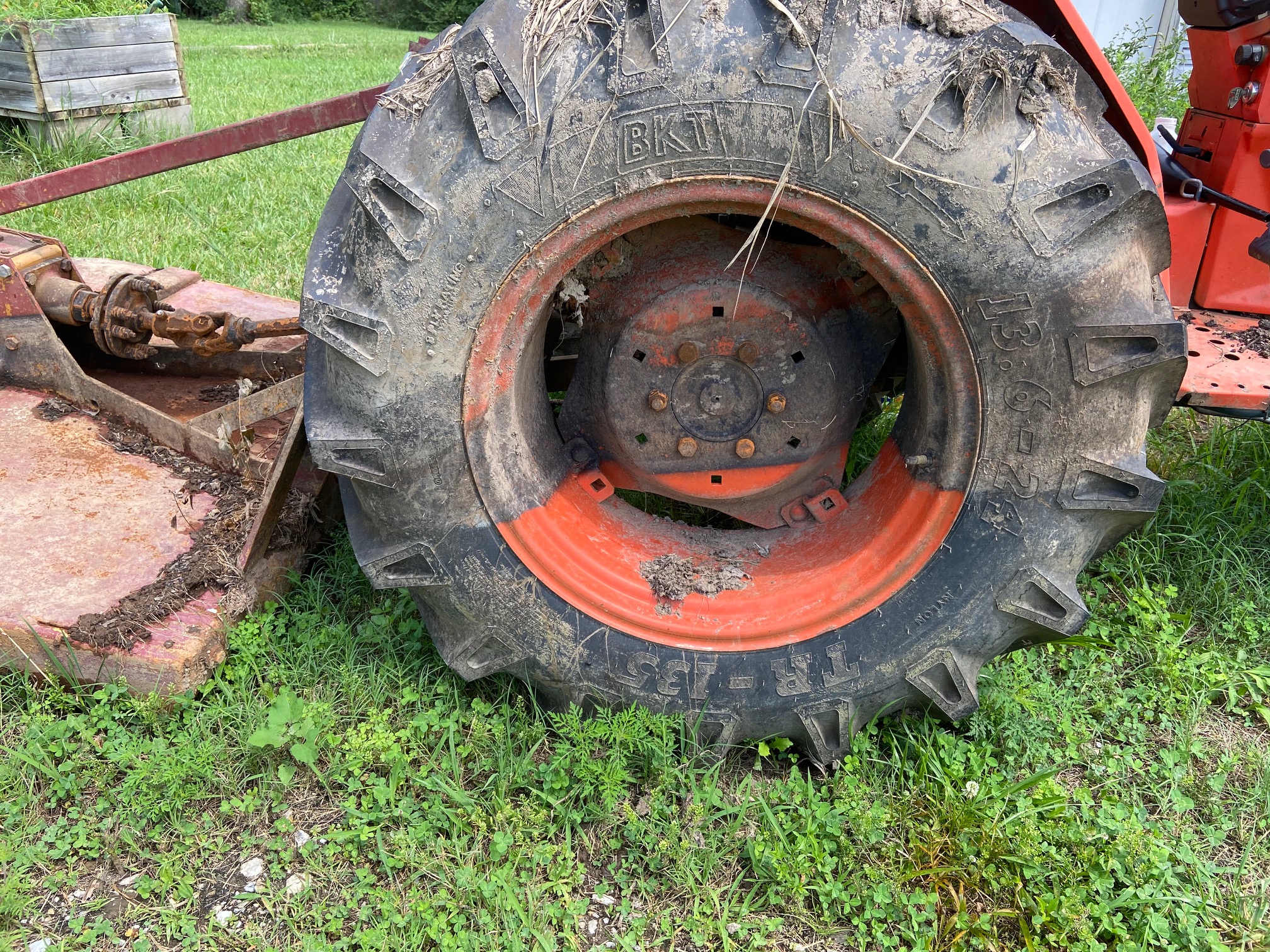

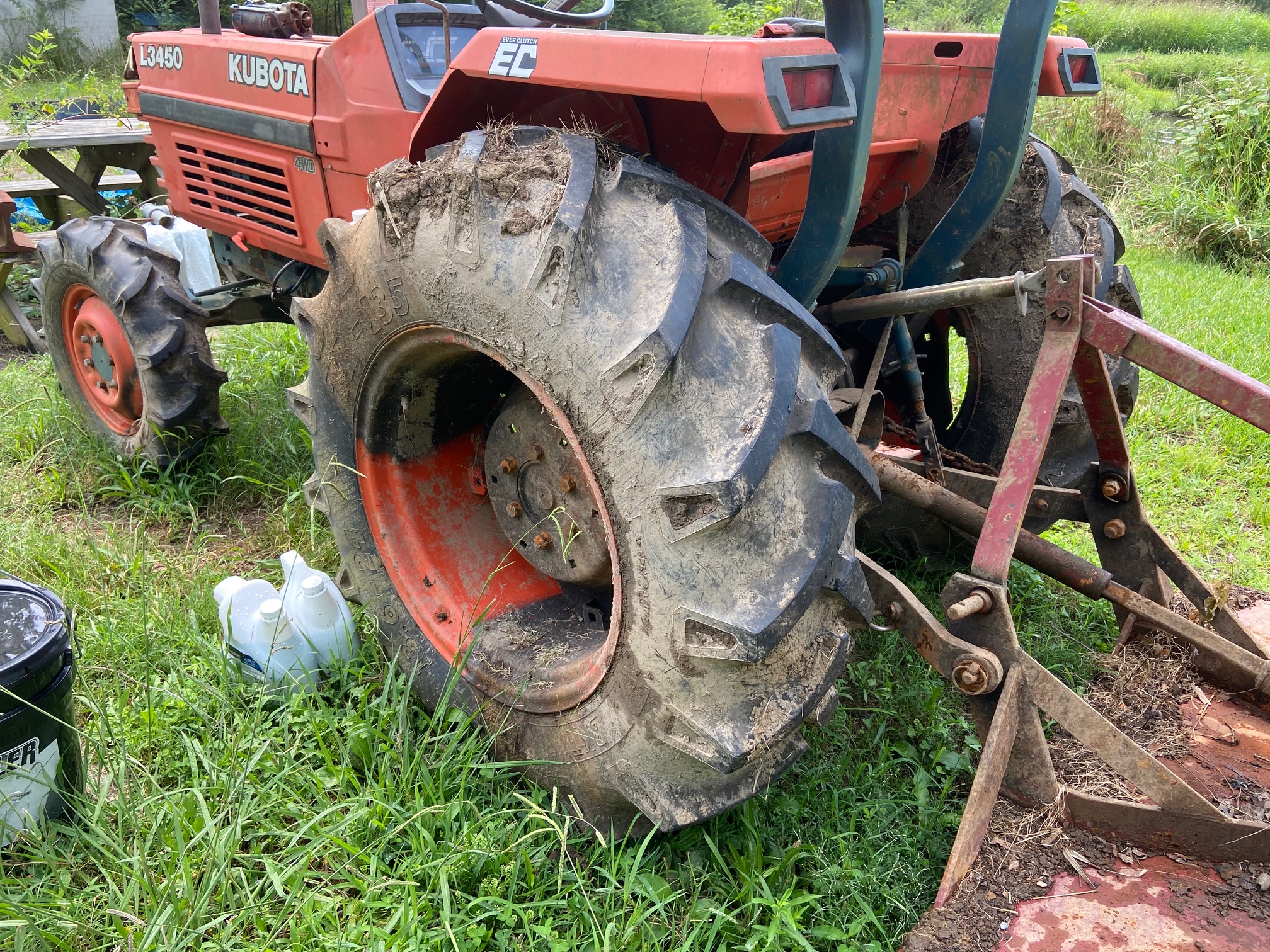

Black 'tide mark' on wheel
Axle was submerged

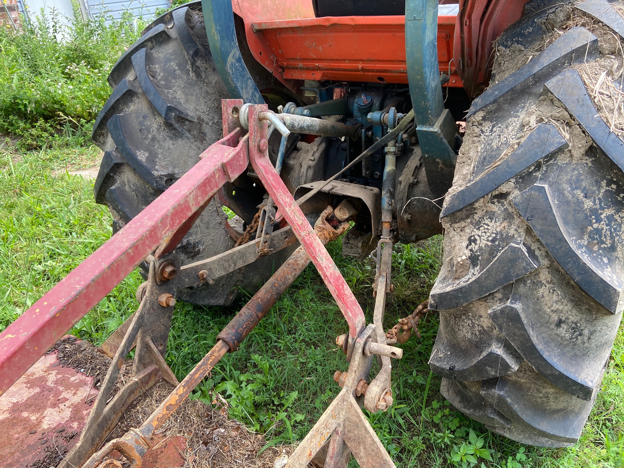

This isn't helping much

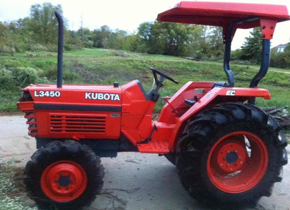

Before pic.
