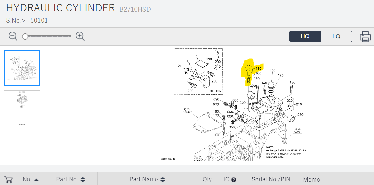

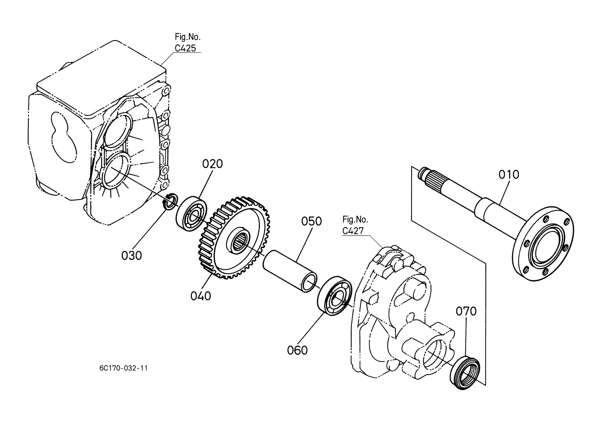

This seems like your unit ,seems like easy repair.Drain some oil , remove the case, remove c-clip,slide stuff off, install new seal, etc.
The OMG for me is the $45 CDN for that seal !!!!! Seems kinda pricey to me,though maybe it's 'special' ?
If there's no oil seeping out, I'd be real tempted to clean yours, add a wipe of Locktite(?) and reinstall.
