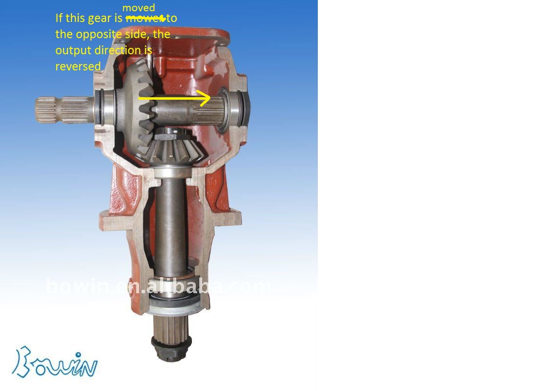

I cannot answer your question but have a caution from researching a mower deck swap for another member.
The direction of rotation of the gear box input shaft needs to be checked.
In the previous case, the two mower's input shafts rotated in opposite directions so the newer deck would not work.
It is possible there are changes that coould be made to the gearbox to reverse the rotation but this was not explored.

Dave, Thanks for mentioning checking the rotation, I will verify that.
