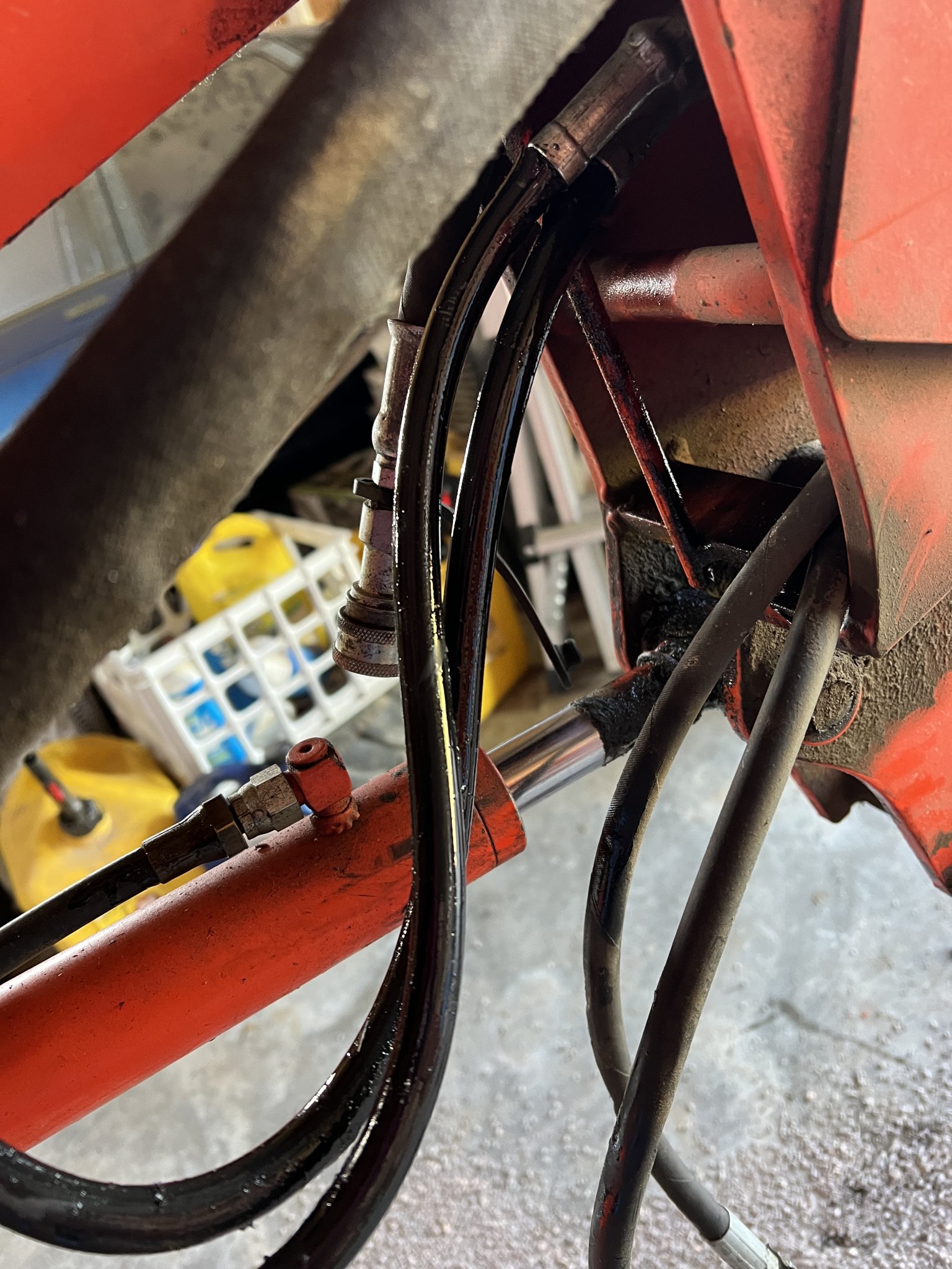

Hi all,
So on of the hoses on my LA211 FEL decided it was dead. I have ordered a replacement and it looks like I should be able to unthread the old hose and thread the new one on.
I inspected the rest of the hoses and they look okay, but I may replace then as preventative maintenance. Last thing I want to have happen is for a hose to blow out in the middle of a project.
Is there anything I should look out for? Should I use any kind of thread sealant, or are they made to seal without it? If I should use sealant what kind is recommended?

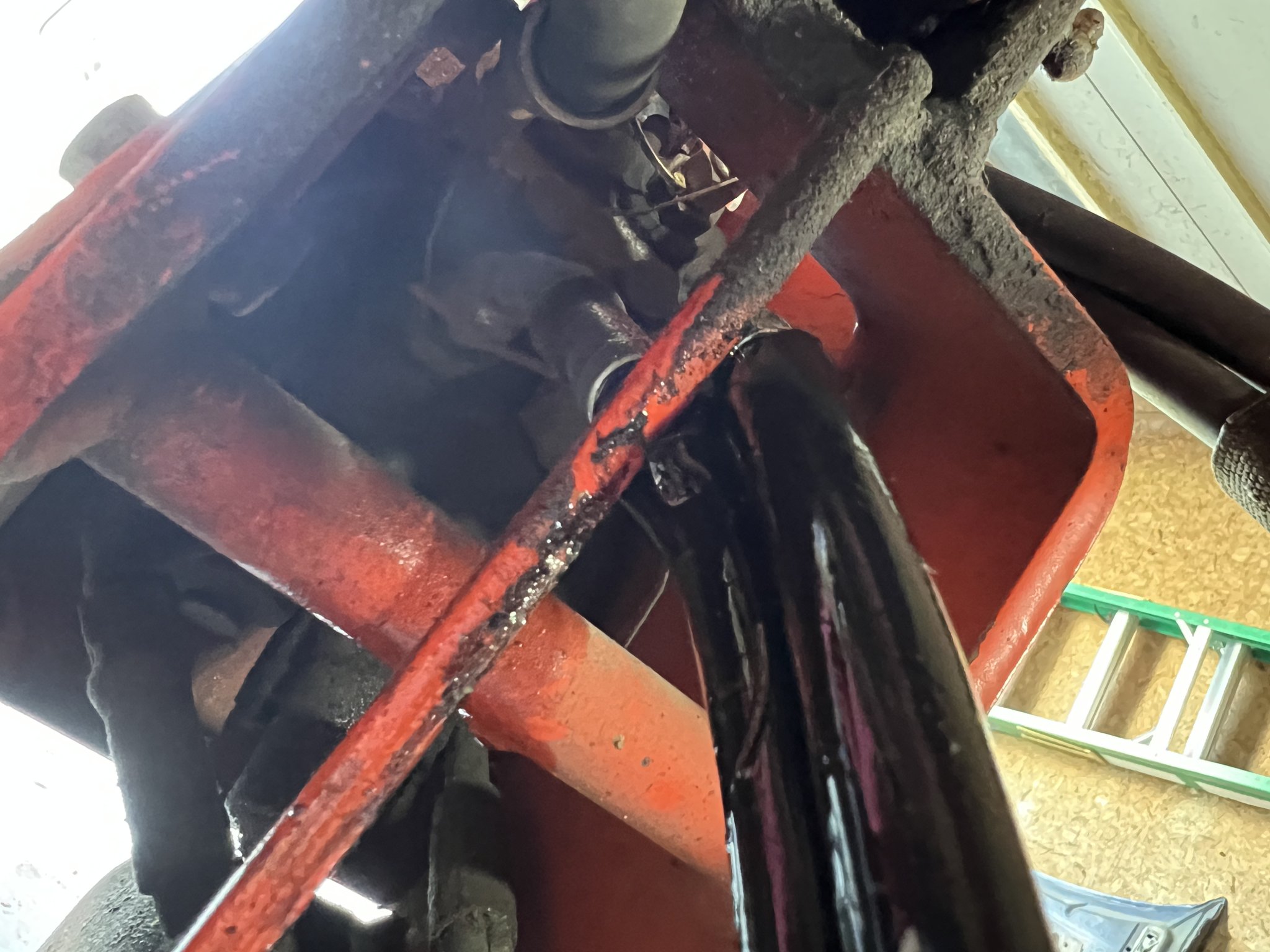

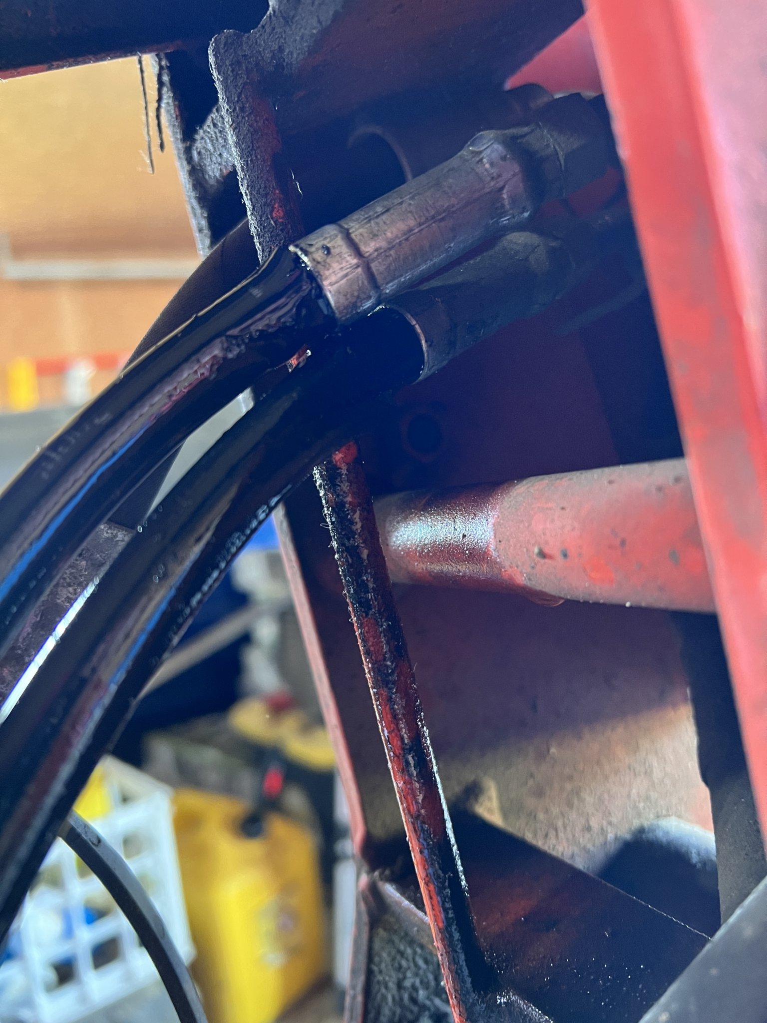

It is one of the bottom hoses on the pic (I am gonna replace both). For some reason they are pressed up against the small vertical bar and that is where they finally wore through. Makes me wonder if they were replaced previously and the person didn't take the time to route them without contact.
Thanks

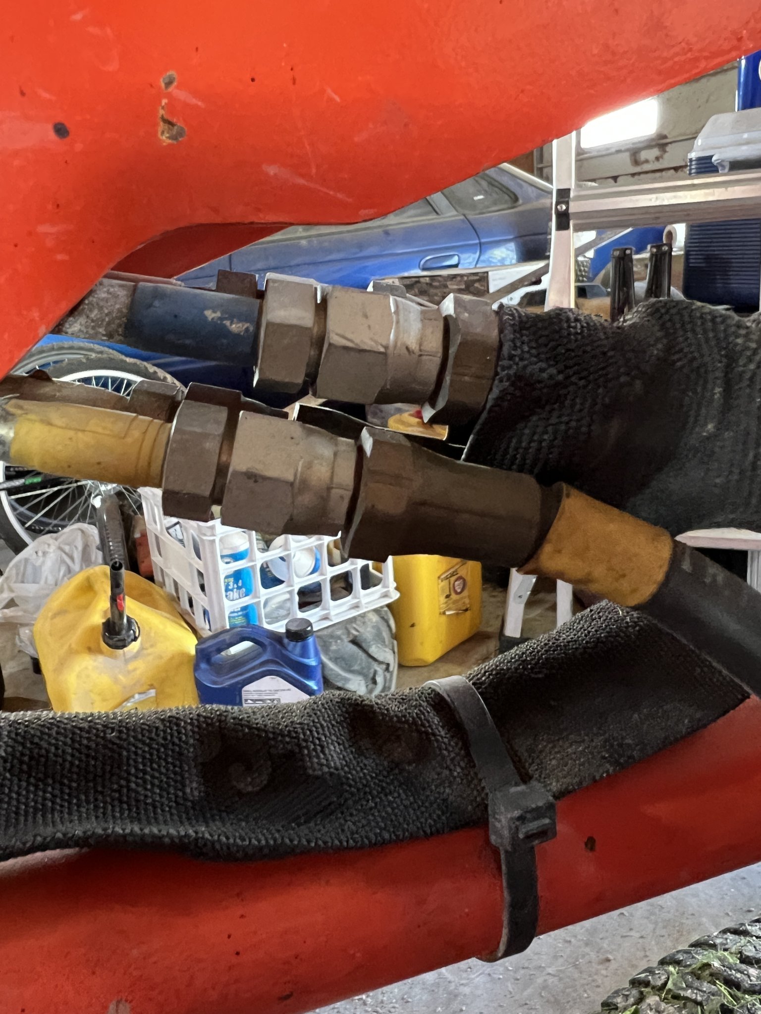

Protect them with sleeves or heavy split loom for wires.

Your hoses appear to have female swivel ends. If so no sealant.

Thanks. It had a sleeve on it, but I cut it off to see where it was leaking. I ordered a new sleeve along with the hoses.
I used the sleeves off my old welding jacket when I installed new hoses for the rear remotes I installed.

Got the hoses yesterday from the dealer and was able to replace them them today. The original part number had been replaced by a newer one. Hoses were the same for the most part. Only 2 differences I noticed was the wrench sizes for the ends were not the same and the new hoses were marked as rated for 6000psi vs the 3000psi on the old ones.
Of course these 2 hoses were the middle connection on the loader valve, so I had to remove it to be able to get a wrench on them. Past that it wasn't that difficult of a job. I was able to rout them and make sure they were not contacting any metal/edges. No leaks that I can see.

You can buy sleeve by the foot on ebay / slip it over the new hoses then conect them
