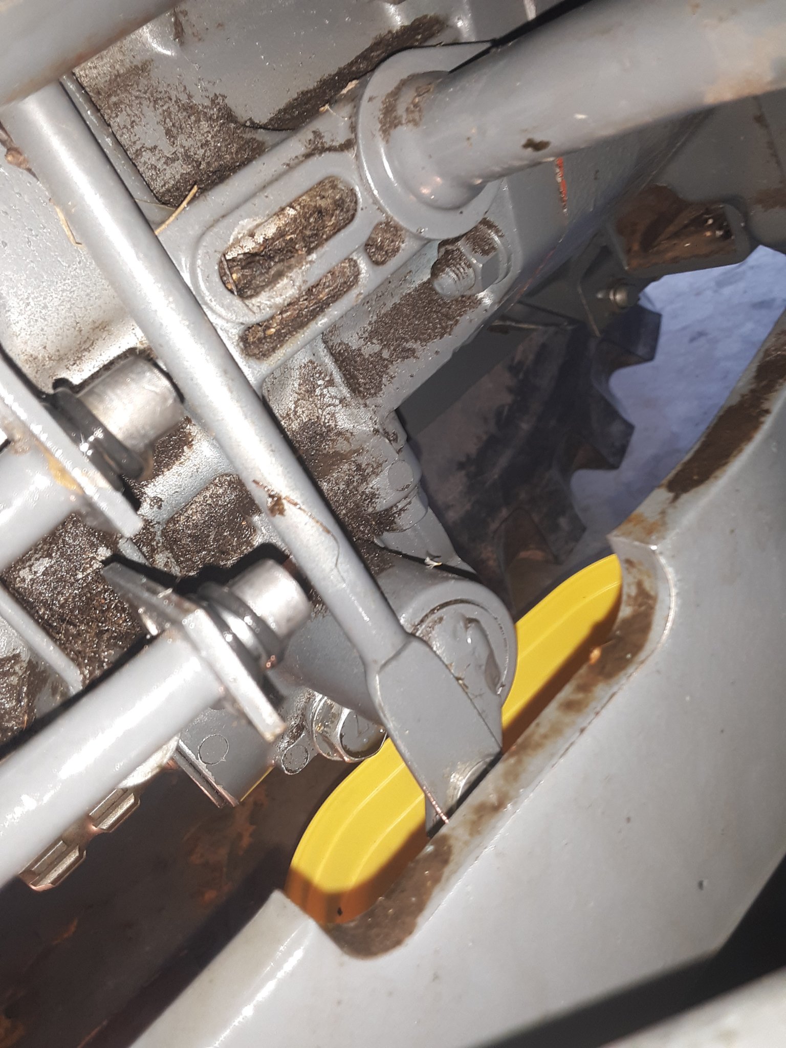

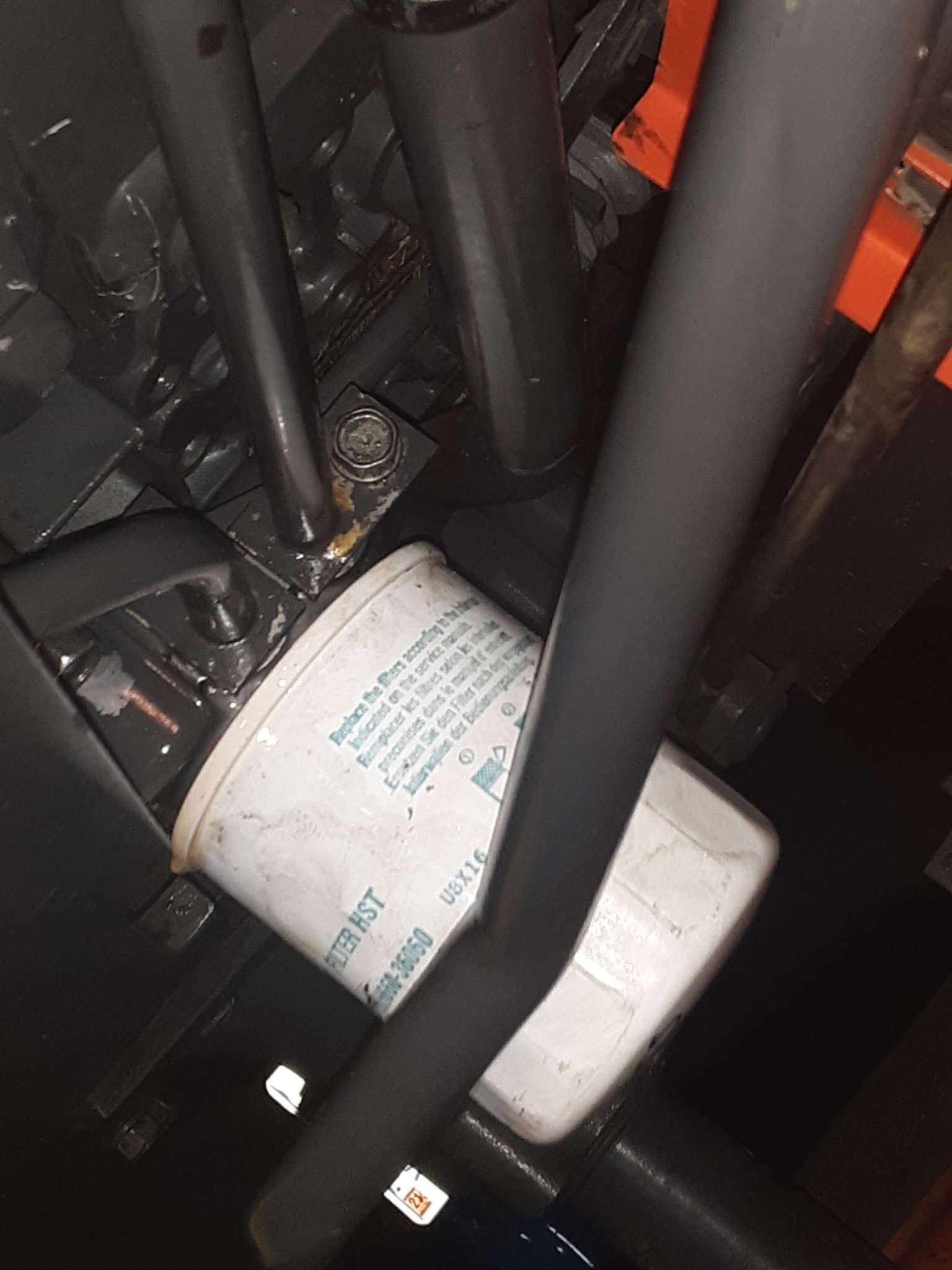

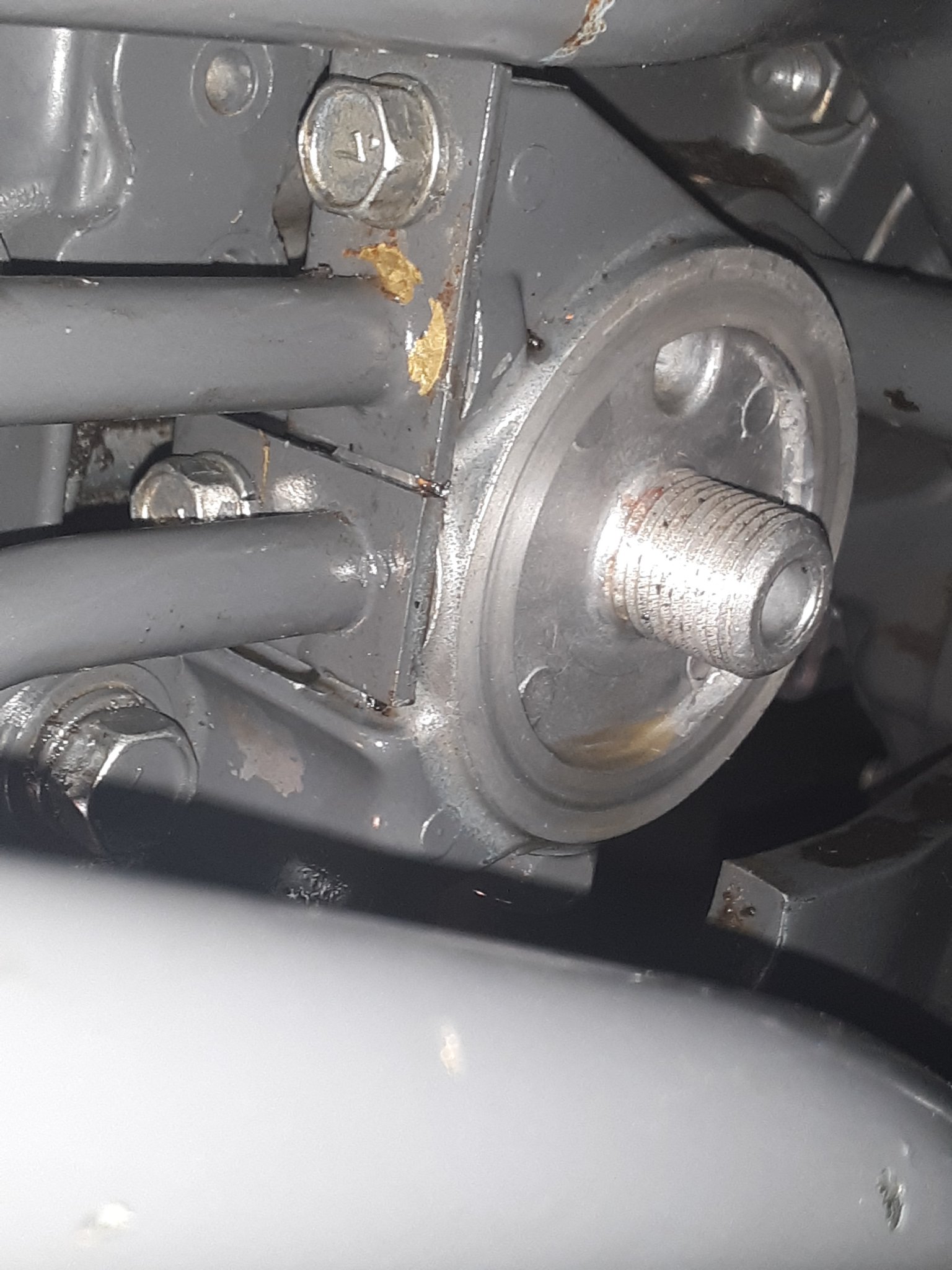

Hey , checking in to see if anybody has experience replacing the hydraulic filter bracket housing. I had a log snap back up from rolling over with my back tire and it busted the hydraulic filter off the thread from the bracket. I have ordered replacement bracket and some seals to replace the ones that I will have to pull the metal hose out of the bracket. Any experience or tips of you have if having done this would be greatly appreciated!

Drain gear oil. Only need to drain the main plug. Pull HYD filter. Remove 2 bolts that attache metal lines. 2 bolts to remove the filter housing. With assembly loose, carefully pull the two metal lines (Oil cooler return and charge pump inlet) from the housing. Get 4 new o-rings from kubota. Put it back together, new filter, fill up and hope there's no leaks.
Your tractor may vary.
