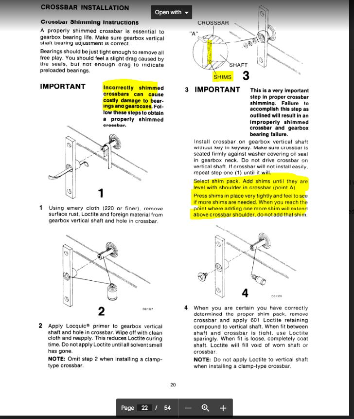

Woods replied with the owners manual ... pretty helpful. Since I'm not in a rush, I may tackle the job myself. Worst case, I could always take the gear box / vertical shaft to a shop if I run into bearing installation issue. The shimming step seems pretty straightforward, the part I'm most concerned about getting right is the vertical 'bearing adjustment' being set with a press.

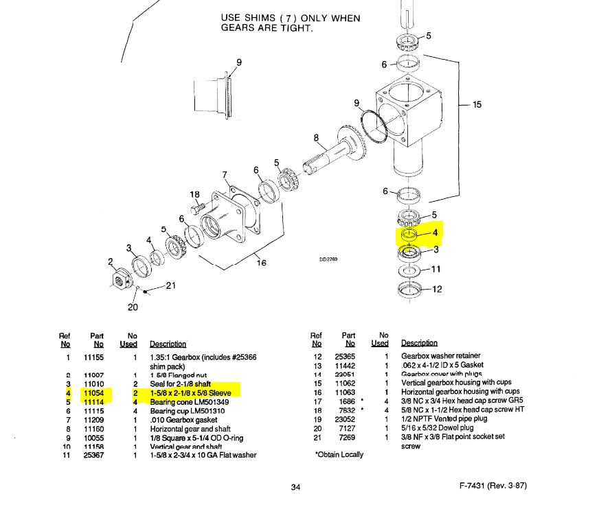

The bar came off much easier than expected. Any suggestions on techniques or maybe links to tool/puller to get this sleeve (#4) up out of the hole and off of the shaft? I'm thinking it would need a tall, slender puller of some type. There seems to be a groove in the sleeve toward the bottom that a puller might be able to get into. I applied Kroil generously to the top of it, so hopefully it's achieved significant penetration.

I have 0% experience with this machine, but would a "gear puller" or a "steering wheel puller" be able to fit and reach?

The directions reference "old school" wheel bearing adjustment technique, but "back in the day" I would spin the rotor whilst tightening the nut at the same time.
It was 1/2 art, and 1/2 science, so I'm left wondering how that would be done if you have to "press" that collar on?
Maybe some sort of "Press and test spin, press and test spin, press and test spin....etc" sort of game?
OR....(it just hit me as I was re-reading it,) maybe there is locktite on it already and a little heat might help to free it up????
Edit: When I was a heavy mechanic doing ring and pinions, there was usually (always) a "turning torque" that you were shooting for. Just for reference it was pretty small if I recall, somewhere around 50 inch pounds or so.
I'd bet this is going to be similar, just a SWAG though.....
