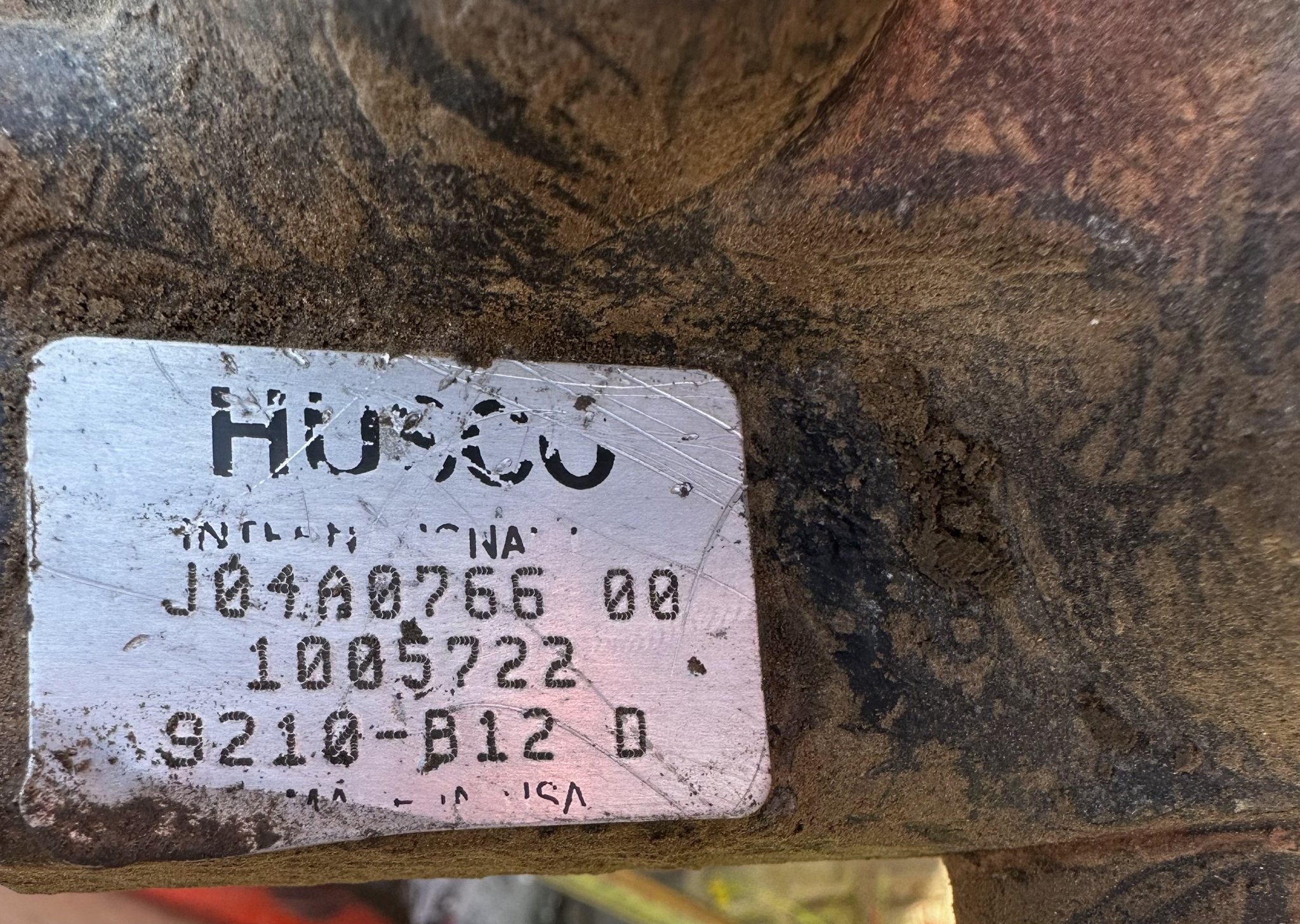

Replacement valve Husco 9210-B12
Hatcher
B7500, L3450
May 8, 2023
7
Dinwiddie, Va
Just replaced a Husco 9210 with a Vevor. Local hydraulic shop didn’t think a Husco was worth their time. You need to know if your valve is open center or closed and if you need a power beyond port. You can find that by going to Husco‘s website. Should give you flow etc to match up a replacement. Might need some new adaptors to fit your existing hoses to the new valve. There seem to be several standard types of fittings.
