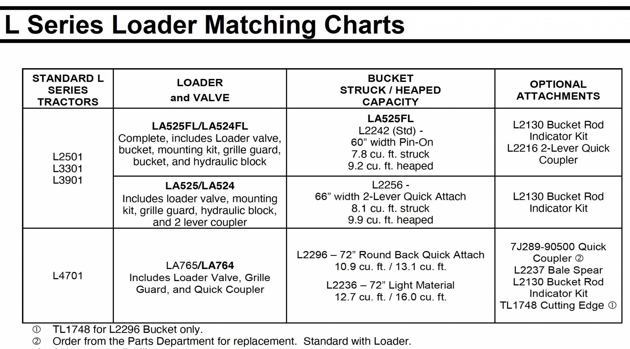

H Huntmastr1 New member Equipment L4701 Apr 5, 2020 2 0 1 Angleton Sep 19, 2020 #1 Does anyone have an idea on available part number or aftermarket option. I am told the one for the LA525 won't work. Thank you, Jeff
wgator Active member Equipment L4701HST, FEL and other stuff. Jul 28, 2018 482 147 43 NC Sep 19, 2020 #2 I think it's part number 7J289-90500 according to the below: Attachments LA765 QA.jpg 328.5 KB Views: 158
