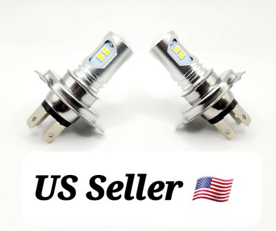

1st google hit...
Now I do NOT recommend ebay...it was just the 1st 'hit'.
Find the light bulb model number and search that + LED. Should get several hits

I used Super Bright Leds, Inc to find the brightest and most power replacements for the old B2410. Finding them was pretty easy. First I determined what kind of bulb socket I had then measured the depth of the lenses housing to see what bulbs it could accommodate. It worked out great.
But, (there is always a but.... ehhh) . I had to switch polarity on headlight lead under the hood as Leds are polar specific and the old standard were not.
