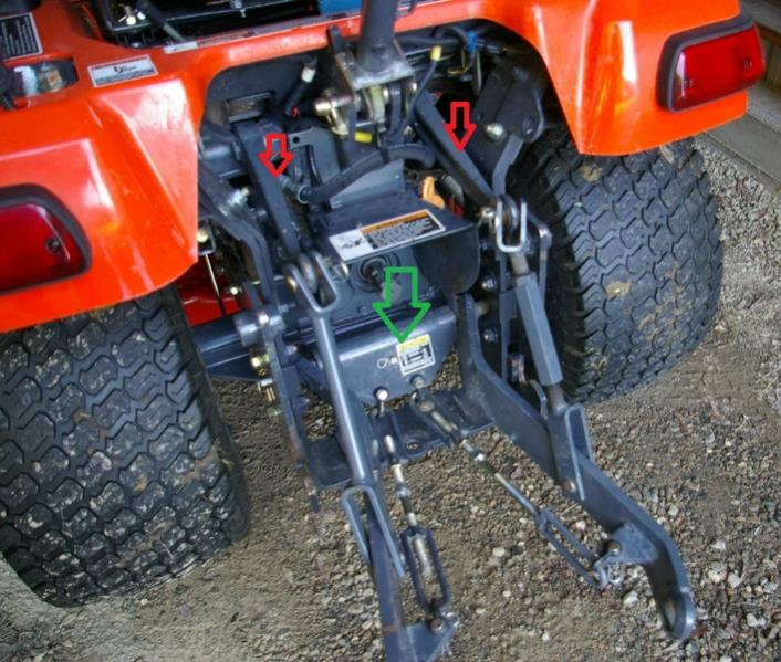

See the green arrow.... this is the plate i`m talking about. If you flip it over, put the holding pin and clip back in to secure the plate to the tractor, you`ll see that the geometry seems to be more in line with the lift arms.
