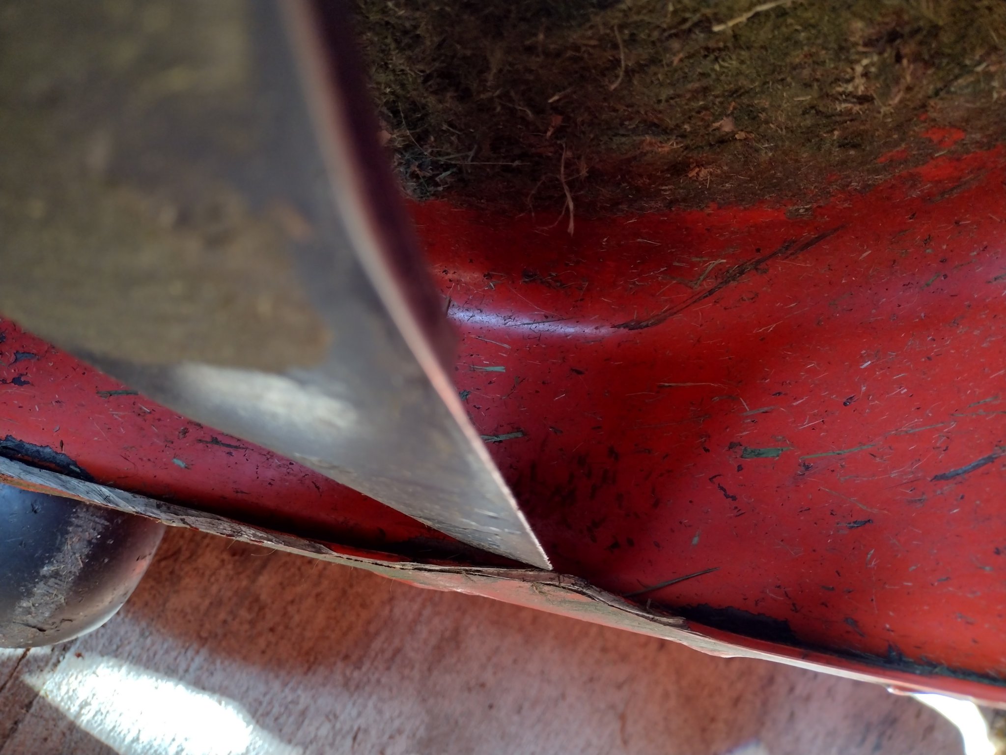

I finally got around to taking the deck off.
I looked into Porta Power jacks, but I couldn't see an obvious way to use one in the limited clearance under the deck, especially given the curve that the walls take towards the top of the deck – but to be clear, I've never used one, so I could be either overlooking some common attachment or strategy.
So far, I'm thinking that I should pick up a 3' pipe wrench and see whether I can get it to budge. I'm still not sure how I'm going to orient or support it in the process. I'm thinking about maybe flipping the whole thing upside down.
Here's what I'm dealing with:

I had a bend much like that. My biggest crescent spanner took it out just fine. You don't have to squeeze, so it's easier to put good leverage on it. I'd try that before anything else, because you'll have a big crescent if you sharpen your own blades. If you don't.....get one, so you can sharpen your own blades.

picture is great !...
aw, this is easy... that's the lip of the side...
get a pair of vicegrips , that still have good 'teeth', clamp on tight, at the 'mountain peak', facing down and pull 'towards the ground'...
Depending on how young and strong you are, will take 1-3 pulls. fisrt is the mtn top, then 1/2 way down the mtn on both sides.....
vicegrips are best as they are SECURELY attached to the lip,then pipe wrench then channellocks,last adjustable wrench. When pulling it out just be careful and plan ahead if (when ?) the tool lets loose that you don't whack yourself and then need 15 bandaids to fix YOUR booboo....
wish my 'bent metal deck' projects were that easy......

FWIW, before heading out to buy that pipe wrench, I ended up finding an old crescent wrench with a handle long enough to bend things back into shape. It wasn't easy, but it worked better than I thought it would.
