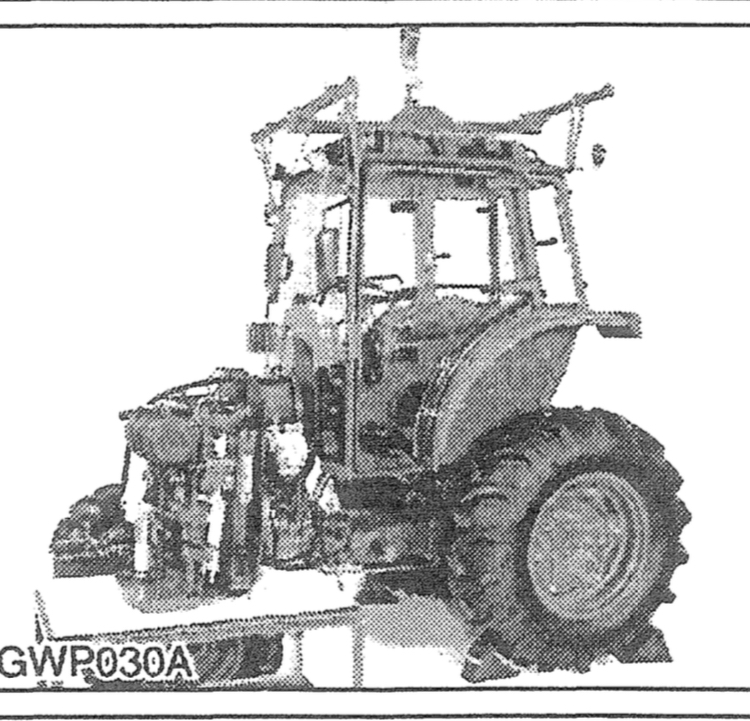

If you look at pages 2-S11 to 2-S20 in the WSM, it tell you every detail you need to know to split it, and has pictures of the cab being lifted with straps.

It looks like a frame is used to support 4 lifting straps? Has anyone here done this , and could comment if its a neccesity to weld up a frame, or can 4 longer equal length straps be used from one ring?
