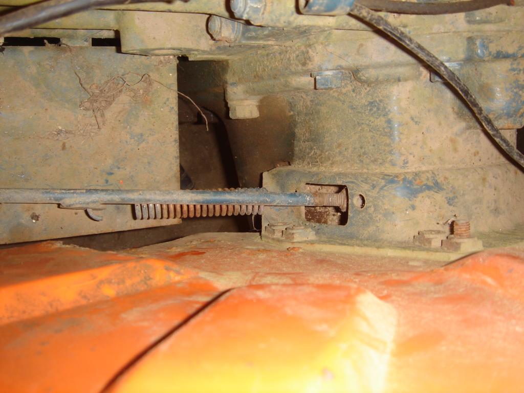

The rod that links from the brake pedal to the rear brakes on my B7000 is busted, so my brakes only work on the right-hand side. I'm finally getting around to repairing/replacing it but the darn think is so difficult to remove.
Where it connects at the rear there is also a spring holding it (I suppose which is what keeps the brake pedal off the floor). Does anyone have any tips for how to stretch this spring out so I can unhook it? It's either too cramped for me to get a good hold on it, or I'm just not mechanically inclined enough to figure it out.
Any help would be appreciated!

Needle nose visegrips usually work for grabbing the end of a spring and pulling.

I use a length of wire looped over the end of the spring - usually a piece of household electrical wire which is strong and flexible. It gives you much more control when room is tight.
If you can't get a straight pull grab a flat blade screwdriver and bend the wire over the end.

Take the fender off, clevis pin, will be obvious once fender is removed.
AGREED 110%. Life is so much easier if you take the fenders off. The spring is in place to return the break pedal back up after you push it down to apply.

You can bend the end of a rat tail file into a hook and pull it free with that.
