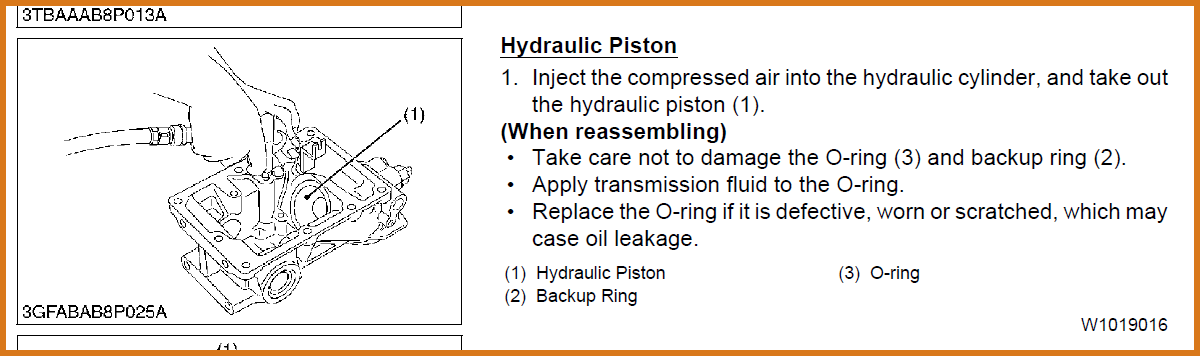

That would certainly be cleaner. And when I get the system drained I'll try it. A friend had suggested air and my thoughts were that if fluid leaked past the piston easily enough to relieve the pressure air will be less likely to pressurize the cylinder. Here's hoping that it doesn't. Thanks for the suggestion.
9,911
5,244
Shop air will pop it right out.
33,463
8,743
Ok guys someone explain to me how in imaginarium land is he going to put air to it to pop it out?
And If anyone suggests pressurizing the whole sump I will throw them off the forum!
33,463
8,743

WSM for the B7510 is a little light on detail. I've no idea of the similarity to the B6200.
33,463
8,743
He said without removing the case. ;)
I'll give you a pass on the air comment also, as yes when you have a sealed top cylinder like a b7510, that is how you would have to get it out.
No the B6200 does not have a port inside like that.
It's on the outside.
The piston on a B6200 does not come out on the inside it comes out the outside.
It has a cover over the piston that you remove.
9,911
5,244
Good point. What was I (not) thinking :mad:

Abuse and anecdotes aside, Wolfman's technique of using the hitch arms to push the piston up was the ticket. Cylinder bore was smooth and no ridge to cut down. Pushed piston down and up a few. times after which dropping the arms quickly created enough momentum for the piston top to stop just clear of the cylinder. Now with something to hold onto a little pulling and twisting got it out. No file cabinets (or humans) were injured in the process.
Thanks everyone for the advice and entertainment.
