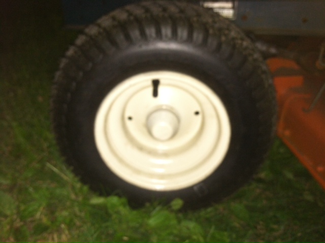

Hi under the grease cap there's a cotter pin through a castle nut.
If you removed both of those the wheel should slide right off the axle.
Try rotating the wheel while pulling.
I got my G6200 front tires for 30.00 each from my Kubota dealer.
Attached pic
