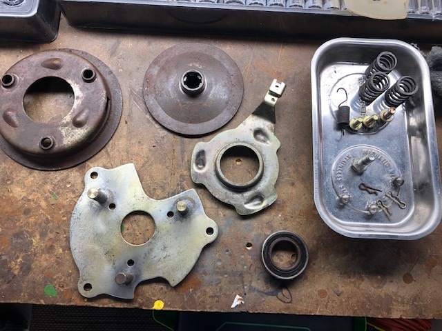

Well.....started it up and within about 3 minutes it sounded like a high frequency acoustic weapon had been turned on. I believe the top bearing of the BBC was shot. Took about 2 hours, a lot of PB Blaster, and the use of every puller I had to get the BBC off and broken down. I've got a new bearing coming via ebay.

I got the bearings replaced. In case someone else needs to know...
1. bearing for drive disc is 65601-3526-1, a Koyo 6006RD and cross references to a 6006 2RS, also a Timken 9106PP
2. bearing for the blade holder is 65601-3525-0, a Koyo 6303 2RS, and cross references to a Timken 9103PP
3. Wheel bearings are 08141-06002, a Koyo 6002 2RS, but cross references to a Timken 9102PP

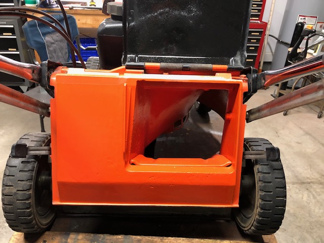

I broke out the Honda discharge chute and the Honda grass catcher. Not perfect fits, but they work. The grass catcher, you can't fill to the max, but maybe halfway then you have to empty it.

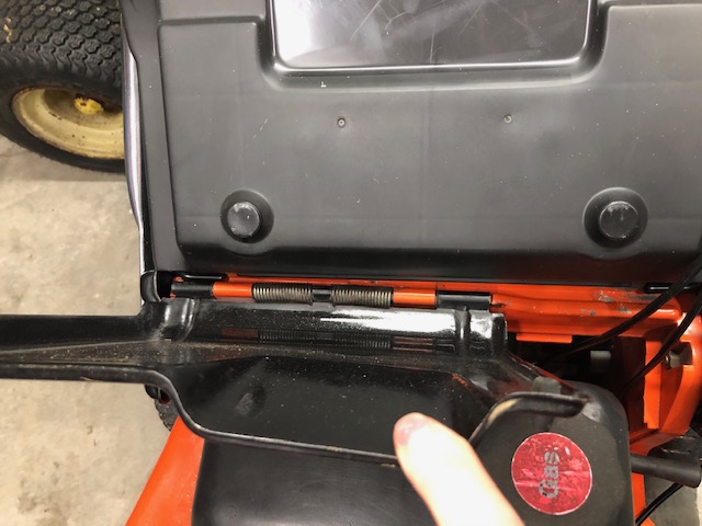

Hi, looks a great job. You may be able to help me out. I have one of these but the blade brake cable was missing. I sourced one, but cannot figure out where the cable is clamped beneath the dip stick. If you have a pic that would help a lot.
