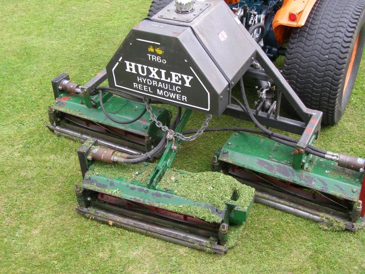

I may be of some use to you.
I have a huxley TR66(also known as a sisis tr66)reel mower with 3 cutter heads which is a just under 6ft wide which i use on the back of my little old B6000, it works great, i also use it on my B7100, which, with the few extra ponies work even better.
It runs from its own hydraulics with a pto gear pump.
They made several vesrions in 3/5/7 cutting cylinder options, i found the 66 best for me, a 5 would work fine also on my 7100 but the width becomes an issue around our garden.
From my user manual it is recommeded for quite a lot of the compact tractors.
On the positive side, it is quick to fit & remove and by using its own hydraulics its not putting excessive load on the tractor pump.
It cuts very well and leaves an exceptional finish, a far superior finish to that of other mowing types.
Ideal for large grass areas that you want to keep short and nice.
Some have a control spool which let you rotate the cylinders anticlock-wise etc to assist clearing/unblocking the cylinder, mine does.
On the negative side, they do require yearly maintaince of the blades/cylinders etc, which may be more costly than other types, but its all down to your preference on lawn finish.
If you treat it nicely and avoid eating stones and other non grass materials with it, you could, go 2 or maybe 3 seasons without major servicing, just adjusting the bottom blade regulary and keeping everything else nice and greesed/oiled and tightened up. You dont want nuts and bolts falling off let alone into the path of the blades...
you will soon see when its not cutting properly.
Also limited ability in the wet as you get more clogging etc and grass cuttings dispersal is reduced.
other than that they are an excellent tool, i would'nt be withoutmine now.
I did put some pics up a while ago, search my username or under gang mower and you should see it.
I would not be temped to go to wide, just keep things balanced with your tractor, you may find a little smaller is far easier to work with.
I am currently looking for a second unit for my 7100 still a 3 head machine but a bit wider , prob a 7ft reel mower also self contained hydraulics, ransomes do a good range and they are well suited to most kubota compacts.
hope that is of some help.
rob
